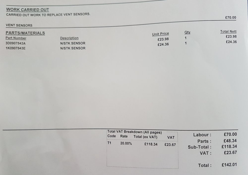

Update in case anybody reading this experienced similar. Took it back to my SKODA Indy and he tells me a flap sensor has gone. Ordered and the repair happening next Wednesday. Fingers crossed.
Final update on this as I'm sure more people will be after the info. 3 hours later and the new passenger side temp sensors have been replaced (footwell and dash).
Part numbers and costs for labour at my indy specialist, below.  Apparently it's a glovebox out job so nothing too severe.
Success and passenger side warmth attained!
