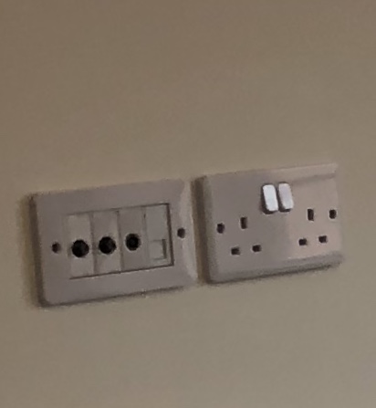

These is whats fitted in every room, sorry not a good picture as it's cropped from a larger picture but it gives you an idea

So that's behind where you'd wall mount a TV? If so, it looks like it's designed for smart TV's with either freesat or freeview builtin as that's about every connection they could need. If that's all you wanted then there would be no cables on show.
However, it doesn't appear the developers haven't put much thought into people using gaming consoles, blueray players or any other STB like Sky. You could have asked them run a HDMI connection from that set of sockets to somewhere to put any other AV equipment. What sort of height are the sockets at? Seems odd to assume everyone would want wall mounted TV's in the same places...
Given what you've shown, you could leave the main Sky Q box somewhere out of the way with a sat connection (two left most connections) and only use Sky Q mini boxes in each room?

Thanks for that, makes a bit more sense now, we are not into consoles or blue rays to be honest, I'm/we are just after Sky in 2 rooms down stairs and the master bed room so it looks like it  can be done.  Need the Internet as well so hopefully we can get all that without to too much of a  problem. The low down plug sockets are about 6 inches above the skirting boards. If the 2 left connections are for sky what are the other 2 for ?. Also we have a EE WiFi bosater box at our present address as the phone signal in not very good, can that be added into the system in our new property if needed ?

From that photo it looks like the non power sockets are: 2 sattelite plugs (so sky may be built into the estate), a general tv aerial plug and a connector for broadband, with the master plug elsewhere that would need a lead to plug between that line and the router.

 Can you tell me please " Why does there need to be 2 Sky plugs fitted at one location. "

Basically, there are 2 plugs to allow Sky to show one channel while recording another.
Or record two channels while watching a previous recording.
As ROO says -
The single aerial plug is for the likes of Freeview /rectangular one is for data. Cat5/6 are both data. It's to the layman ( and me) just a protocol as in some rail lines are speed rated at 70, others are 125, so are data cables. 2 LNB are needed to record AND WATCH SEPARATE SKY channels. It's like on track- you need a UP FAST AND AN UP SLOW to run both fast passenger and slow freight in the same direction at the same time. LNB receive signals at satellite frequencies and convert it to a frequency the satellite box ( and the down lead cable ) can handle. Hope that sheds a bit of light.
