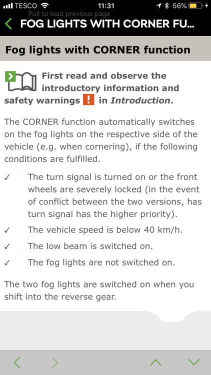

@wg100 cheeky ask but do you have or can point me towards the coding to activate the ‘menu option’ for dynamic cornering lights please.
Also will the cornering lights work in Auto mode or just with dipped selected. Manual suggests dipped only. I also thought they came on during the daytime when the steering wheel was turned or the directional indicators were turned on but the manual would seem to state otherwise. See attached...
Can anyone advise on this please.
Cheers guys.
To be honest, I only notice the cornering function at night when the dipped headlights are on anyway. I always leave the light switch in Auto.
