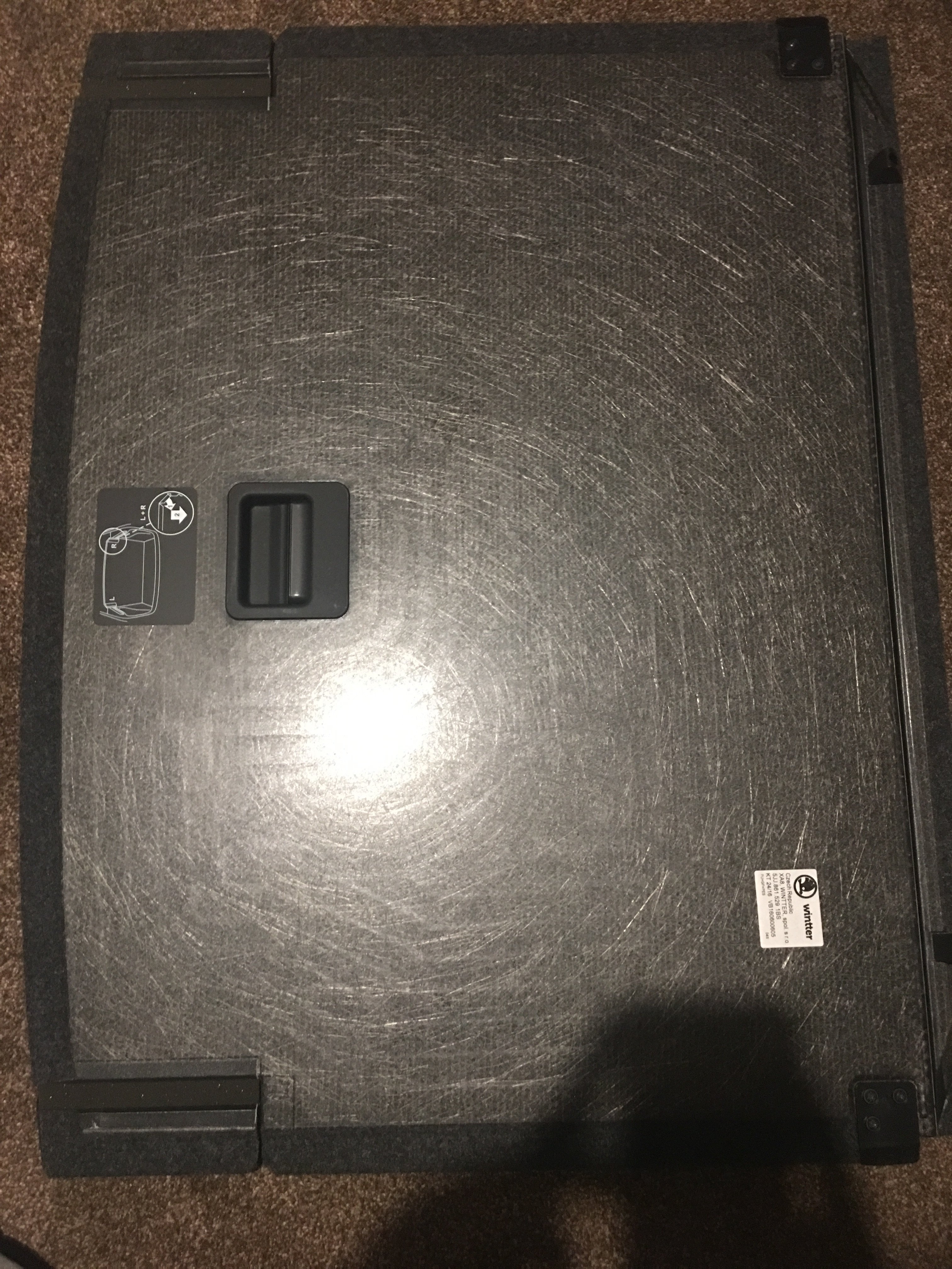

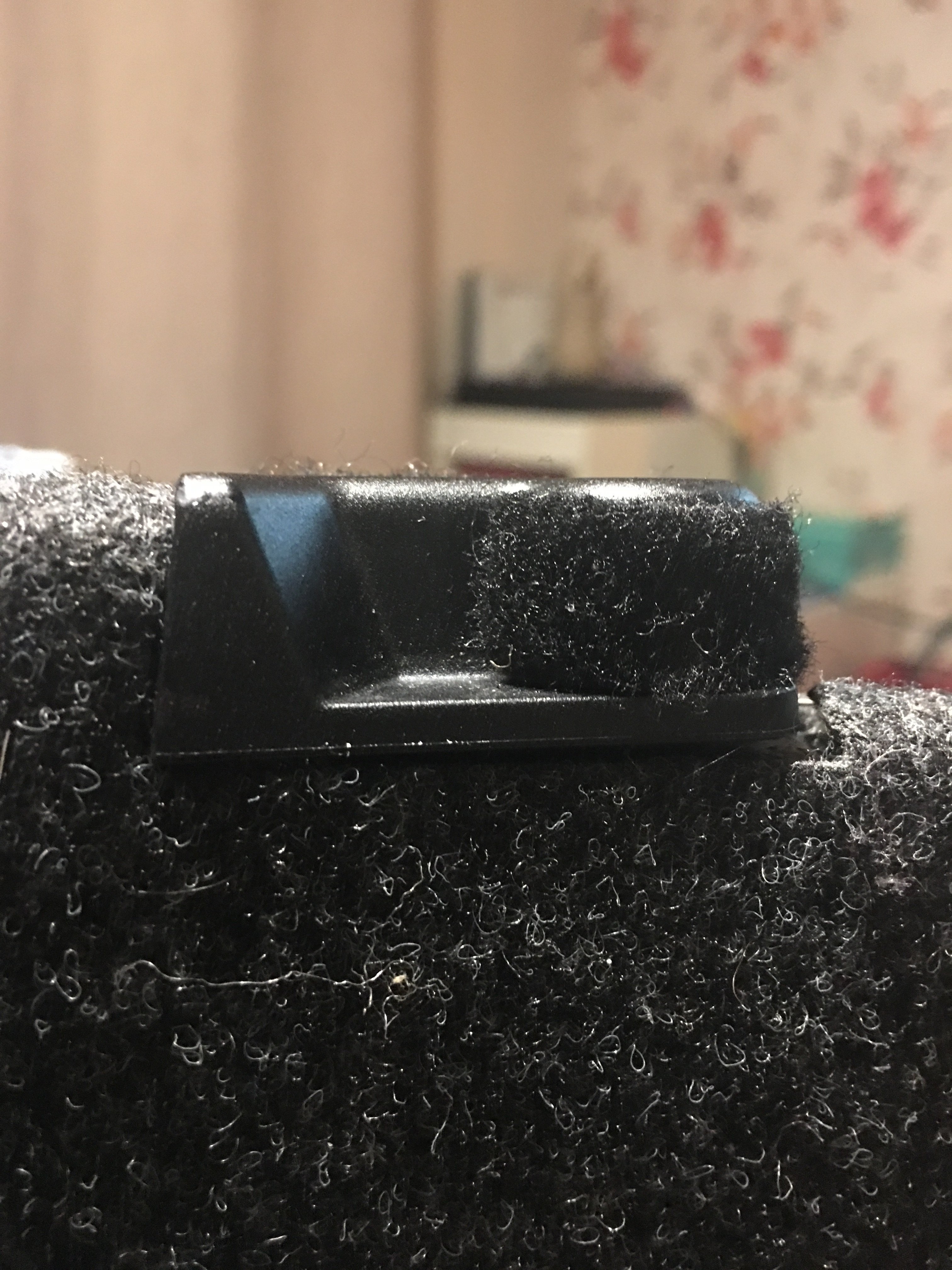

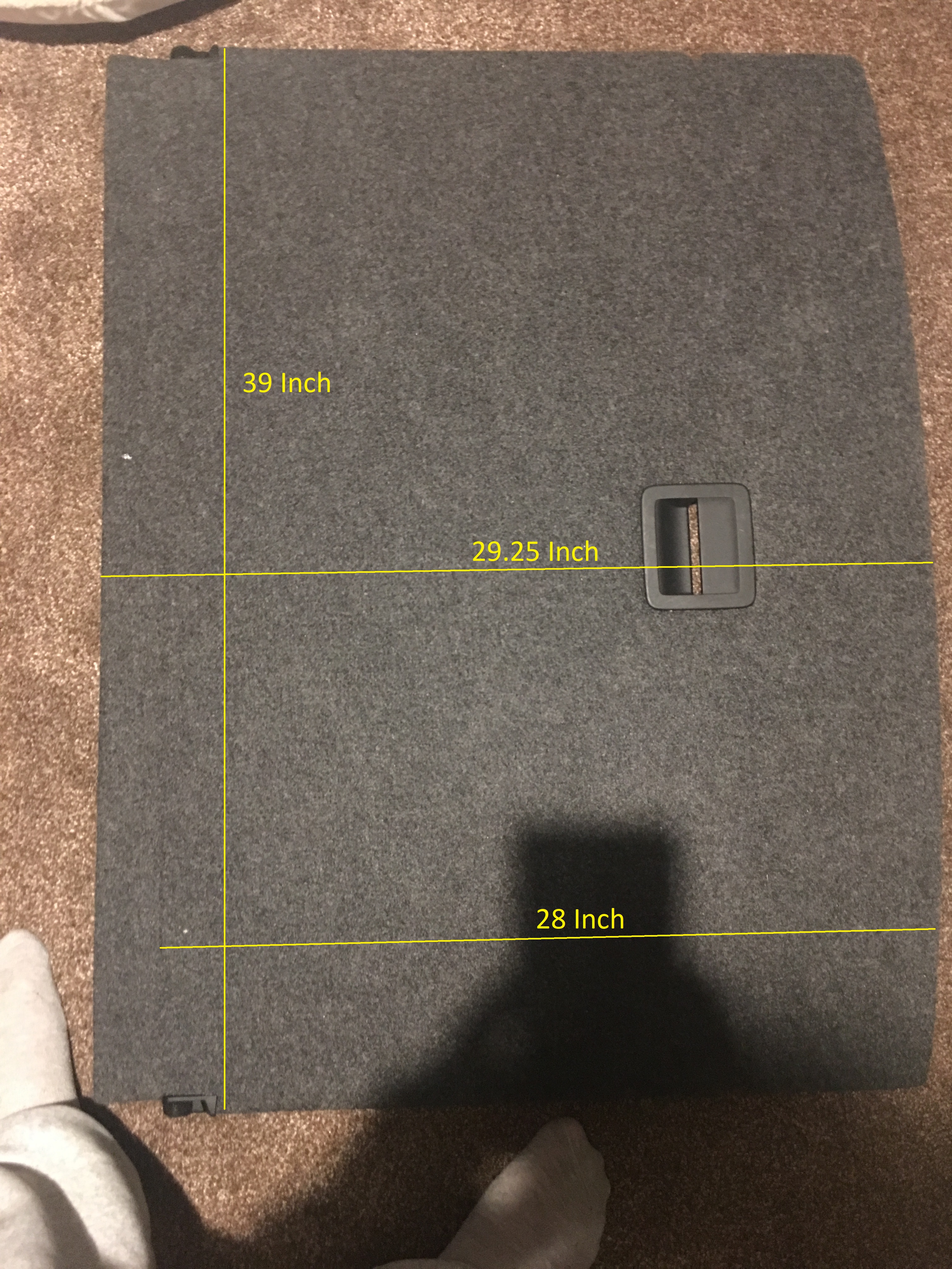

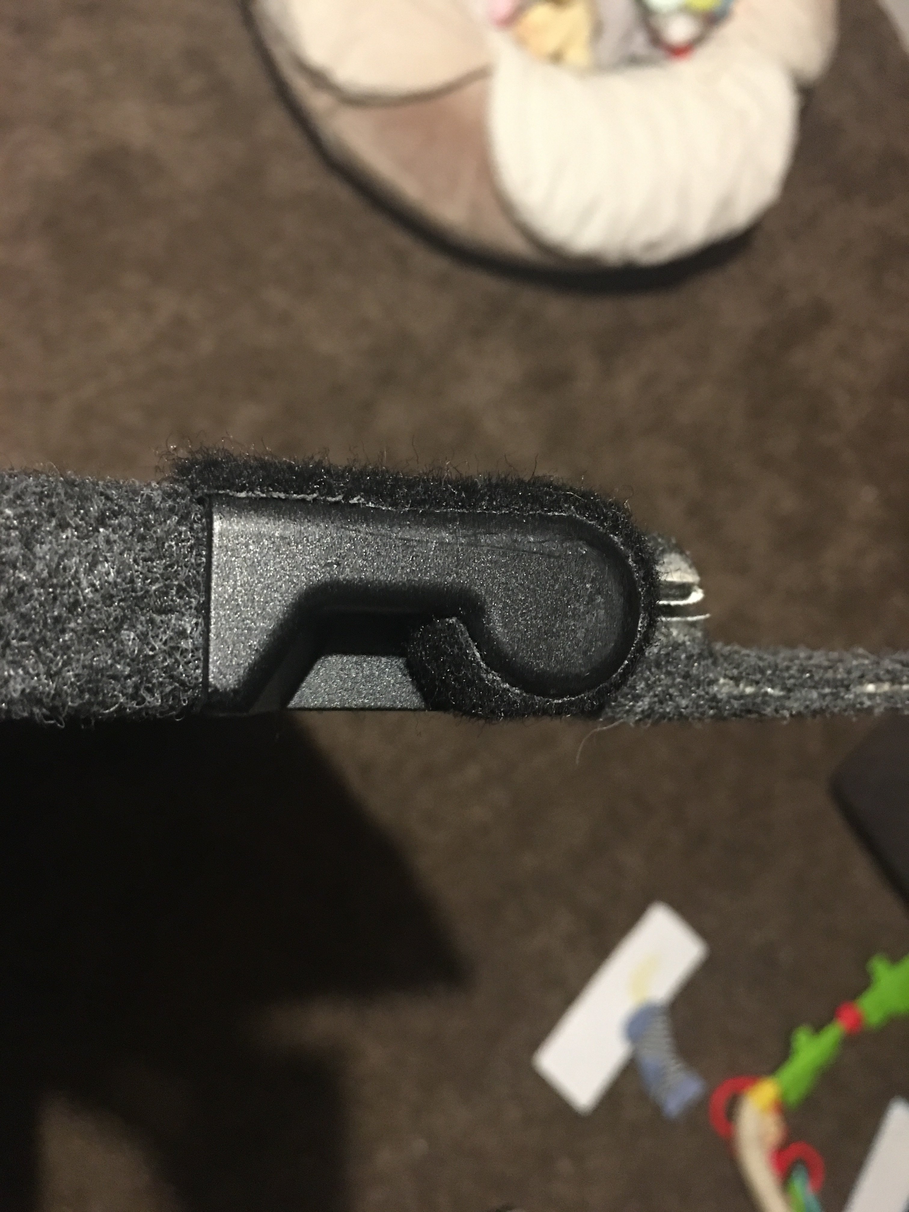

Hi Kingy,
Ive taken some rough measurements of the boot floor and some pictures of what i thought might help.
Hope this helps :)
That’s so helpful, thanks a lot!
Its roughly what I thought it would be but it’s good to know I was on the right lines!
I’m hoping to have a go this weekend so I’ll post pictures of progress if and when I do.
thanks again!

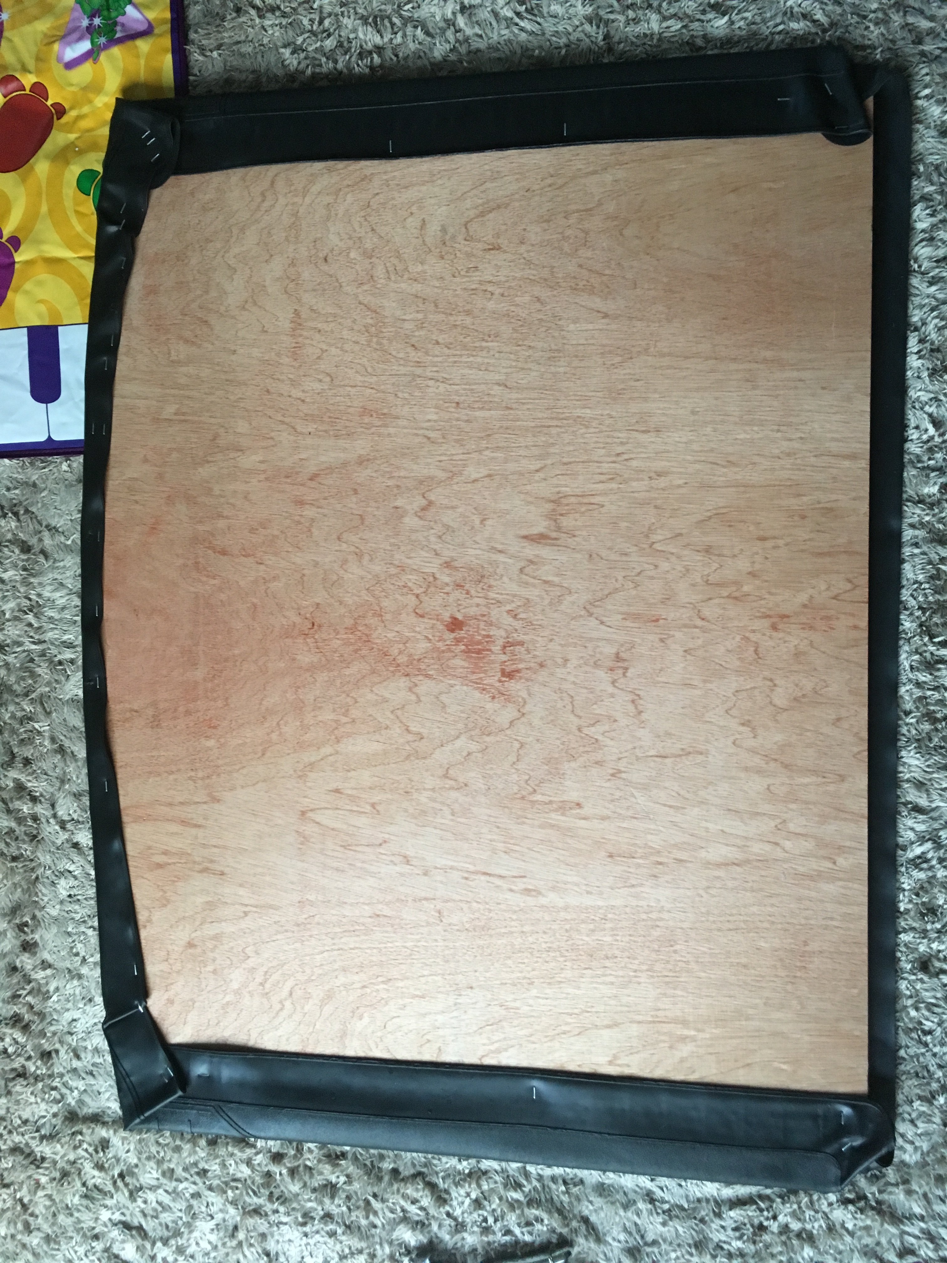

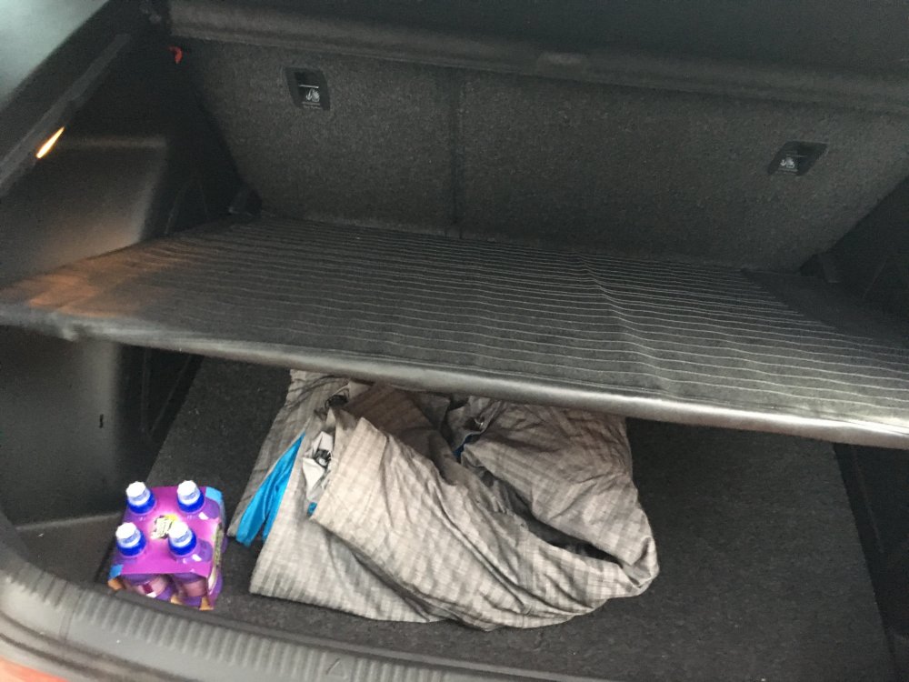

So I had a go! Thanks for the measurements they were very helpful!
i used 18mm ply and used the boot carpet for the curve although i had to make a cardboard template because it is sewn into the car.
im not happy with the curve cut because I did it with a hand saw (no power tools) but with the rubber on it’s a nice fit and it works.
id still like a genuine one but not bad for £6.85!
id like to cut a handle in it but that’s for another day now!

i have 2 jobs and Uni and a child so lots of stuff in and out of the car and needed for different things. I have a base level of stuff always in the boot (first aid kit, coat, few tools, ratchet straps bungee cords, work files etc.) so all this is going under the false floor so I’ve got a clear boot for other things like taking the dog out, sons bike etc. Plus it looks tidier with all that not on show haha
