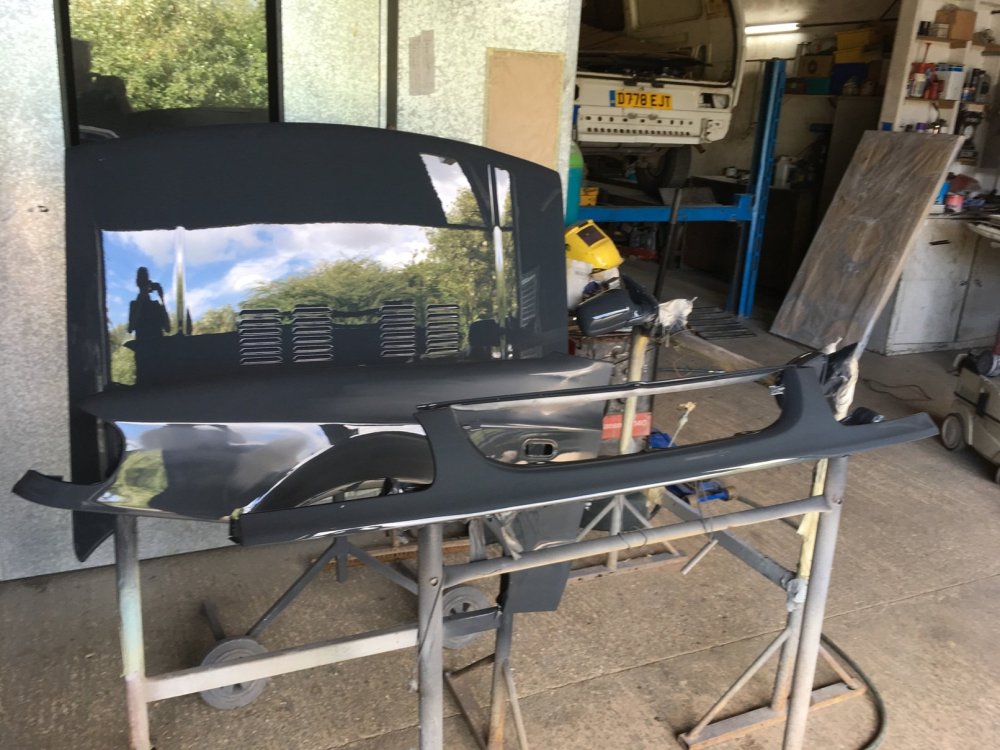

  • Real progress   Once back together, it was treated to a liberal coating of stonechip

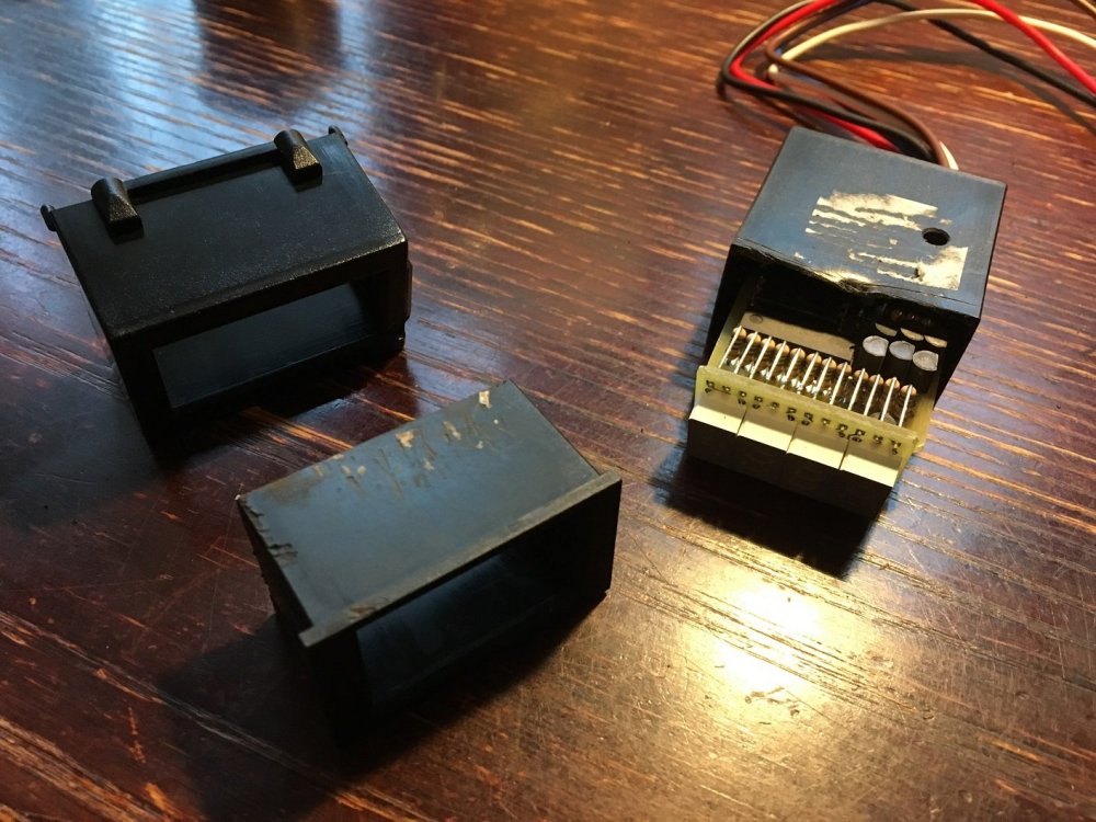

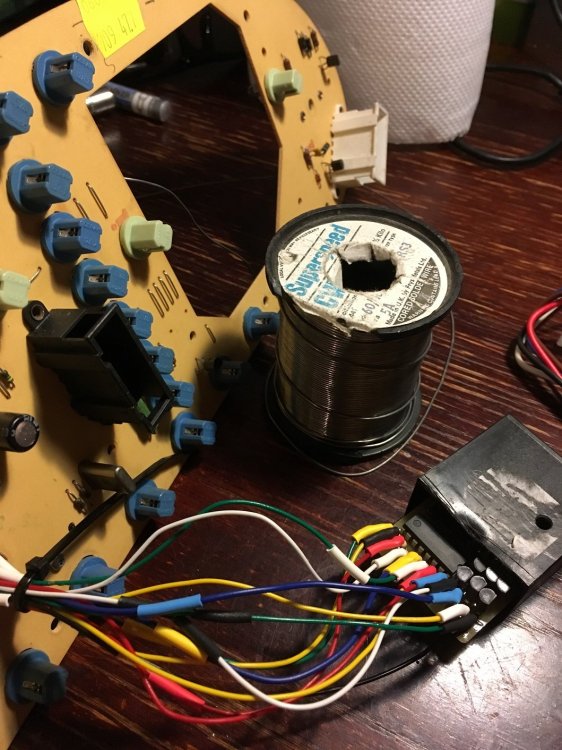

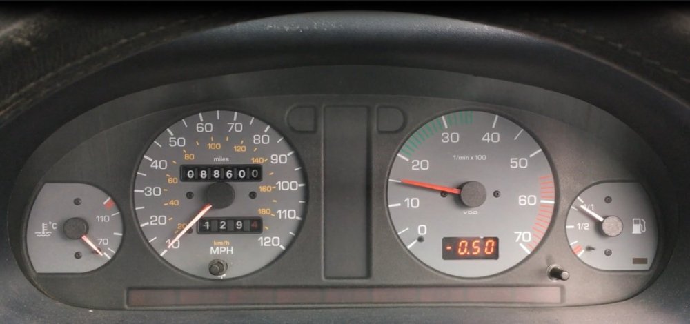

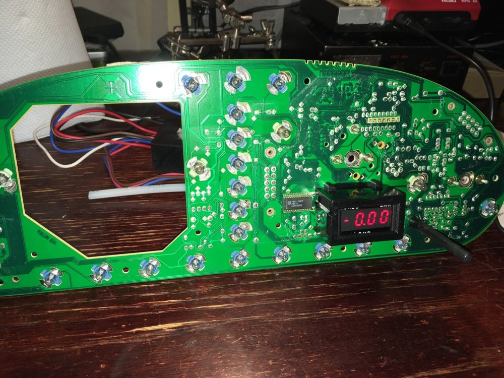

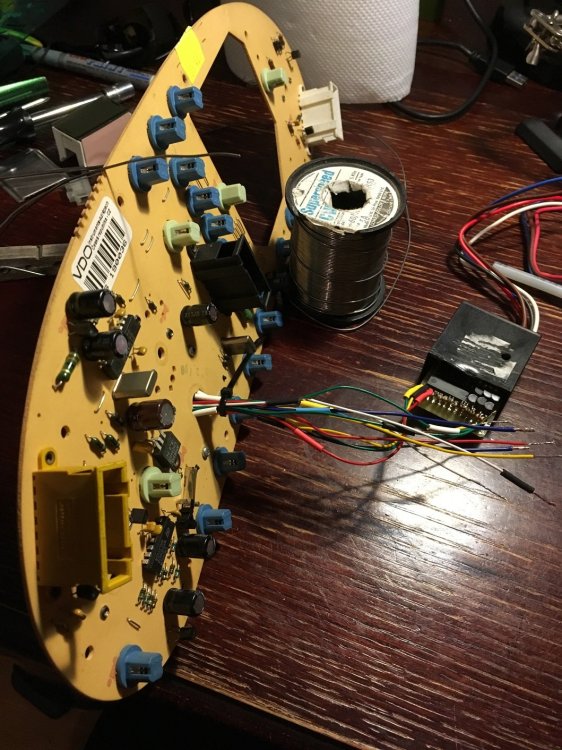

A while back I bought an OMP digital boost gauge off eBay. It had apparently been discontinued, so it was pretty cheap, and it struck me as something I may have a use for in the future. The gauge display looked a similar size to the Felicia digital clock display, so I decided to have a go at replacing the clock with the boost gauge.

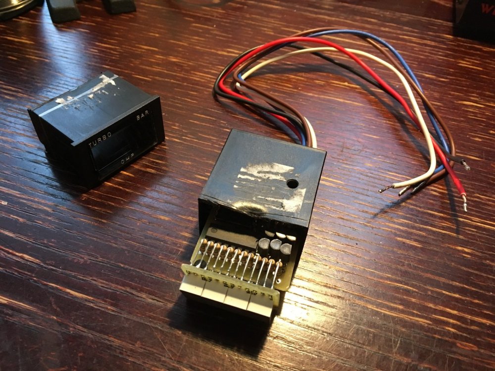

The boost gauge was comprised of two boxes, one containing the sensor, and the other holding the LED display plus the driver circuitry. The display proved to be a perfect push fit into the Felicia clock bezel, although the display box was obviously far too long to fit between the bezel and the PCB.

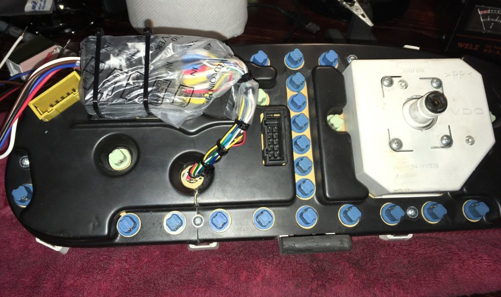

When I prised the display box apart, I found that the display was attached to the circuit board via 13 resistors and one wire link, all of which were soldered at both ends.
I cut the display end of the case to length so it would fit between the clock bezel and the PCB.
The resistors and wire link were all de-soldered from the display board, and as I did not have any suitably fine wire to re-connect the two circuits I separated the cores from a length of CD changer cable and, as I did not have 14 different colours to tell them apart, I used coloured heatshrink. Once all the connections were made at the display end, I fed the wires through the hole in the PCB where the clock illumination bulb normally goes, and re-attached the clock  bezel to the PCB, with the boost gauge display inside it. I then started to solder the interconnecting wires to the resistors on the driver board. This was the point at which I wondered why I had ever thought this was a good idea!
After an hour or so of peering through a magnifier to see what I was doing, I had all of the connections made.

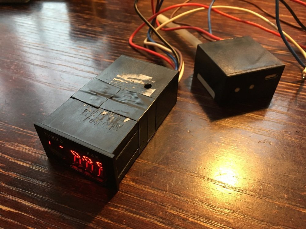

Much to my relief, when I then connected a 12v supply to the boost gauge, the display all worked as it should.

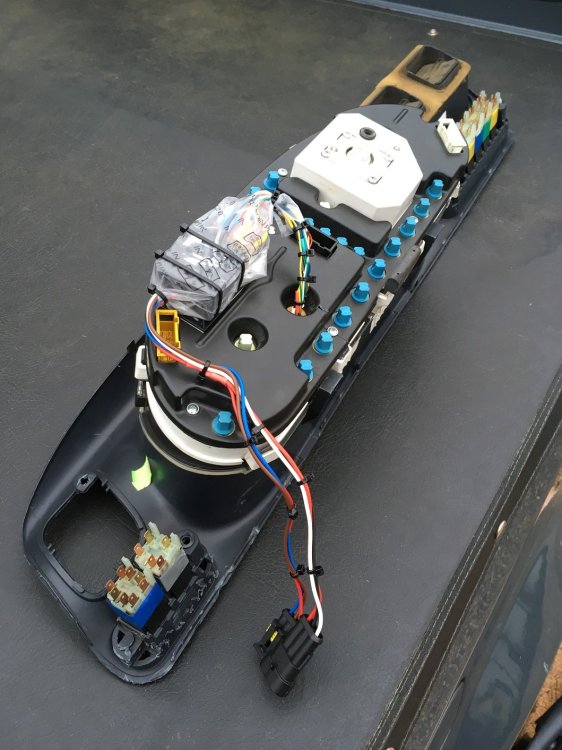

So that I could get the wires through the rear cover of the speedo cluster, I cut the cover from the edge, through a screw hole, and onto the hole originally for the clock illumination bulb. The exposed end of the circuitry is protected inside plastic, and the driver box is cable tied to the rear cover.
I wired a couple of 3-way Superseal connectors, one for between the driver box and the sensor, and the other to connect to ignition 12v, earth and display illumination spliced-in to the vehicle loom.
All fitted and working.

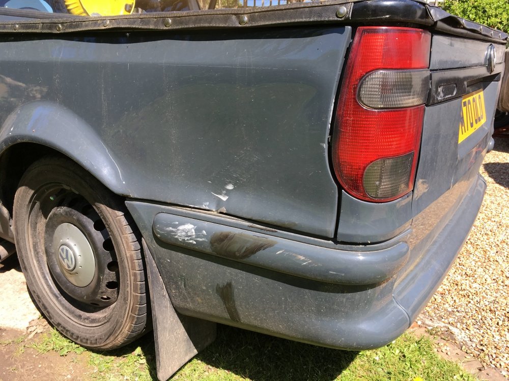

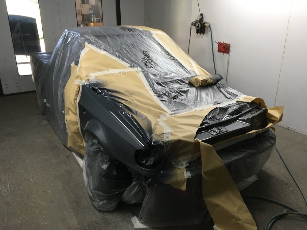

I went for an overtake that would have been unlikely had the Caddy been standard, but should have been straightforward with the 1.8T performance. Sadly, the bloke I was overtaking took offence, and gave me a little nudge on the NSR corner.
I was only doing about 50mph, but I got spun into a barrier at the side of the road. I will not be posting a photo of the front end damage on here, as I do not want to be reminded of it in the future, but suffice to say it is not pretty.
When Sussex Police showed-up, I asked them to look at the above tyre marks on the Caddy rear bodywork, which could only have happened if the other driver had turned toward me, and the plod's initial response was that it was paint transfer, in fact he said it was red paint transfer! This observation was made worse by the fact that the other car was not actually red :@. Even after I told him to look again, and he conceded that the marks were from a tyre, he was still reluctant to accept the likelihood of what I told him. He and I will be speaking again.
Meanwhile, the Caddy is back to the bodyshop Monday to be restored to its former glory B)

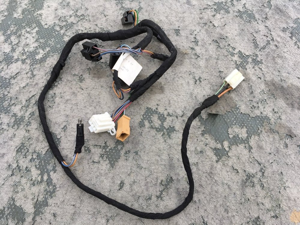

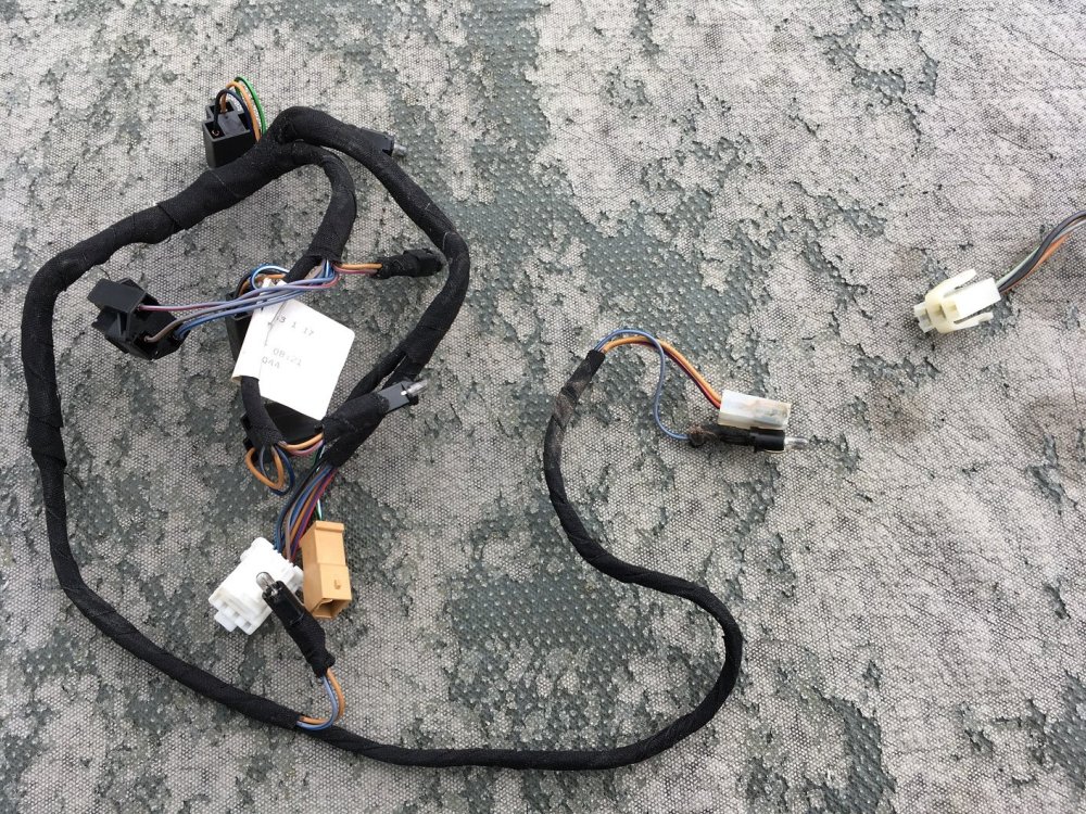

Anyone who read my Felicia pick-up thread will know I am a fan of additional gauges to let me know more of what is going-on under the bonnet. When I wired oil temperature, oil pressure and voltmeter gauges into the Felicia I just used the obvious individual insulated crimp terminals we all know and love. They did the job perfectly well, but I am OCD about my wiring, and I wanted to do a more professional job this time.
I have several sets of VDO gauges and the associated loom that would have been used to connect them in the Audi 80 or contemporary VWs, but neither the Caddy nor my Ibizas have the connectors in their standard loom to allow the gauge loom to plug in. So, I looked at the part number of the connectors (1x 6-way, 1x 2-way) on the Audi loom, and asked various VAG parts people if they could supply the corresponding plugs. No. Obsolete. Couldn’t even give me part numbers.
After much searching I found a website with a really comprehensive connector reference section. It was not in English, so I had to trawl through pages of pictures to find what I was after. Eventually I found part numbers for both plugs. After that, it wasn’t hard to find suppliers who could each supply one of the plug types, but they came without terminals. After further searching I found two more suppliers who could each supply one of the types of terminals required. Three weeks later, the parts had arrived from all over Europe.

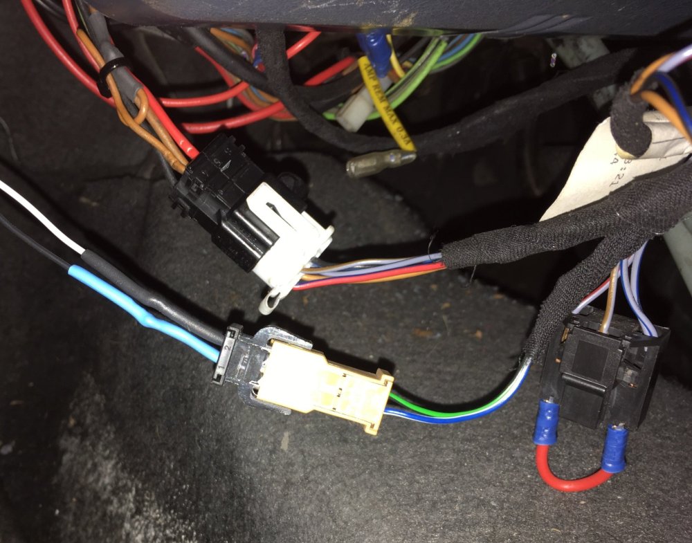

The gauge loom includes the cigarette lighter, so my plan was to unplug the standard cigarette light connector, and add the new loom between that connector on the standard loom and the cigarette lighter socket. This picture shows the Audi gauge loom, with its cigarette lighter socket connector towards the right, next to the Caddy cigarette lighter socket on the right.
The Caddy cigarette lighter socket connector was then soldered onto the gauge loom.
The battery 12v, earth, and instrument illumination wires that had previously connected to the Caddy cigarette lighter socket were then fitted to the appropriate pins of the new 6-way plug, along with an ignition switched 12v.
The gauge sender signal wires were then wired to the new 2-way plug, and from there it was plug and play.
After it was all tested and working, the wiring was wrapped in loom tape for a more professional finish.

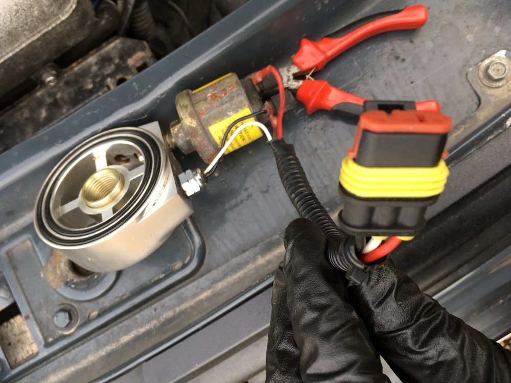

Under the bonnet I used the oil filter sandwich plate from the Felicia pick-up, which had oil pressure and temperature senders fitted already. A 3-way Superseal connector was used to connect these to the signal wires and earth.

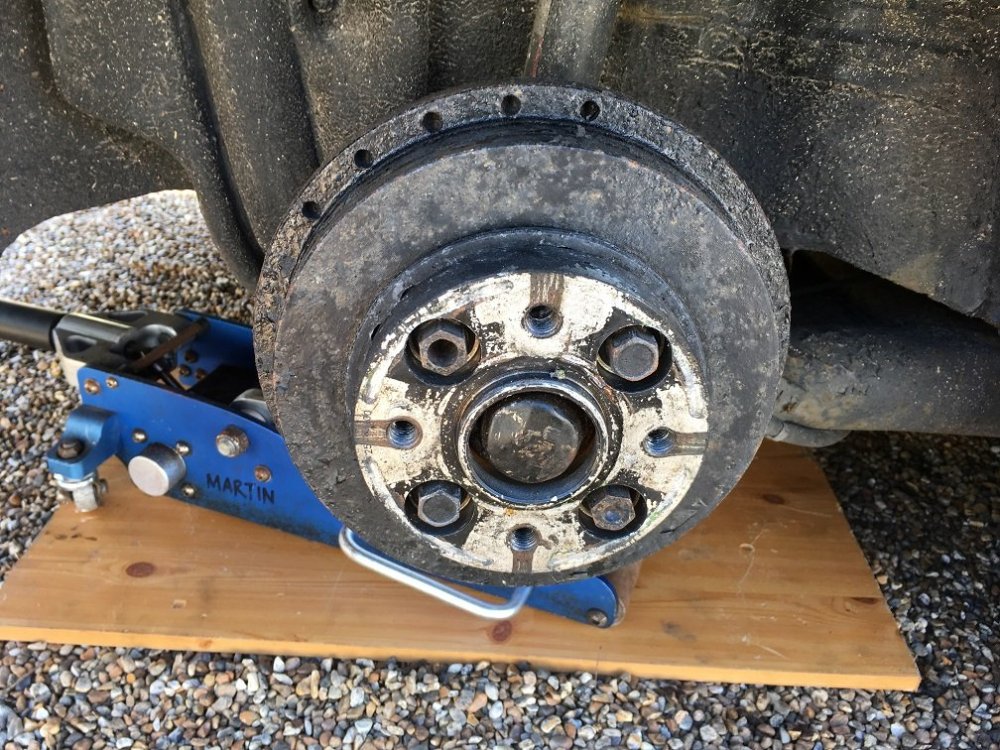

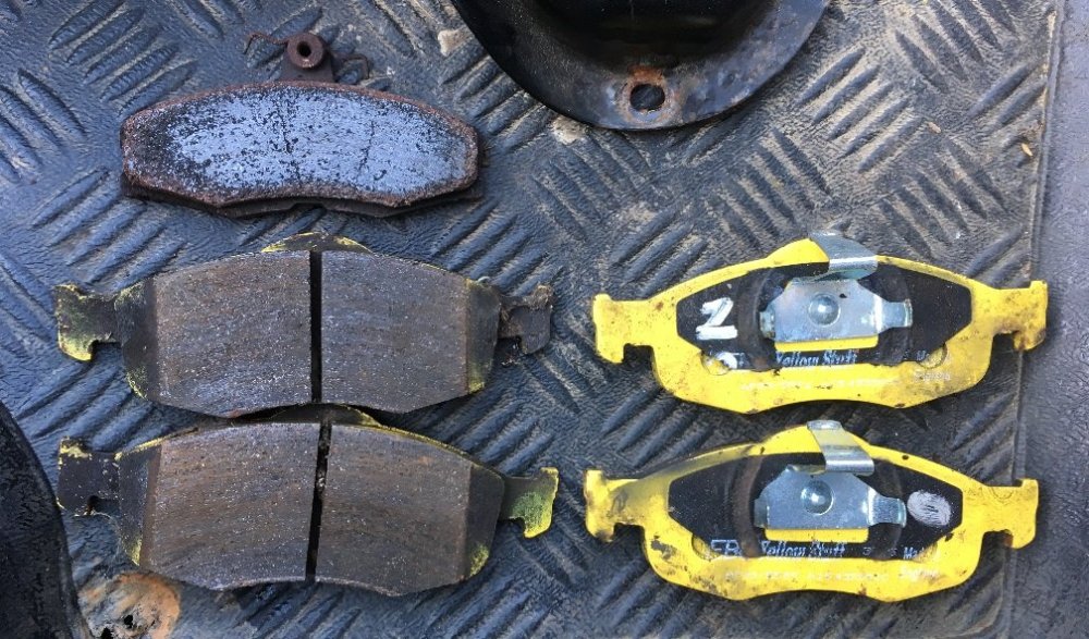

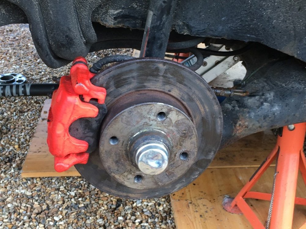

The standard brakes were never going to be sufficient to handle the increased performance, and it was always my intention to rob the appropriate parts from the Felicia 1.8T. TeflonTom wrote-up the conversion on the Felicia thread, so I will not replicate it here.
When I removed the rear wheels I found both 25mm and 5mm spacers fitted. The original bolts for the 25mm spacers had evidently gone missing at some point, and the bolts that had been used to replace them did not quite sit flush with the wheel mating face. I definitely should have noticed that when I had the wheels off previously!
I sourced some bolts with shorter heads to use when the 25mm spacers were re-fitted (after the photo was taken). The 5mm spacers did not go back on.

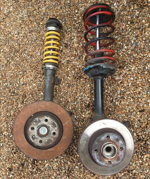

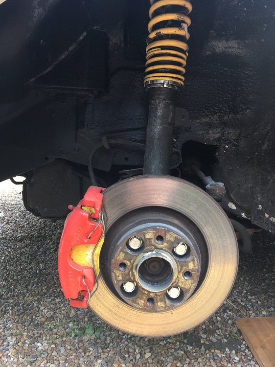

The front brakes were a bit more complicated to upgrade. Again, most of the hard work had been done in uprating the brakes on the Felicia 1.8T, and I only had to swap the bits over. The brakes going on are Golf G60 discs (again, same as mk2 Ibiza GTi parts) with Mondeo ATE callipers. The Mondeo calliper mountings line-up with those on the Caddy hub carrier, but the carrier has to be machined to take the larger M12 bolts. The hub carriers I took off the Felicia had this done, and had been fitted with mk1 Ford Focus coilovers. These coilovers are nasty FK units, and will be swapped at some point, but for now they are on the Caddy.
Pictured below are the ‘standard’ front upright and brake, and the replacement with the larger disc and the coilover.
The difference in size between the discs is not that obvious in that photo, but when you see the comparison between the pads it is more striking. The standard pad is at top left, and the other four are the EBC Yellowstuff pads I am using in the Mondeo callipers.
Front upright in place, complete with nice shiny (and shorter-headed) new spacer bolts.

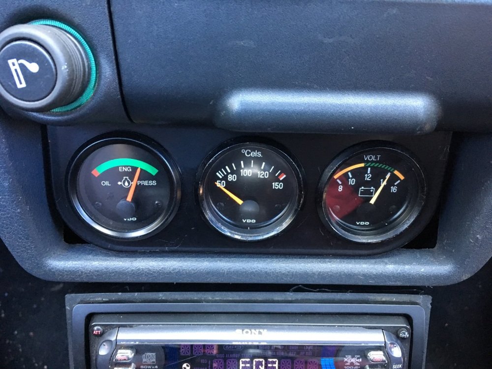

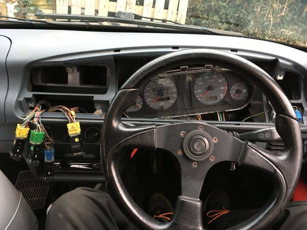

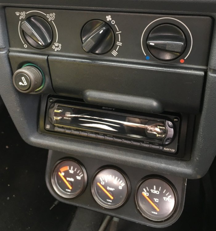

As I mentioned previously, with the extra gauges being mounted under the centre of the dashboard, they were very hard to read. The easiest one to see was the one farthest away, which was the voltmeter, and was therefore the least critical of the three. Both the oil temperature and oil pressure gauges spent too much time at the lower end of the scale, for different reasons, so there was clearly room for improvement.
The oil temperature gauge was always reading at the lower end of the scale because its range was 60-170˚C, meaning that the normal reading of around 90˚C was close to the bottom. This was easily rectified by fitting a gauge with a range of 50-150˚C.
Having never had the oil pressure warning light showing, I had never worried about the reading on the  oil pressure gauge, even though it was towards the bottom of the scale. I had to swap out the oil filter sandwich plate because the O-ring had started to leak, and whilst it was out I also swapped the oil pressure sender. I had bought a 0-5bar sender, suspecting that the one that was fitted would be a 0-10bar item, and so it proved. Ironically, now that I have fitted a sender which provides an accurate pressure indication, I have swapped the gauge for one that has no numerical scale, simply because aesthetically it was a better match for the other two gauges I was now using.
Having finally located the gauges from my Felicia pick-up, the voltmeter was swapped for the one from that set. The order of the gauges was also reversed, so left to right is now oil pressure, oil temperature, voltmeter.
I bought a DIN mounting box to put the gauges in the radio slot, but the box is going to need some Dremel work before it will fit. As a temporary solution until I have the time and inclination to sort that, I used the same gauge panel as had been mounted under the dash, but hung it on the bar at the top of the radio slot, held in by the ash tray and 12V socket.

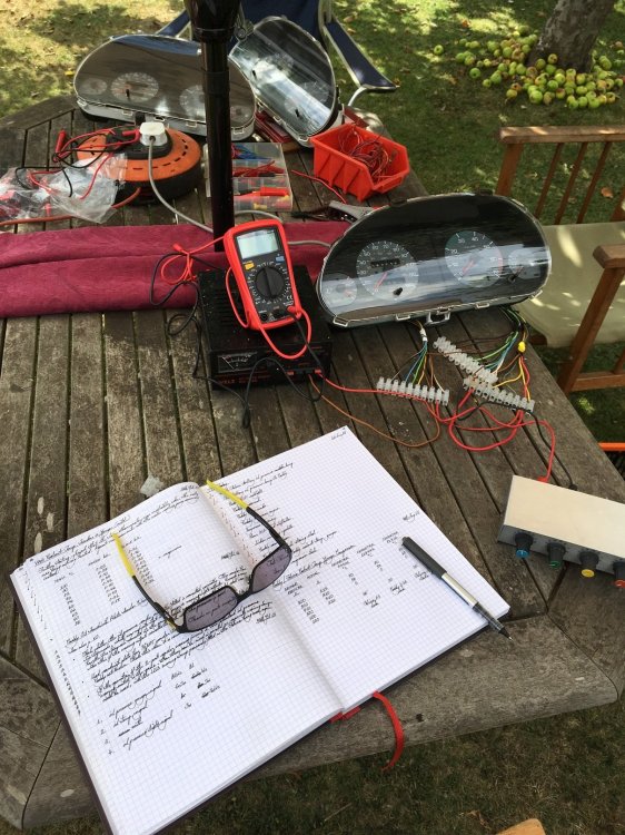

Engine cooling has always been an issue on the Caddy since the 1.8T transplant. It is not that surprising, as it now generates more than three times the power it came out of the factory with, and the associated increase in heat generation was never going to be insignificant. When the same engine was in the Felicia, the coolant temperature gauge generally sat just above the ‘normal’ mark, but quickly went up in traffic unless the radiator fans were switched-on.
The thermostatic switch for the fans had never worked reliably, and manual over-ride had been wired to the HRW switch and tell-tale, and I replicated this in the Caddy. During the transplant the radiator fan circuit in the Caddy had been modified to be a hybrid of the petrol (single speed fan, no relay) and diesel (two stage fan, relay switching) such that it operates both fans at a single speed, switched via the relay. With the new circuit in place in the Caddy, I succeeded in getting the thermostatic switch to activate the fans, and realised that it also illuminated the dashboard tell-tale when it did so, which I like.

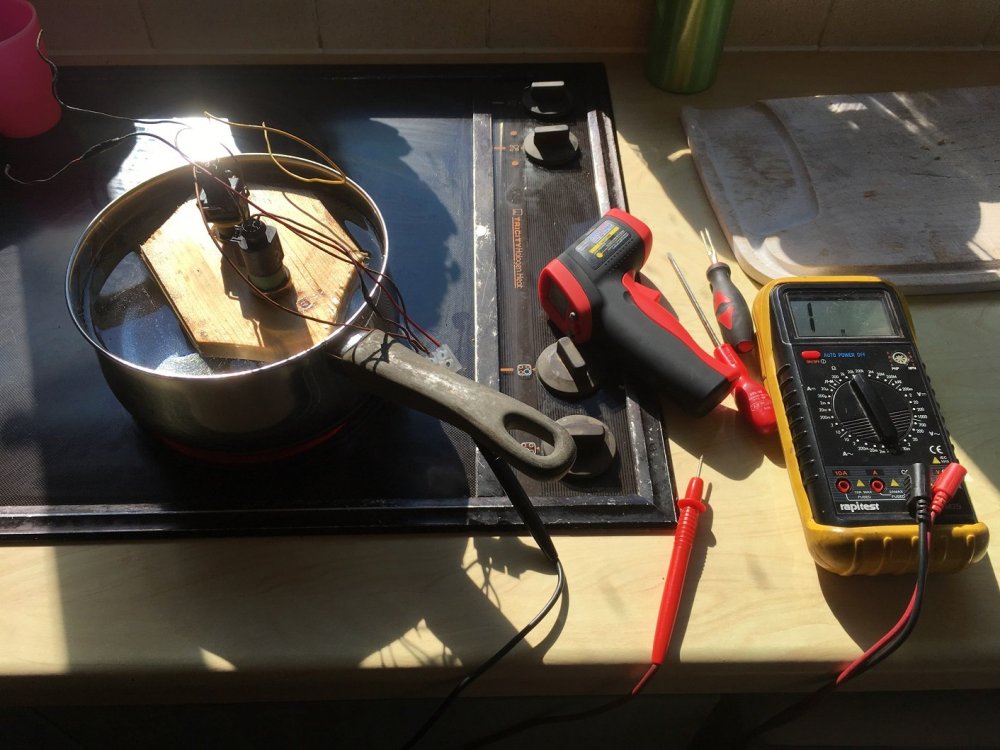

After the transplant into the Caddy, the coolant temperature gauge would go up pretty quickly after start-up to settle at about 100˚C, where it would stay during normal driving. In traffic it would shoot up from there towards the red if unchecked by the fans, although they would bring it back down to an indicated 100˚C pretty quickly. Despite showing some high temperatures at times, I rarely saw the tell-tale indicating that the thermostatic switch had kicked-in, and I never saw (or smelled, heard) symptoms of over-heating. I concluded that the coolant temperature gauge circuit was not indicating correctly, and embarked in trying to work-out why.
In unmodified cars, a problem such as this is usually caused by a component failure. This is also likely in a modified car, but it is also possible that components which were not designed to work together are individually operating as they should, but are not working together properly so that their operation is not having the desired effect. Once I started reading-up on the various specifications of coolant temperature senders fitted to VAG cars, and some of the problems this has caused after modifications, I decided that what I was seeing was a similar issue.
This is probably well known to many on here, but the VAG 4-pin temperature sender is two separate sensors, both of which vary resistance with temperature independently. One pair of pins provides engine temperature to the ECU, while the other pair of pins are those which drive the coolant temperature gauge. The resistance of the two sensors is not necessarily the same at any given temperature. It may have been more straightforward for the engine swappers among us if VAG had fitted two separate senders, but they did not. As the engine was running well, it appeared that the ECU half of the sender was doing what it should, but the gauge half was not.
I spent ages experimenting with various senders in pans of water which I heated and cooled whilst I measured resistances,
... with temperature gauges which I fed from variable resistors,
... and with various Felicia/Caddy looms which I buzzed-through trying to find a phantom resistor which I had read somewhere was in some models and not others.
After all this, my conclusions were...    sadly inconclusive :sadsmile:. I was pretty sure that I needed to add a resistor into the gauge circuit, in series with the sender, to get the gauge to read accurately, but I was struggling to work-out the value of resistor I needed. Searching online to find what resistance values others had used I came across a thread about someone experiencing similar problems after he had fitted a 1.8T. He had asked for advice about what resistor he needed, and someone had pointed him in the direction of the temperature sender fitted to the mk2 Golf GTi 8V, which apparently has the correct characteristics for the 1.8T ECU and the older temperature gauges. That sounded worth a try, especially as I had one of those senders in my garage. Two minutes later, the mk2 Golf sender was fitted in the Caddy, which then started and ran fine (positive indication #1) and had the coolant temperature gauge settling on the ‘normal’ marking (around 90˚C).
Success! In this instance, if I had tried mindlessly swapping parts rather than trying to be clever and methodical about it, I would have got to the answer much more quickly.

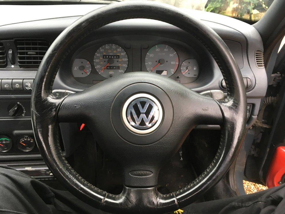

I was not a fan of the aftermarket steering wheel that was in the Caddy when I bought it, but it took me ages to make-up my mind as to what I wanted to replace it with. I had a Momo suede rally wheel in the Felicia 1.8T, but that wheel was more suited to a track car. I considered fitting one of the various styles of wheel available on the Felicia / Caddy range, but none of them that I have tried have been that nice to use. After a prolonged period of indecision reminiscent of my partner in a shoe shop, I decided I wanted a three spoke leather wheel like the one fitted in the mk4 Golf GTi. Little did I know this would open up a world of small spline / large spline confusion.
This was the old wheel, pictured during some earlier dashboard experimentation, and without its rubber centre cover.
I bought a Golf wheel off eBay, and ordered an adaptor to allow the (large spline) wheel to fit the (small spline) Caddy steering column. When I removed the old wheel, and went to slide the adaptor onto the column, it would not fit. I tried easing it on with a little coppergrease, and I tried decreasingly gentle levels of persuasion, but it was not happening. The old wheel went back on, and I went back to the drawing board (well to the internet, actually).
I found threads about the spline adaptors on a number of VAG forums, and a few of them said that they can be difficult to fit onto the column, as they are a tight fit, so some force may be required. That convinced me that I had not been sufficiently determined, so when I got the chance a week or so later, I removed the old wheel to try again. This time I tried persuading the adaptor into place using a hammer and a brass drift. It was still not happening. By this point I was confused and frustrated. I think of myself as being an experienced amateur mechanic, but swapping a steering wheel was defeating me.
In desperation, I resorted to counting the splines on the steering column and the inside of the adaptor. Given that I am long-sighted, this was no easy task, and I failed to determine exactly how many splines each part had, but I did convince myself they were not the same. I then started wondering whether the Caddy column was evidence of its pre-VAG Skoda origins, and was not ‘standard’ VAG small splines at all. This theory was only disproved after I had done some experimenting with steering columns and wheels from my SEAT Ibizas, which demonstrated that the Caddy column splines were the same as those on the Ibiza. So, I ordered another spline adaptor.
When the second spline adaptor arrived, I tested it on a Felicia steering column I had in the garage, and then on the Golf wheel, and confirmed that it fitted both of them before I attempted to fit it into the Caddy. When the opportunity came to fit it, my son was doing it whilst I was working on something else. He removed the old wheel (yet again), but then called me over as the adaptor would not fit onto the column. I had a moment or two of confusion and panic before I realised that there was already a spline adaptor on the column! The old wheel had been fitted using a spline adaptor, but on all of the numerous occasions I had removed that wheel (probably 10-12 times for various jobs) the adaptor had always come off with the wheel, so I had never noticed it. After all the confusion and messing about trying to source the correct adaptor, I had one all along, but I only found-out when I had found the solution anyway.
Finally I was able to get the Golf wheel fitted, and the look and feel of it makes the effort worthwhile.
I still do not know what the story is with the first spline adaptor I bought. It does not fit any steering column I have, although the outer splines are the VAG large splines pattern. I have stashed it in the ‘just in case’ box in my garage, where it is far from alone.
Much as I am happy with the new steering wheel, fitting it had an unfortunate consequence. The centre of the Golf wheel is larger than the old wheel and this makes it difficult to see the bottom row of dashboard warning lamps when the wheel is in some positions. The camera angle in the photo makes this look much worse than it is, and I am not worried about seeing the hazard warning, brake fluid level, alternator, or handbrake lamps all the time, due to the nature of what they are telling me, but if the oil pressure warning lamp comes on I want to know about it immediately. It would not have been that hard to rearrange (and re-wire) the warning lamps in the instrument cluster, but I decided to go another route.

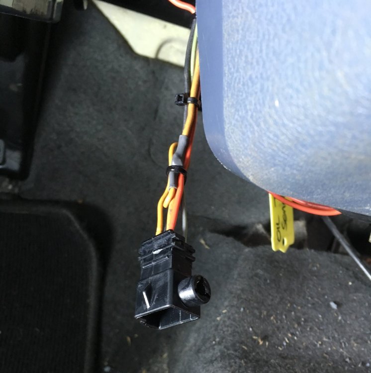

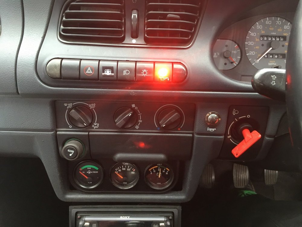

The replacement oil pressure sender I fitted had an oil pressure switch incorporated, which I had not initially connected. I now ran a wire from this sender terminal to a second oil pressure lamp which I fitted into a switch blank in the centre of the dashboard. This second lamp is a very bright 10mm LED which I had previously used in the Felicia 1.8T, and which you cannot miss if it illuminates. I like the peace of mind which comes from knowing I have two independent oil pressure warning circuits (plus the gauge!).
The steering wheel centre horn push on the old wheel was unreliable, so I had wired a second horn button into the dash. This remains in use as I have not (yet) connected the horn push on the Golf wheel.
The picture shows the LED oil pressure warning lamp, the horn button, and the HRW switch wired as a radiator fan over-ride, all resplendent with symbols I bought from Vehicle Wiring Products many years ago.

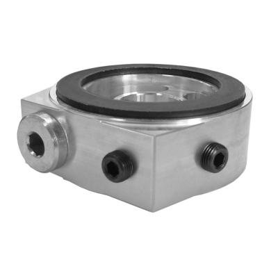

Ever since the engine transplant, there has been a slight oil leak from around the area of the oil filter housing. I had never seen the oil level drop noticeably, but there were always a few spots on the ground wherever the Caddy had been parked. JKM had noticed it, and had replaced the washer on the oil pressure switch, which improved things but proved not to be a complete cure.
It was very difficult to see where the oil was coming from, not helped by the lack of space around the engine, but it appeared that the leak was from the oil seal at the top of the sandwich plate between the filter and housing. I had bought the sandwich plate used, as I mentioned in a previous post, and it was not a great quality part. The oil seal in particular was fairly unsubstantial, as can be seen in the picture.
This sandwich plate went in the aluminium bin at the local dump, and I replaced it with a new part, which had a single more substantial oil seal rather than the two O-rings which had hardened and flattened with age. When I swapped the oil pressure sender and switch over I applied a couple of drops of thread sealer as an extra precaution. With the new sandwich plate fitted, the oil leak was further reduced, but maddeningly still not to zero.
The part that now came under suspicion was the oil seal between the oil filter housing and the heat exchanger. I bought a replacement and swapped it over, but when I re-fitted the sandwich plate the oil O-ring was not located properly. I only found this out when it was all back together and I started the engine, which resulted in a large pool of oil growing on the driveway. Not one of my better moments! The O-ring was damaged where I had tightened the sandwich plate with the O-ring incorrectly located. There was some swearing when I realised what I had done. I could not find a replacement O-ring without buying yet another sandwich plate, so this time I decided to buy a high quality sandwich plate for which replacement O-rings are available separately. Mocal have always had a very good reputation for oil coolers and related parts, and after a bit of searching I found a Mocal sandwich plate from Merlin Motorsport
The O-ring on this one is a substantial part, and spares are available separately. I do not plan to use lower quality sandwich plates on any of my cars in the future.
With everything back together, complete with the Mocal sandwich plate, things were definitely improved again, but still I was seeing a couple of spots of oil where the Caddy had been parked, and they still seemed to be emanating from the area of the oil filter housing. On a hunch, and because I could not think of a more plausible explanation, I removed the standard oil pressure switch again. The sealing washer had been replaced previously, as mentioned above, but when I took it off I could see that this washer, an aluminium part, did not look in great shape. I re-fitted the switch with a replacement copper washer and, finally, no more oil leak.

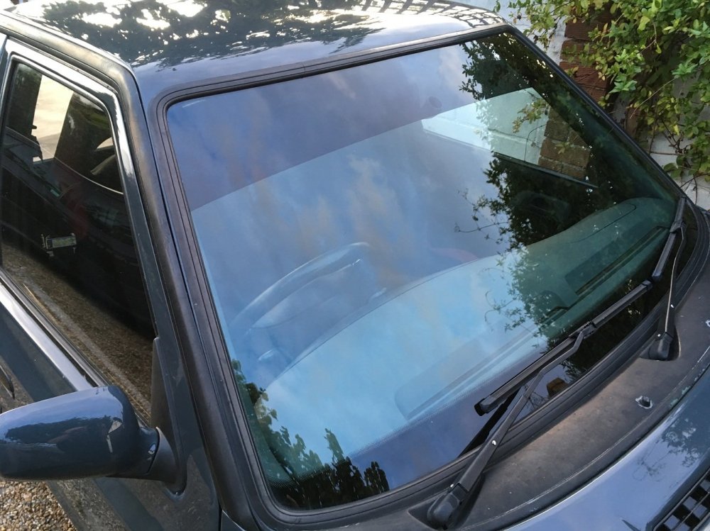

Having tinted sunstrips on my cars has become a habit since I first had one put on my Evo VIII almost 15 years ago. It was not my plan to have one in the Caddy, for aesthetic reasons, because a sunstrip can look a bit ‘scene’, whereas I am aiming for a more classic look. I relented for practical reasons i.e. I have got so used to having a dark strip at the top of my windscreen that it felt wrong (and sunny) without one.
I took the Caddy to South Coast Tints in Southampton, who have always done a fantastic job, and I am similarly pleased with the outcome this time.

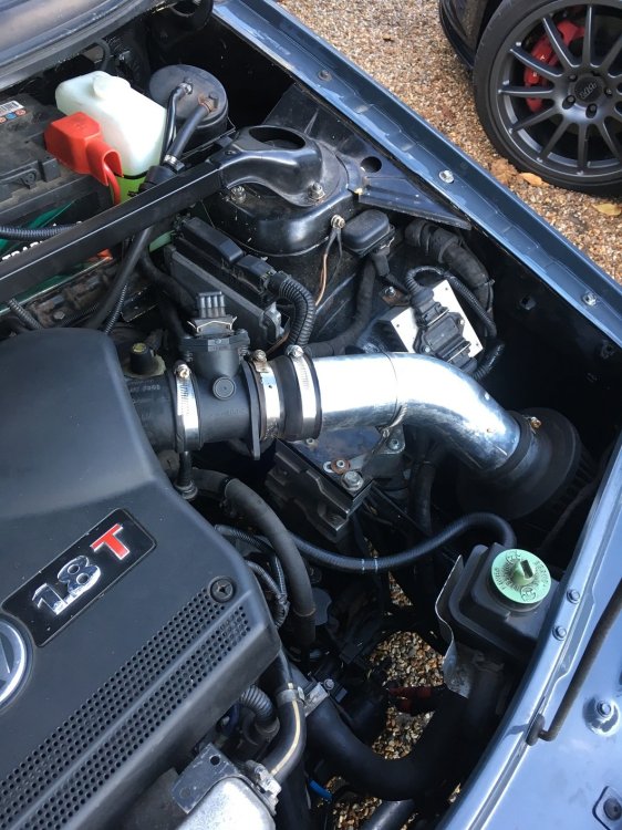

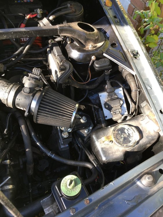

I had never been keen on having the cone air filter sitting in the midst of all the heat under the bonnet, and it had always been my intention to improve on this arrangement. The obvious thing to do is to relocate the screenwash reservoir, thus freeing space in the NSF corner of the engine compartment. This gets the filter further away from the hot engine, and gives the potential for a cold air feed through the front panel. The standard screenwash reservoir is specifically shaped for the location it usually occupies, and does not lend itself to being anywhere else. Instead I used a smaller (1.2l) "universal" washer bottle which is a more regular shape, and has roughly the same cross-section as the car's battery, meaning that the bottle can be located alongside the battery pretty easily. With the screenwash reservoir out of the way, I initially tried fitting a mk4 Golf / mk3 Ibiza airbox, but it was obvious that was not going to work, so I fitted the longer air filter pipe which had been on the Caddy when I bought it, which conveniently locates the air filter right behind the front panel, and adjacent to the inner wing. I still plan to replace the air filter with a better quality one, and to add ducting to encourage more cool air through the handy circular hole in the front panel, but what I have now at least gives some chance of feeding the engine with cool air, where there was no chance previously.
Before:
After:

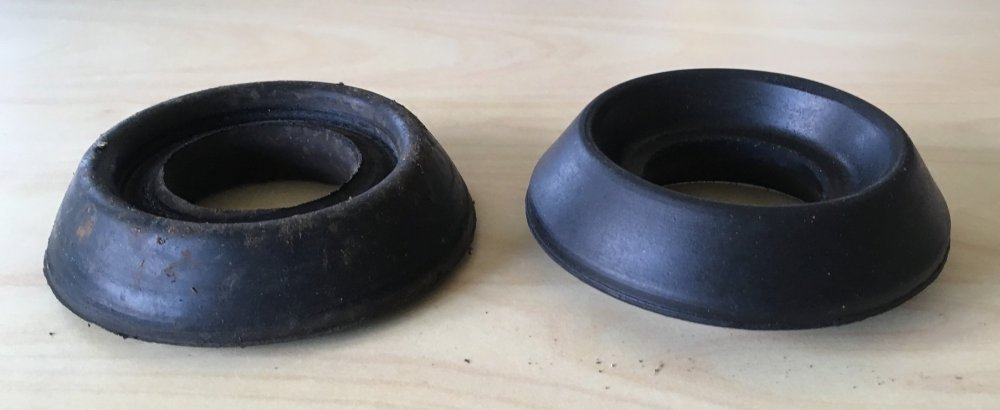

When I fitted the coilovers, my original intention was to check the rest of the suspension and replace as necessary, but it became one of those jobs done with time pressure to get it back together, so I did the minimum knowing I would have further items to attend to later. Recently the front end had started making some unusual and slightly worrying creaking / clunking noises when changing direction, which I took to be indicative of the front top mounts being shot. At this point I faced one of the challenges of modified cars, especially those which you have not built yourself. That challenge was not knowing what parts I needed, especially since in TeflonTom's Felicia 1.8T build thread he mentioned needing to find some top mounts to work with the Focus coilovers, but he did not mention what solution he came to. One solution would have been to dismantle the Caddy suspension, then attempt to identify the parts I removed. My approach was a bit less intelligent. As well as the Caddy, I own mk2 SEAT Ibizas and a mk1 Octavia RS, so I bought top mounts for both of them as well as Caddy parts, on the basis that I would hopefully find something to fit the Caddy, and the other parts would get used eventually anyway. Along with new CV joint gaiters, suspension bushes and wishbones (for later use) I gathered an impressive box of bits (rather than a box of impressive bits, sadly) waiting to be fitted.
As it turned-out, the standard Caddy parts were what I fitted. Seen side-by-side, it is evident that the replacement (Febi Bilstein) parts are a slightly different profile to the ones taken off, so the strut top will sit a little (<10mm) lower with the replacements fitted. This will increase the ride height correspondingly, but as the sump is showing signs of having had a few bashes, this is no bad thing. I can always adjust it out with the coilovers if it looks too much.
With the old parts removed, the top mount bushes themselves did not look too bad, but the bearings were a different story. I do not know how much work these bearings really do, but these were seized solid so they were only really acting as thick washers. Whether or not they were the source of the untoward noises, clearly they needed replacing.
