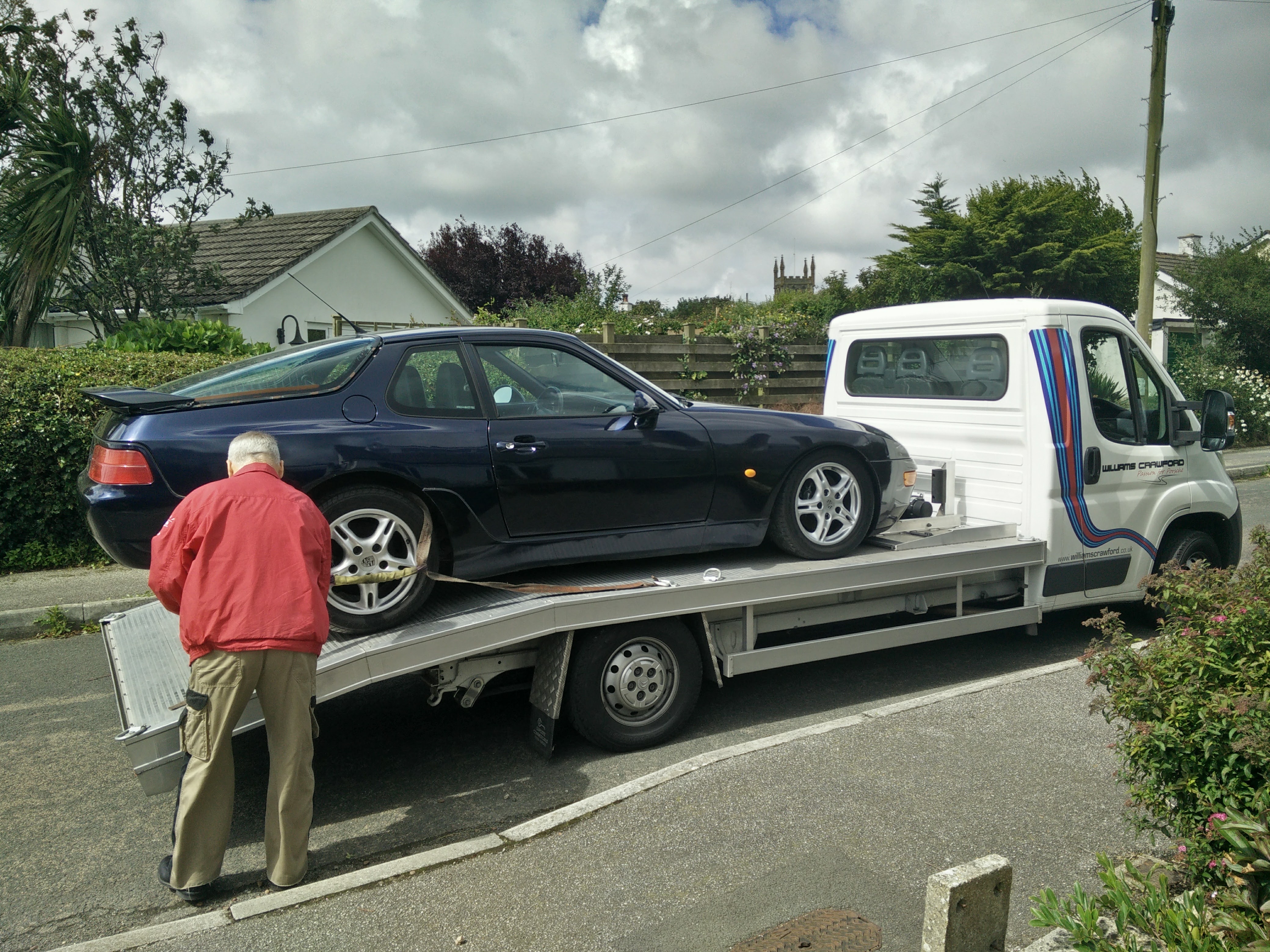

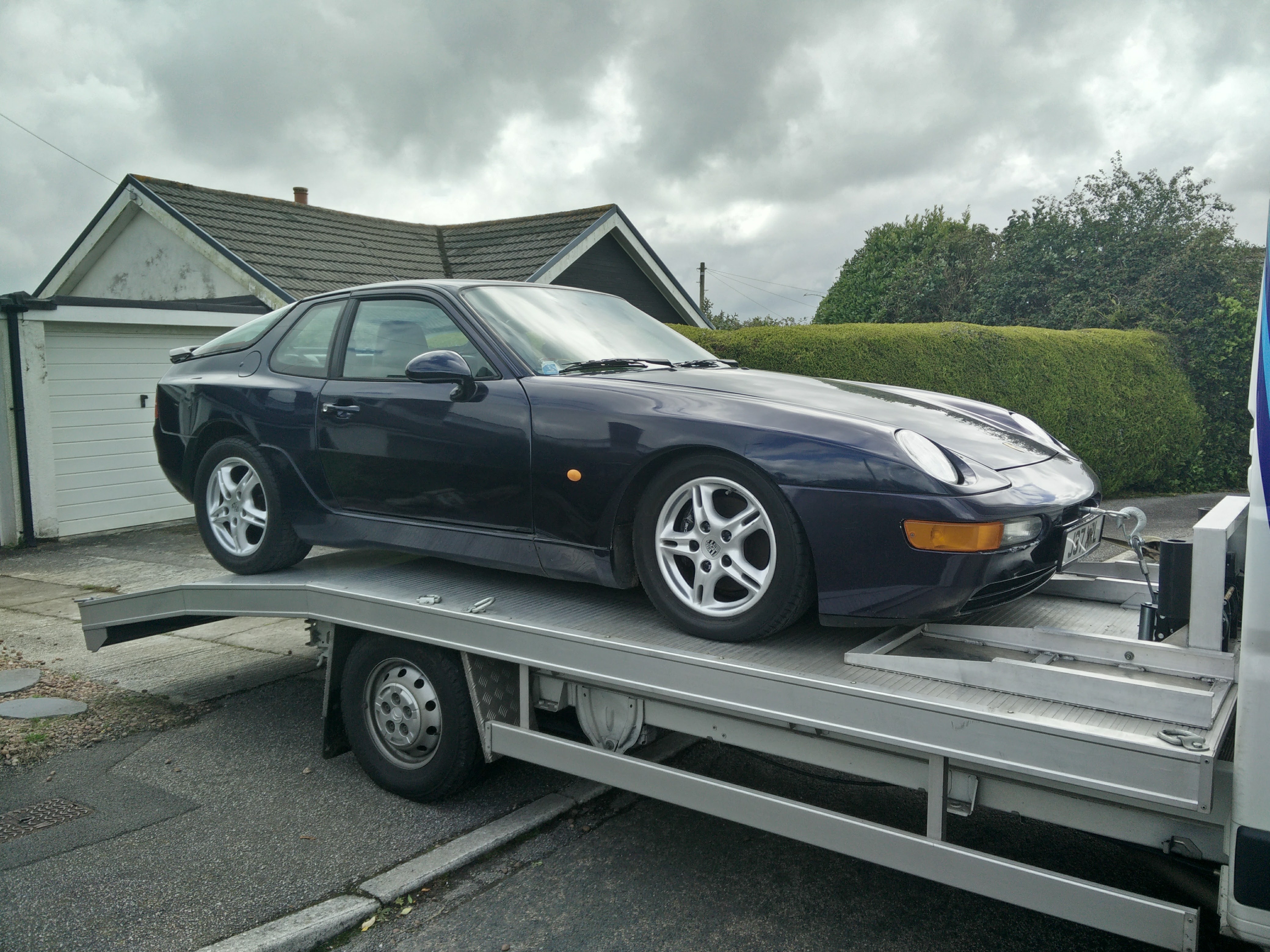

Started by sending my 1992 Porsche 968 off to Williams Crawford, a Porsche specialist, in August. Their arrival inspection identified a long list of things that needed repairing and renovating along with the good news that the underside wasn’t completely rotten. Only partially rotten! After this car’s lived mostly outdoors in Cornwall since I imported it in 2002 this was a major plus.
The conversation with Adrian Crawford revealed that I’m probably looking at about £10k for all the engine, suspension, braking, steering and bodywork (if I go all the way up to a windscreen out re-spray) :sweat: So just the price of a half-decent used Boxster then!
There aren’t going to be any more of these cars and I gave the go-ahead after a good deal of hand wringing.

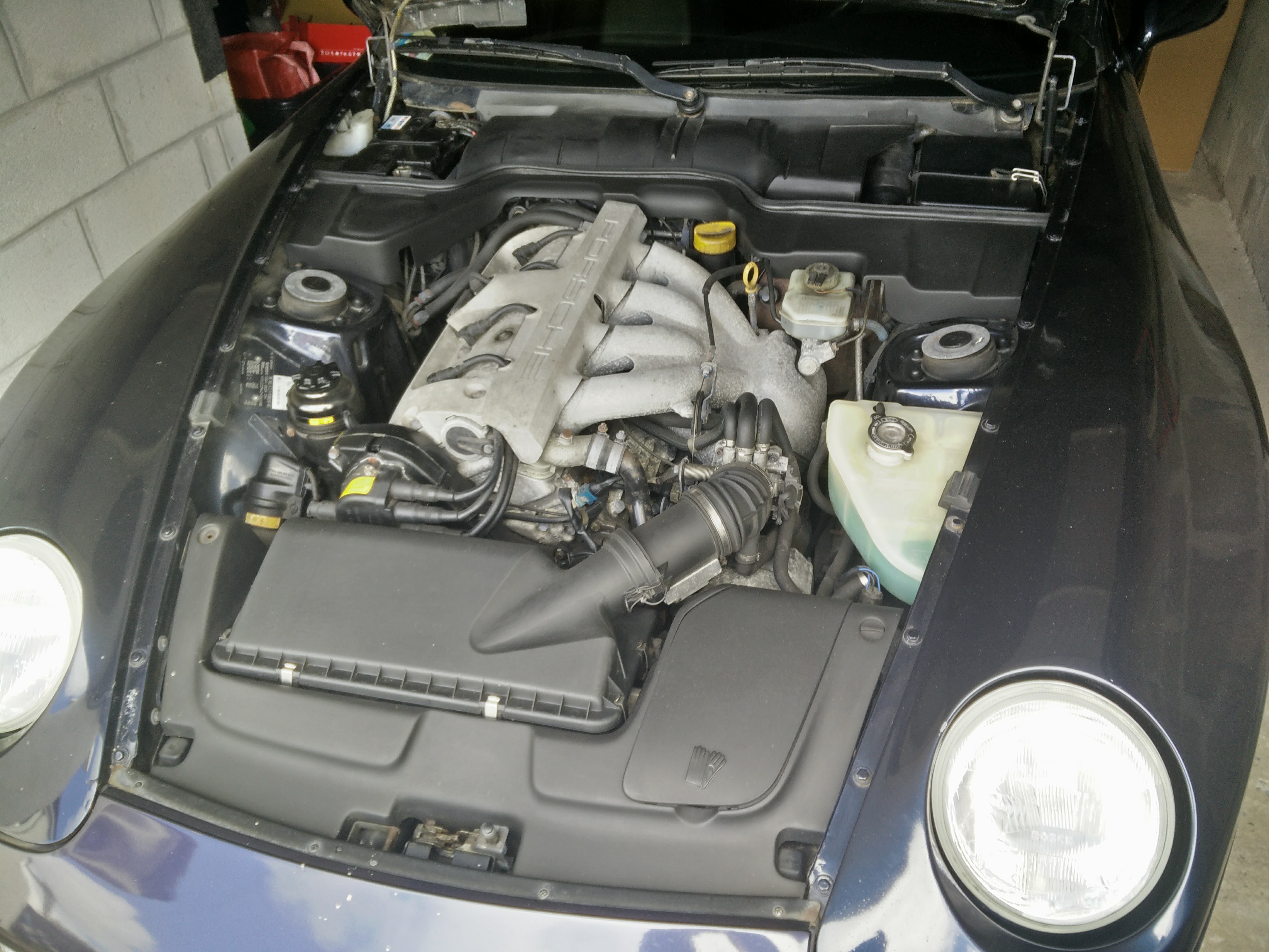

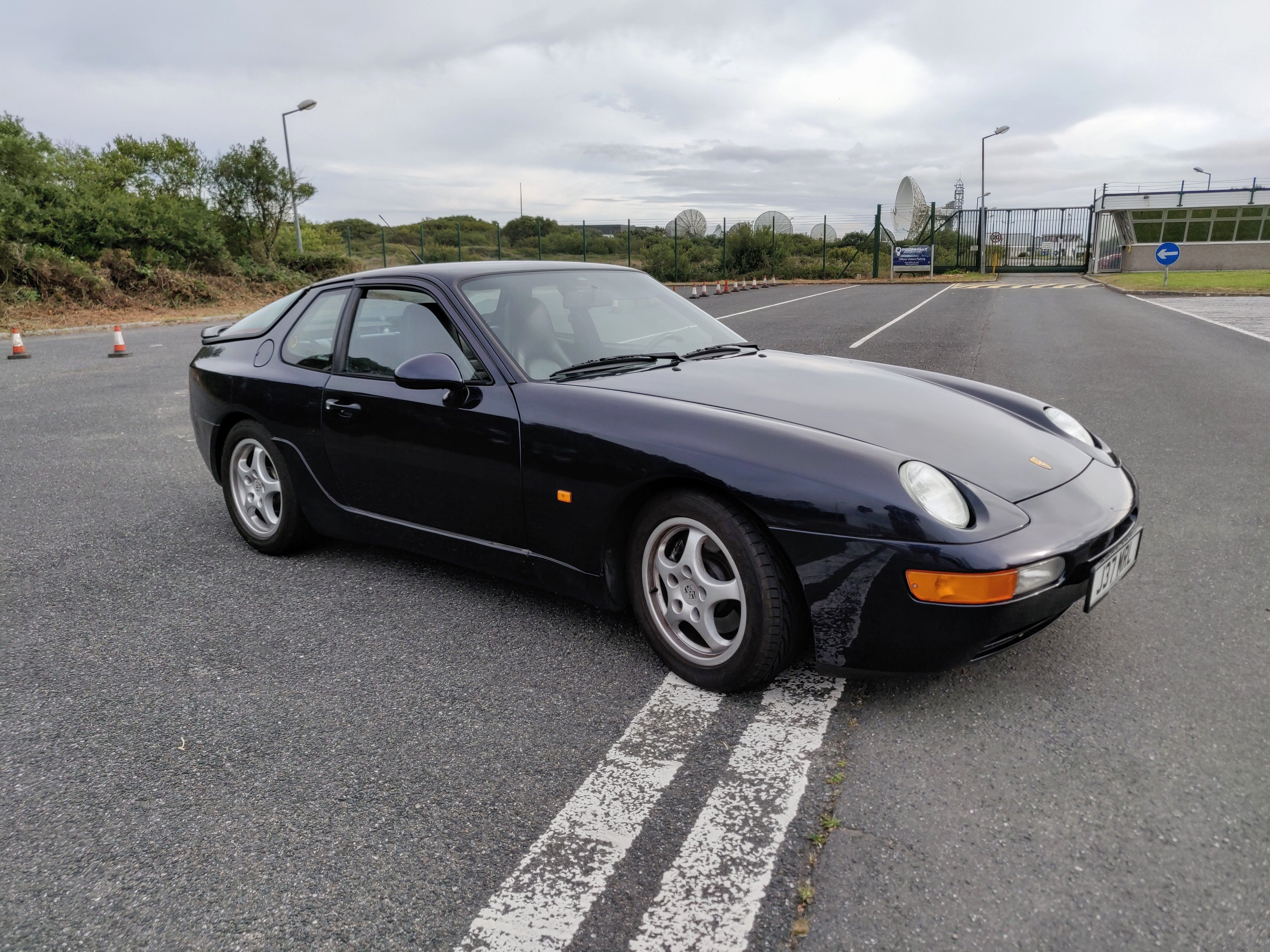

Work up to now has seen the engine examined, partly stripped, water pump replaced with all belts & fluids replaced, new brake discs and pads. Underside rot repairs carried out and under seal applied. Drive shafts stripped and refitted with all new gaskets and gaiters. Suspension bushes replaced and new BC racing coilover suspension ordered, steering bar universal joint removed and sent for renovation and replaced. I had my original Cup 1 wheels refurbished and new Toyo Proxes T1-Rs fitted; these will replace the Boxster alloys that you can see in these photos. I was in touch with them yesterday and the coilovers are due in the next couple of days. We’re in the process of deciding how the majority of the bodywork repairs should be tackled and where.

I took the wheels up to Saltash yesterday and discussed the state of the bodywork with Mark. I'm 99% certain of opting for a full respray with the windscreen needing to come out to treat some rust that’s appearing around the frame. A thumb-sized section around the off-side rear hatch locating pin will need to be cut out and re-made to treat rot there too.
Mark's fitted the coilovers. These are the ones that are now on (I forgot to take photos of them in situ)

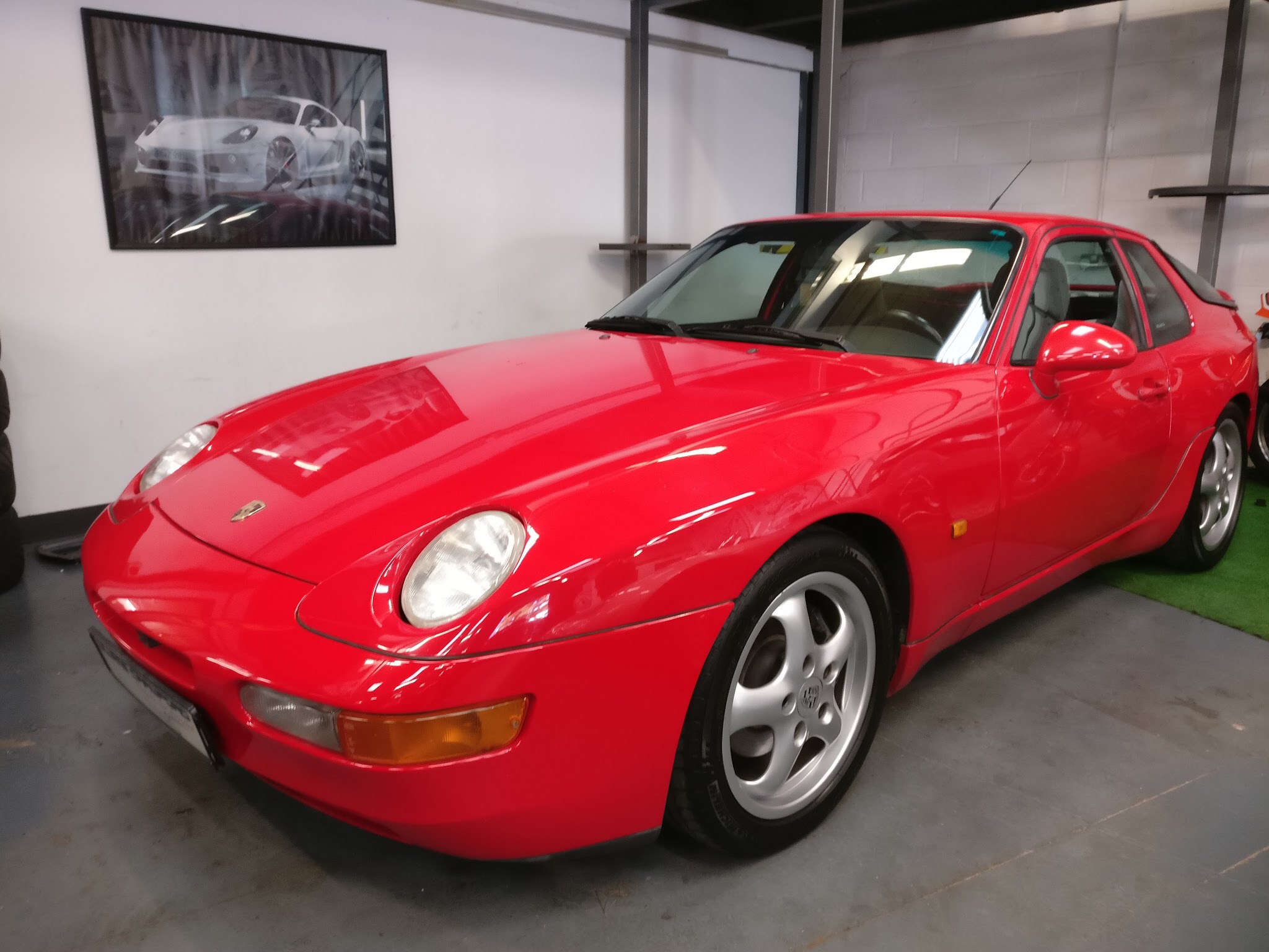

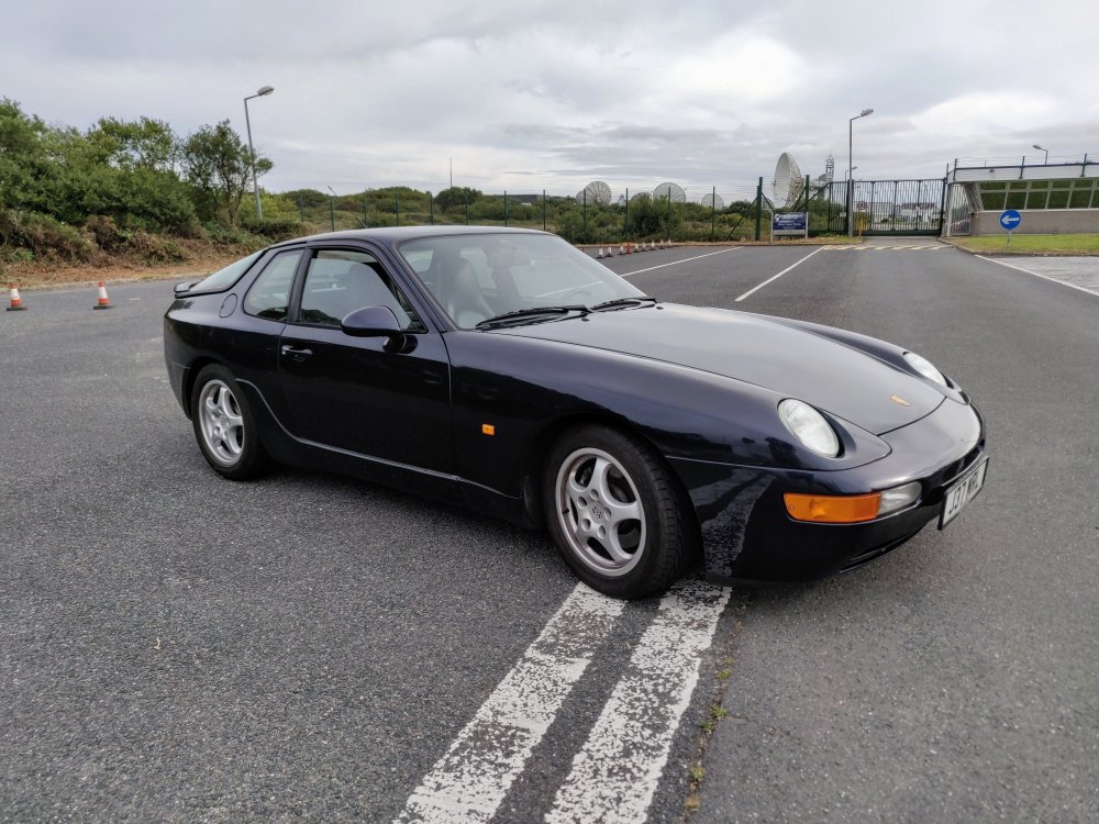

Using the coil over adjusters I’m going for a more standard M030/Club Sport ride height. Gratuitous 968 Club Sport photo:

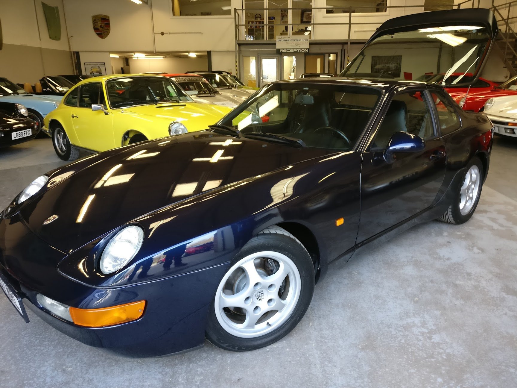

The cars nearly fully sorted now. Passed the MOT and all bar a light cosmetic bodywork tidy up is done. Will be picking the car up again soon and post new photos.

It’s been a year nearly since I got the car back. I haven’t made any more changes. None seem to be needed. There’s plenty of power and the updated and lowered suspension means it grips really well on fairly high profile (55/50) Toyo Proxes T1Rs. No big road trips materialised unfortunately and I’ve driven the car far too little. The starter does play up every so often so I’ll have to ask for that to be looked at when it’s in for an annual service.
