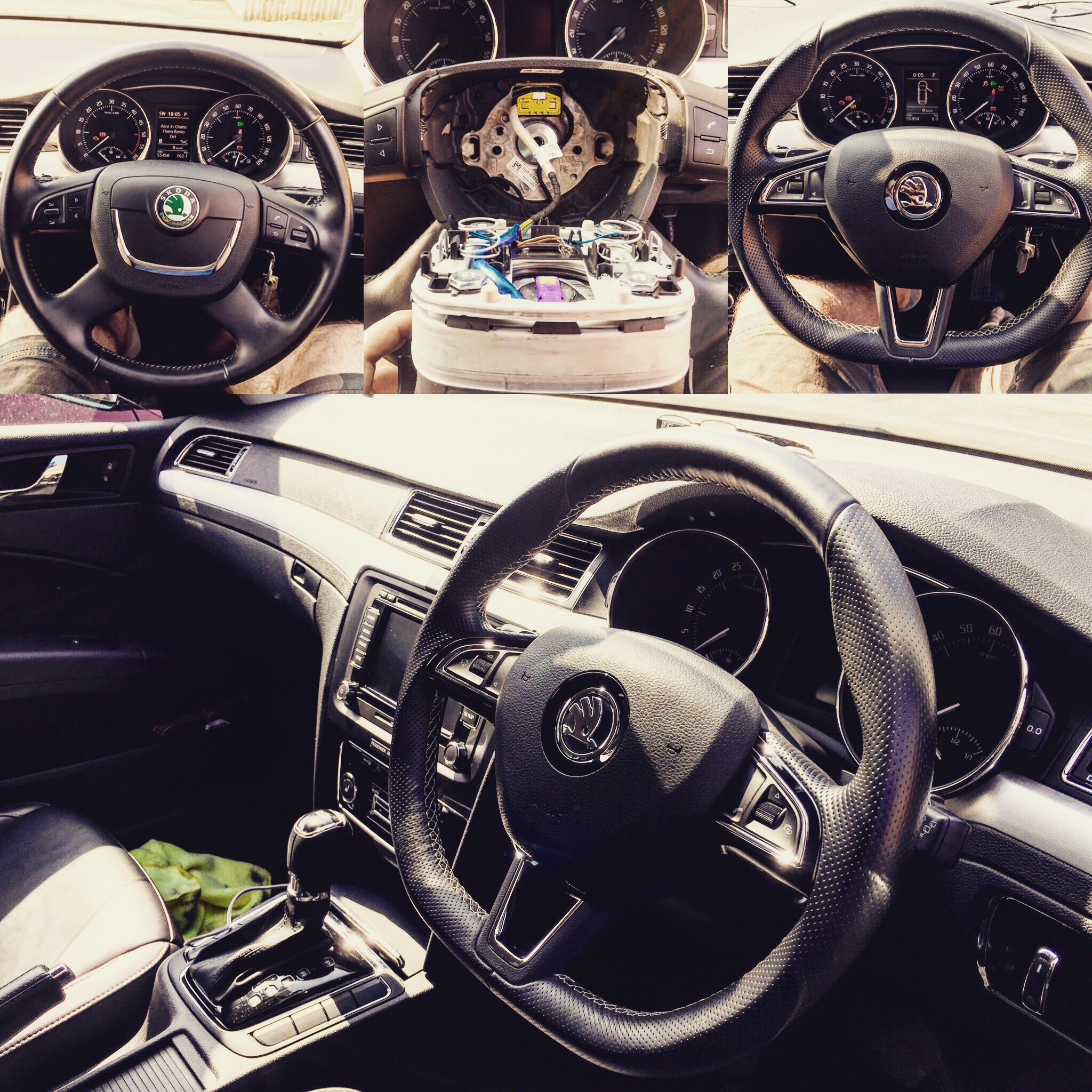

Hi I have a superb from 2011 and wonder if there is any sport steering wheel that fits on a Mk II?
Like this one:
 2017-Skoda-Superb-wagon-interior-changes
Or if one from a new superb fits, or can i take one from a audi and change the emblem?
You need just the steering wheel circle and it can be any Skoda that supports gear shifting pads (I assume you have DSG and shift pads currently), e.g. from O3RS, and then move multifunction buttons and shift pads from yours to the new one.
@pab567 - a 2011 Superb is likely to be a pre-FL MK2 so the MFSW buttons won't fit onto a MK3 Octavia style wheel.
@Ason - yes it should be possible to use that style of wheel.
Make sure the buttons are from a MK2 FL Superb or a FL Yeti. If the buttons are from a MK3 Superb/MK3 Octavia or similar, they won't work...
Right - I was looking too much at the picture... my mistake, sorry
Yep, it's an upgrade that I made earlier this year.. 1000% improvement in my opinion!
How do you find the flat bottomed wheel in comparison to the original wheel you had on?
Ideally I'd like one of those as well, but they always seem to be a lot more expensive than the normal round ones!
I'd love one of those on my 3.6 - flat-bottomed with white stitching.
Best place to buy?
Dave
Looks great!
What parts did you need to buy more than the steering wheel?
And where did you buy the parts?
Price?
Was it difficult to do the job?

I much prefer it as it looks and feels 'higher end'.. small things like the 'thumb rest' sections on the upper half make a big difference to comfort.
Takes a little while to get used to not being able to thread the whole wheel through your hands when making big turns though.

To do the whole job you need the wheel, airbag and MF buttons as the originals won't fit the new wheel.
Price will depends on where you get the parts, fitting took about an hour including VCDS coding in the wheel to get the DSG paddles etc working.

I don't have DSG paddles today, is´t possible to install one with paddles even if i don't have that before?
As long as you've got a DSG gearbox obviously, then yes as that's exactly what I've done.
yes I have a DSG gearbox,
Do you have a superb MK II ?
And do you have the parts number for the  wheel, airbag and MF buttons?
Edited by Ason
Yeah, it's a Mk II Superb.
I've not got the part numbers any more but all of the info you need is on this site, just do a search as that's all I did. :)
