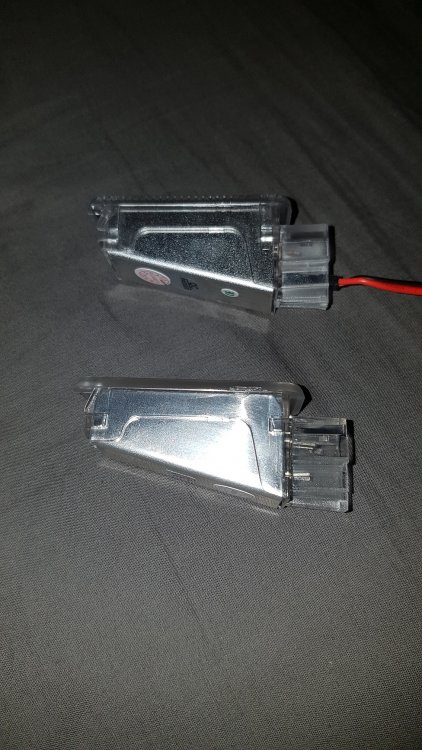

First, both work, fit very easily, and require no coding. You can actually see in the boot! The SuperSkoda unit was harder to pull apart because the pcb is almost an interference fit with the metal backing plate. The AliExpress unit is trimmed to fit in more easily. AliExpress also include a pigtail for use with older model cars but this pigtail fits the SuperSkoda unit also. To Australia, AliExpress shipping was faster and free.

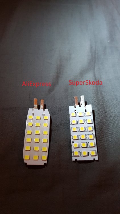

As you can see, they aren't actually the same, just similar. Same number of SMD LED's although they are different shapes, however I am not familiar enough with them to know part numbers.
DISCLAIMER: I know very little about electronics, just high school stuff. Any experts please chime in.
Designed to suit LaNbo's the AliExpress unit has a few more SMD components including a choke/inductor, schottky diode and LED driver. A few extra capacitors are present too.
The SuperSkoda unit makes do with 2 transistors rather than the LED driver, and that's about it. MB6P bridge rectifier rather than MB6S on the Ali unit, not sure of the difference. There't a touch more solder on the slightly larger connectors and the LEDs themselves are neater and flatter. Interestingly, that V-030901 model number leads to several also cheap units on AliExpress. Wonder if they're the same....

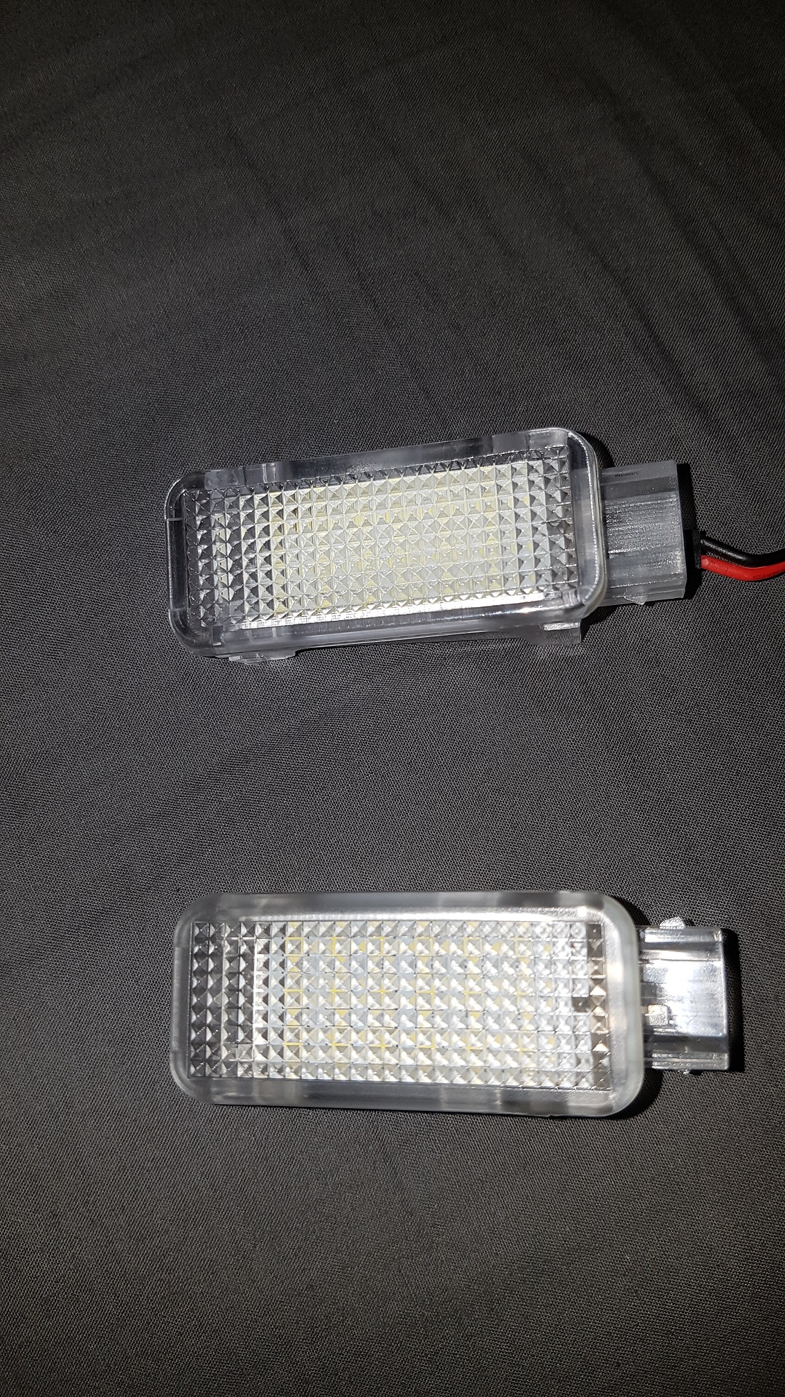

20171205_115610.thumb.jpg.7d839bb5ceac784d2ba8f455e2a70607.jpg20171205_115820.thumb.jpg.c6cc7185b292eb45835c931d093c1adc.jpg

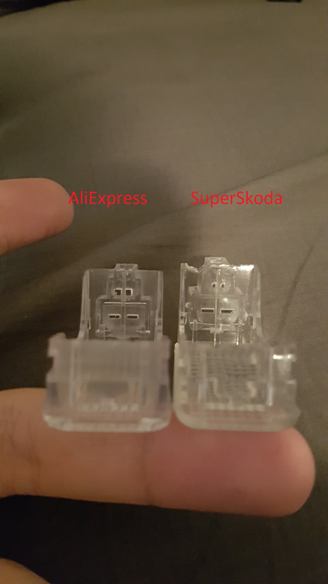

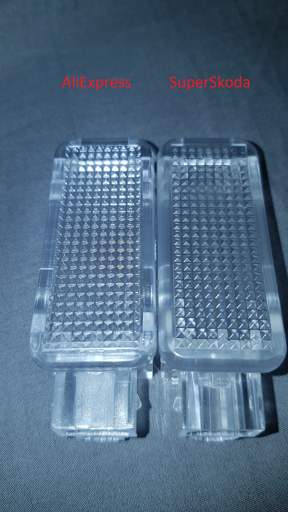

The plastic casings are also slightly different with the SuperSkoda one being slightly hazier and with smaller holes.
