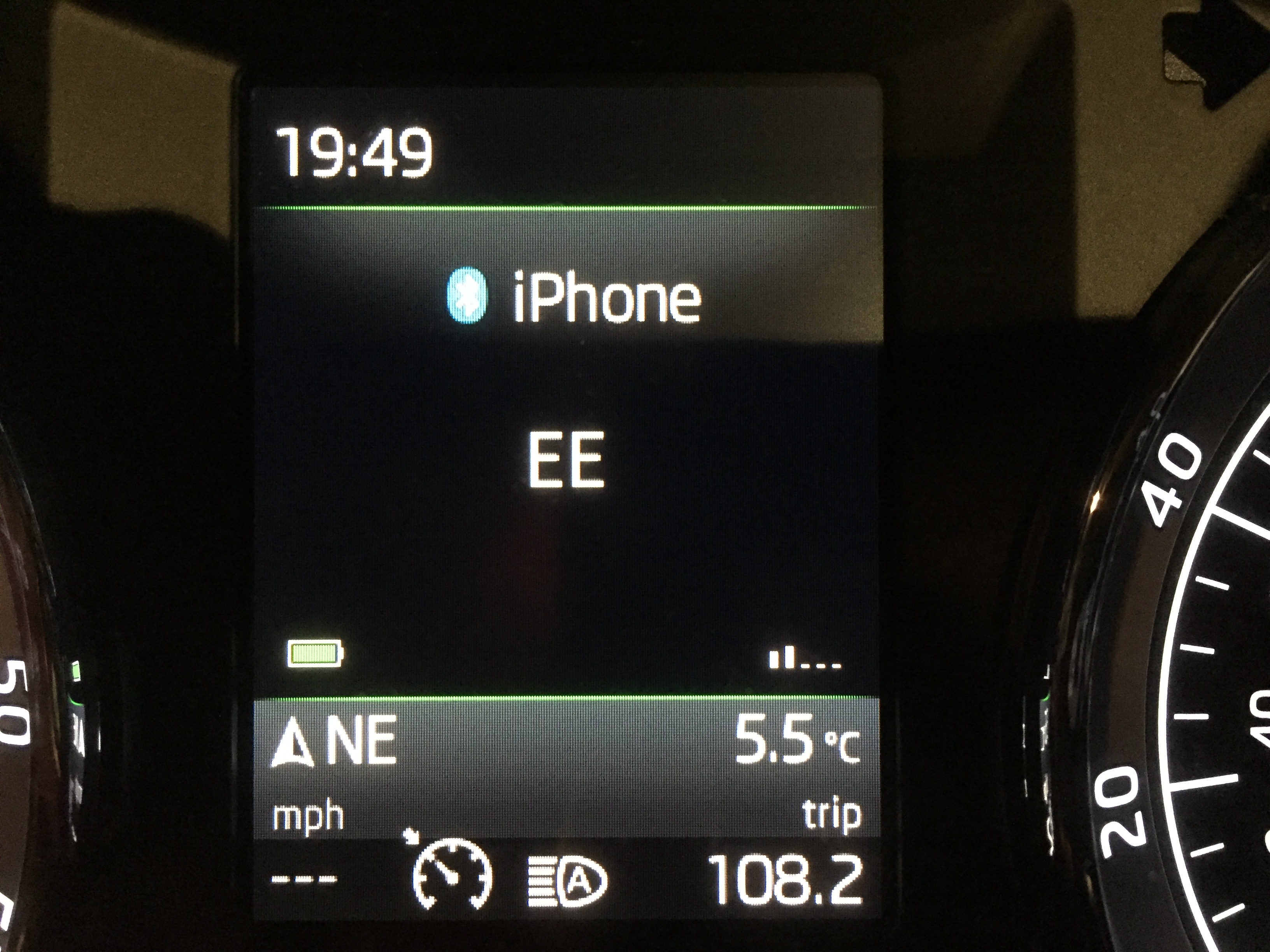

  • Beat me to it. I just went outside to take some pictures (to paint a thousand words...) If you have the option for Light Assist, this is what is also know as High Beam Assist or Intelligent

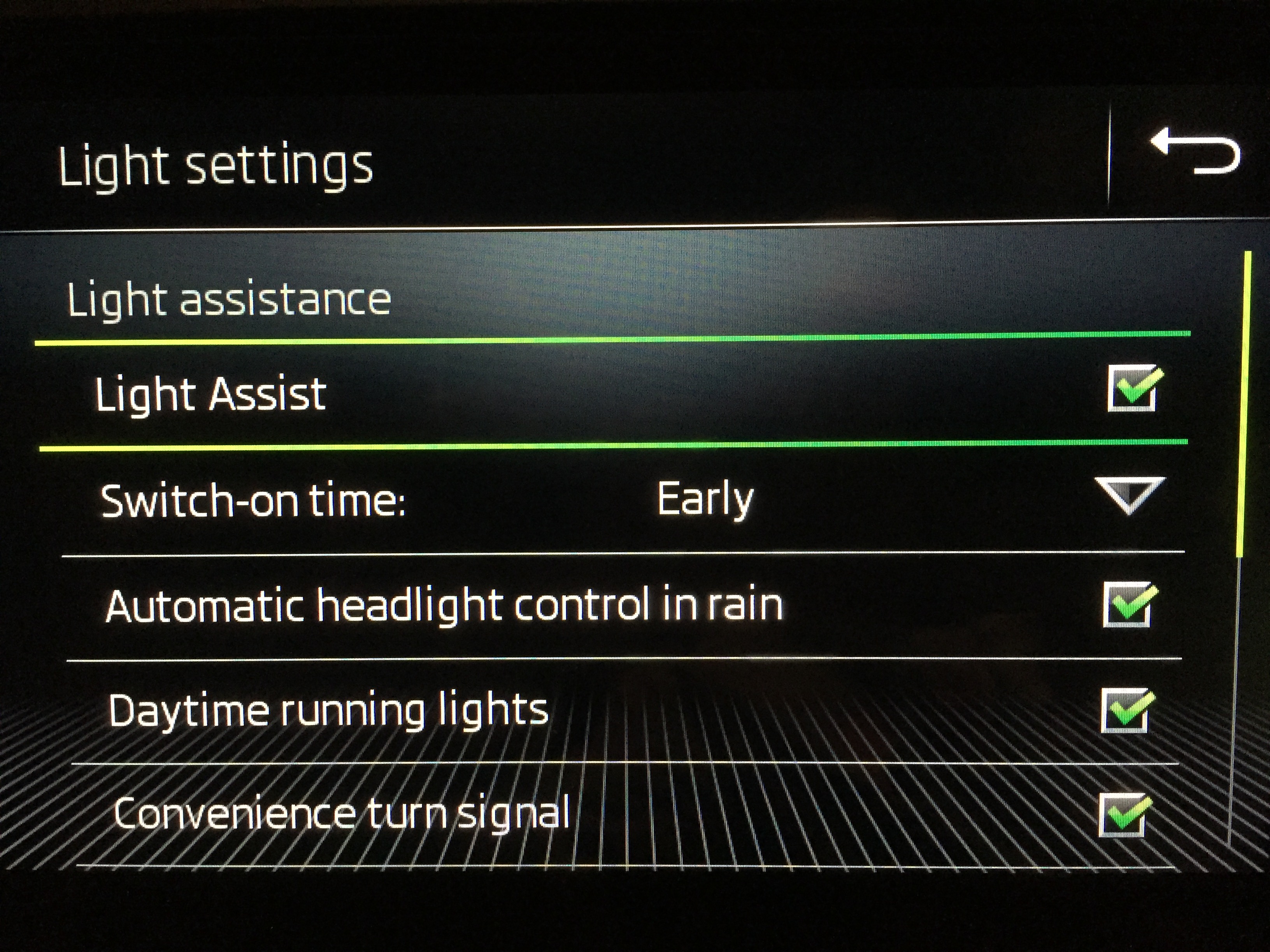

Light Assist is simply Auto headlights - uses the Rain Light sensor to work out if the headlights should be on or not. The settings you mentioned about early, normal late have some bearing on this. To use it you just switch the lights to Auto. This has been standard on the VRS since the introduction of the MK3.
HBA - or Intelligent Light Assist is the thing that determines whether high beam is used or not automatically and dips the beam if required. This uses the Lane Assist camera to perform this function. The stalk is pushed back and there is a high beam symbol with an "A" shown.
Hope this clarifies.
If you have the option for Light Assist, this is what is also know as High Beam Assist or Intelligent Light Assist.
When you push the indicator stalk forward, you should have the headlight symbol with the A inside it. Your high beams will then go on and off automatically when your speed is above 57kph. The system disengages when speed is below 27kph.
Clear as mud?
