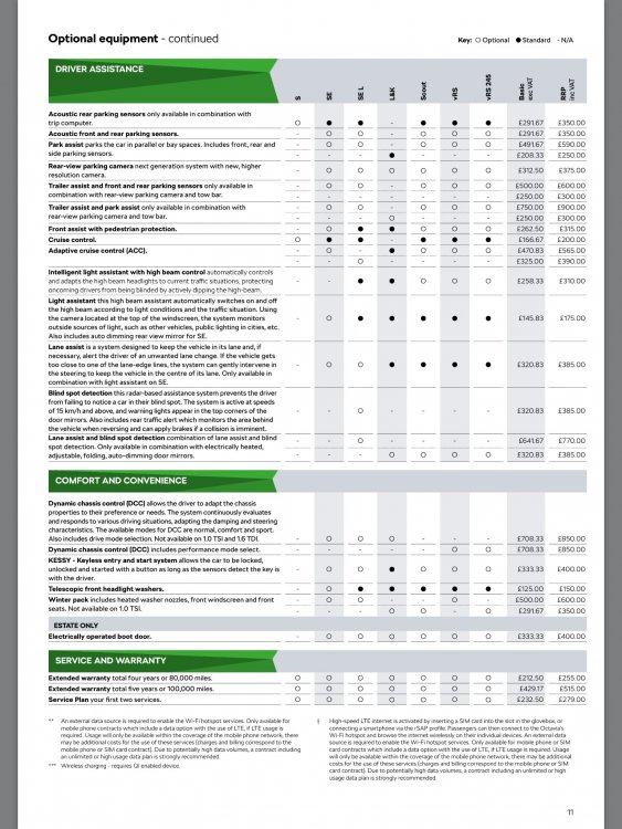

Can you post the rest of July brochure bud?
@Jayd
See attached for Octavia Jul 2017 Spec/Cost broucher

looked on mine this morning (vrs 245, got it late october) it has lane assist and the LED lights that change beam depending on speed, but as far as i can is it hasnt got TSR (traffic sign recognition), speed limit is in corner of admundsen when i have the nav screen on but nothing on colour maxi dot display.

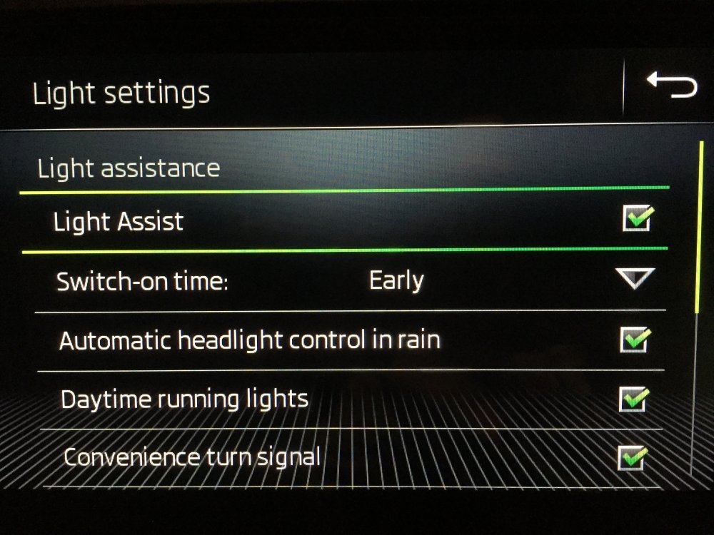

Got my 230 3 weeks ago.  The light assistant works different with the led lights, it decides totally what light is best automatically. All you need to do on the infotainment in the “light assistant” option is pick early-late. If you look at the stalk that controls the high beam, unlike other cars, you will only be able to flash (pull stalk) the main beams the push (on constant) does not work/not there. The car decides when high beams are required other than the flash.

No buddy, didn’t order that. Options had - Columbus, Black Pack, Alcantara seats, Heated seats and spare wheel. The “light assist” option is in: vehicle - settings - light assist. There’s then options for early/late (think there’s 3 options in total)
My understanding is that this only affects how soon the automatic headlights come on. It has no bearing on HBA.

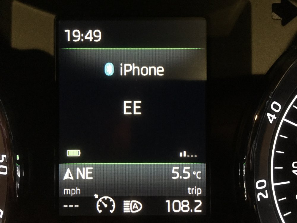

You can tell if you have HBA, lights in auto and push the left hand stalk away from you and let go. At the bottom of the Maxi Dot, in the middle you should see a main beam symbol in white with the Letter "A" in it. no symbol, no HBA. Only works when lights are in Auto.
Definitely no HBA, didn’t order it. But, Light Assist is/should be standard on vRS. Can’t figure out how to make it work/if I have it now! On the left hand stalk, it only functions for a flash (pull towards) does nothing when pushed away. Light switch is in auto mode.

Reading back I think I've misread a couple of posts and confused the two techs - not helped by the fact they are almost identically named and the topic of conversation keeps switching between them!
Light Assist is simply Auto headlights - uses the Rain Light sensor to work out if the headlights should be on or not. The settings you mentioned about early, normal late have some bearing on this. To use it you just switch the lights to Auto. This has been standard on the VRS since the introduction of the MK3.
HBA - or Intelligent Light Assist is the thing that determines whether high beam is used or not automatically and dips the beam if required. This uses the Lane Assist camera to perform this function. The stalk is pushed back and there is a high beam symbol with an "A" shown.
Hope this clarifies.
