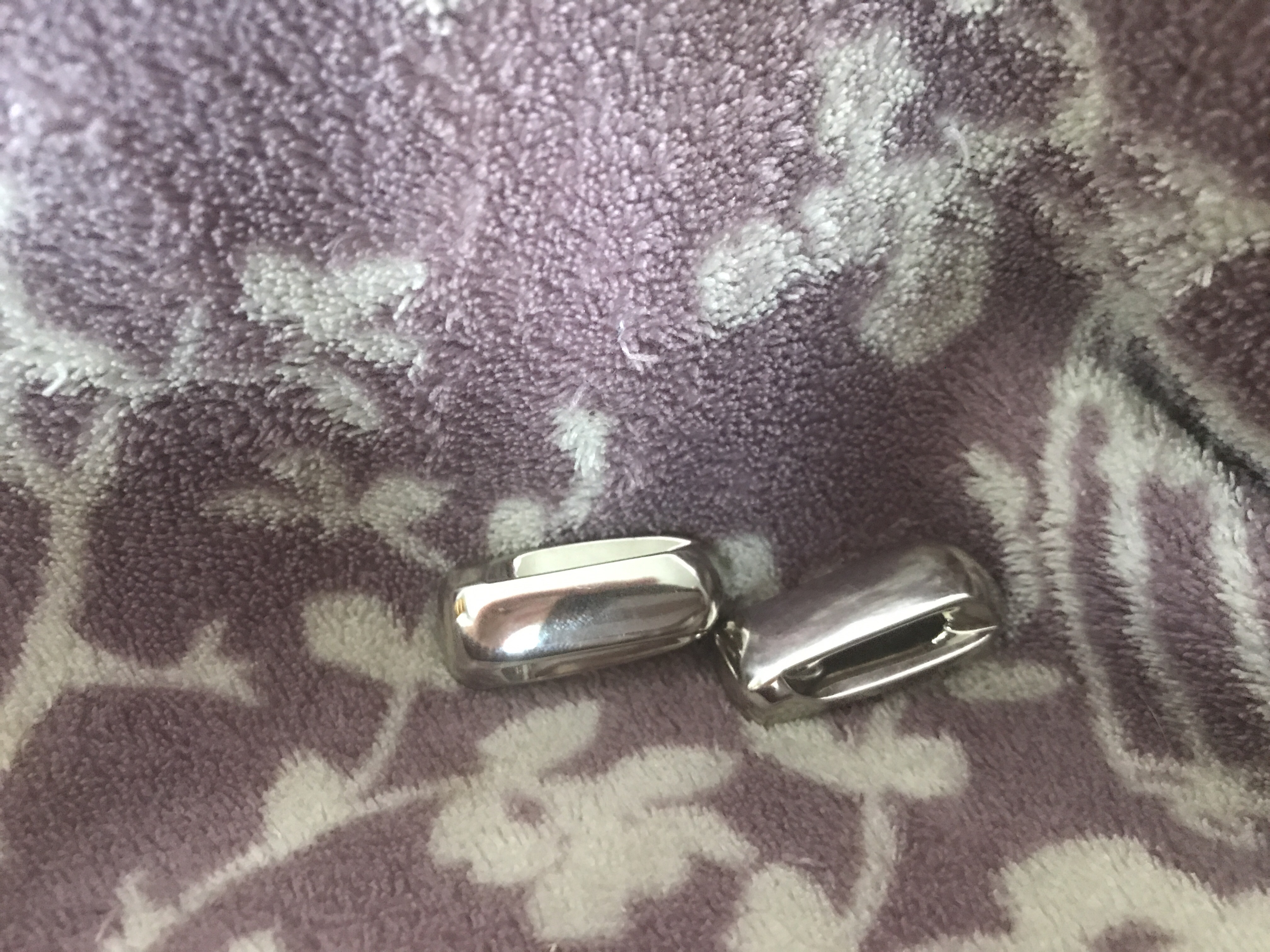

In other news, my chrome key ends have arrived :)
Now to find my tiny Torx set and get them fitted :D
