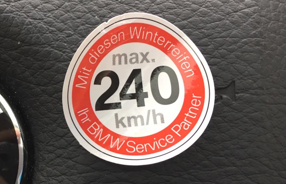

The Winter Tyre setting is just so you can set a 'Speed Warning' as required in some countries where you need a Sticker or Warning of Winter Tyres fitted and the Max Speed,. Limit to speed due to Winter Tyres fitted.
Edited by AwaoffSki
