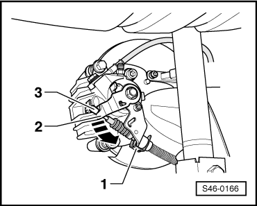

Stuck caliper levers, get back there with a wire brush and some WD40 and get 'em working.
You can probably free them without jacking the car or removing the wheels. (My Fabia did the same and took a minute to fix).
You will need a pair of pliers and some WD40.
Chock the wheels or put in gear if the car is not on a level surface.
Release the handbrake
Get down on the floor and look to the rear of the wheel calliper from the back and you will see the lever the handbrake cable attaches to.
See REF 2 in the picture
Spray a little WD40 around the point it enters the calliper (don't go mad you don't want it soaking the pads!)
Then wiggle the arm until it frees up.
Do the same to the other side and the handbrake should free up.

A bit of percussive maintenance and shock freeze seems to have done the trick.
It had seized on and wasn't releasing/auto-adjusting. I'll check it again tomorrow and possibly give it a splash more of WD40
