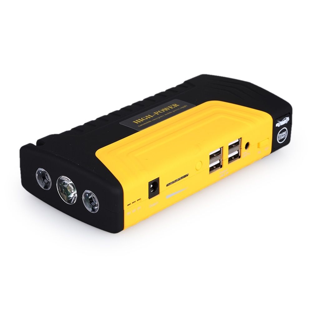

Much easier and smaller than a set of leads  these  Merry Christmas..

I did see this on a USA YouTube...didn’t know one could get it here
will defo investigate

Yes, that is the way things have gone or moved on to.  Plenty choice around - I've still got an old battery pack which had used to have a tyre pump and still has a feeble work light, replaced the battery once, it takes a "Hillbilly" golf cart battery - broken tyre pump has been removed and a sheet of plywood fitted in its place, so it solders on supporting powering up my new tyre pump and 12 volts high speed drill and any other emergency 12 volt power needs.

I have been looking myself at these newer versions of battery charge leads... The AA do them for around £50 (Via Sainsburys petrol station, recently) But you can eBay them for quite a chunk less although the quality and power seems to fluctuate somewhat! Perhaps find a good model/brand, then look for there best price.

Concerning...Compact Battery Jump Starters
these appeal greatly since some come with a compressor....so covering the cost of a footpump
i am now googling for the top models and ask if the team have any advice...usb and phone charging arent a problem if missing...but the torch is edit...scrub the compressor...those ones are too big

so...with a budget of under £100 which CBJS should i go for..

I think that, in my experience, you are better to dismiss the compressor included option as while they are very handy when they are new, a few years later due to their cheapness they have failed, I'll need to check up on when I get a free TV licence though!
In the absence of a "12V outlet" socket, I'd be looking for USB for phone charging, torch - again nice to have when new, but good to have a good compact torch to either have in the car or on your person.
I've no idea on who makes a good one at  a sensible price that will last for X years though, I would have thought that some car mags must have carried out a consumer test on them by now.

i know have looked a bit for straight car starting products...no compressor of course as you say
one aspect i found reading the one star reviews from users is that a lot dont have mains charging..you buy that extra if you dont want to charge from your cigar lighter....which you cant do if your battery is flat and the unit isnt at full charge...????
one which i asked about which was priced fairly good was the sealey SL 65S which charges from the cigar socket and a mains charger although an extra is out of stock
the money side...sealey SL65S £81.74 ebay and from sealey if available the mains charger which i cannot find the price for
but
the next model up the SL1s comes with charger and is astronomically priced at around 140-150 except one site which reads 120 incl vat
comes in a nice pouch and has both mains and cigar lighter and a multi usb charger cable etc...
another feature of some mini chargers is the cable lengths are shortish and are shown as being connected in some youtubes as to the dead battery terminals instead of the black to an earth away from the battery earth...
the sealy sl1s has 420mm connecting cables
