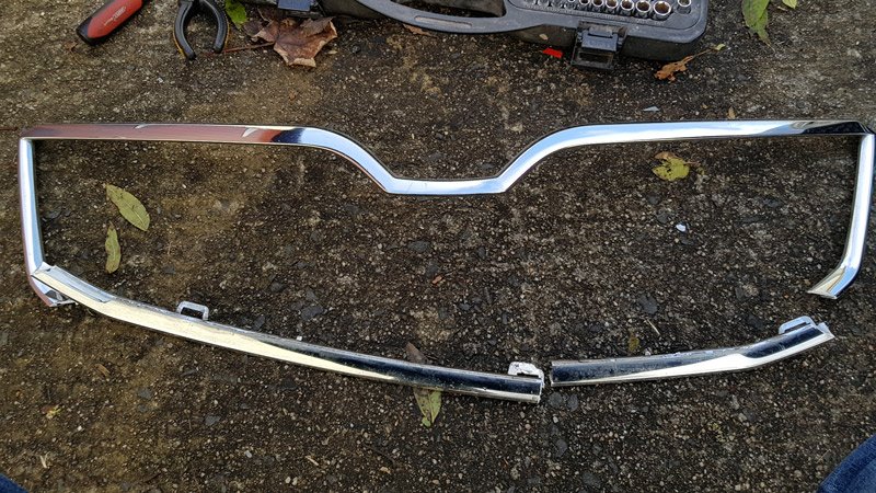

Done mines today, looks 10 times better, there is no way that you can get it off in one piece and to be fair I don't think you would even with taken the bumper off.
I took the 4 torx head screws out along the scuttle panel which Gives you a little more access.
Started at the top right hand corner, got it unclipped down the side of the light from behind using hook tools then had to apply some leverage to break the first top clip as this is encapsulated at the back so you cant get to it, the grill broke when trying to free the next clip so it was just a case of breaking it off In pieces, most times it snapped off right at the next clip so you could get a small sharp hook in to push that clip down and free it, bend the grill out and it snapped at next clip and so on.
Just be careful you don't leaver against the bumper or lights, lever under the chrome trim and you should be cool, need to be brave and go for it lol
Once chrome surround is off make sure there are no pieces of broken plastic in the holes
Grill pushes into place with a click at the clip points, job done
Took about 30mins as was taken time, now I know what to do take about 10 lol
Good luck
Edited by DeepblueB

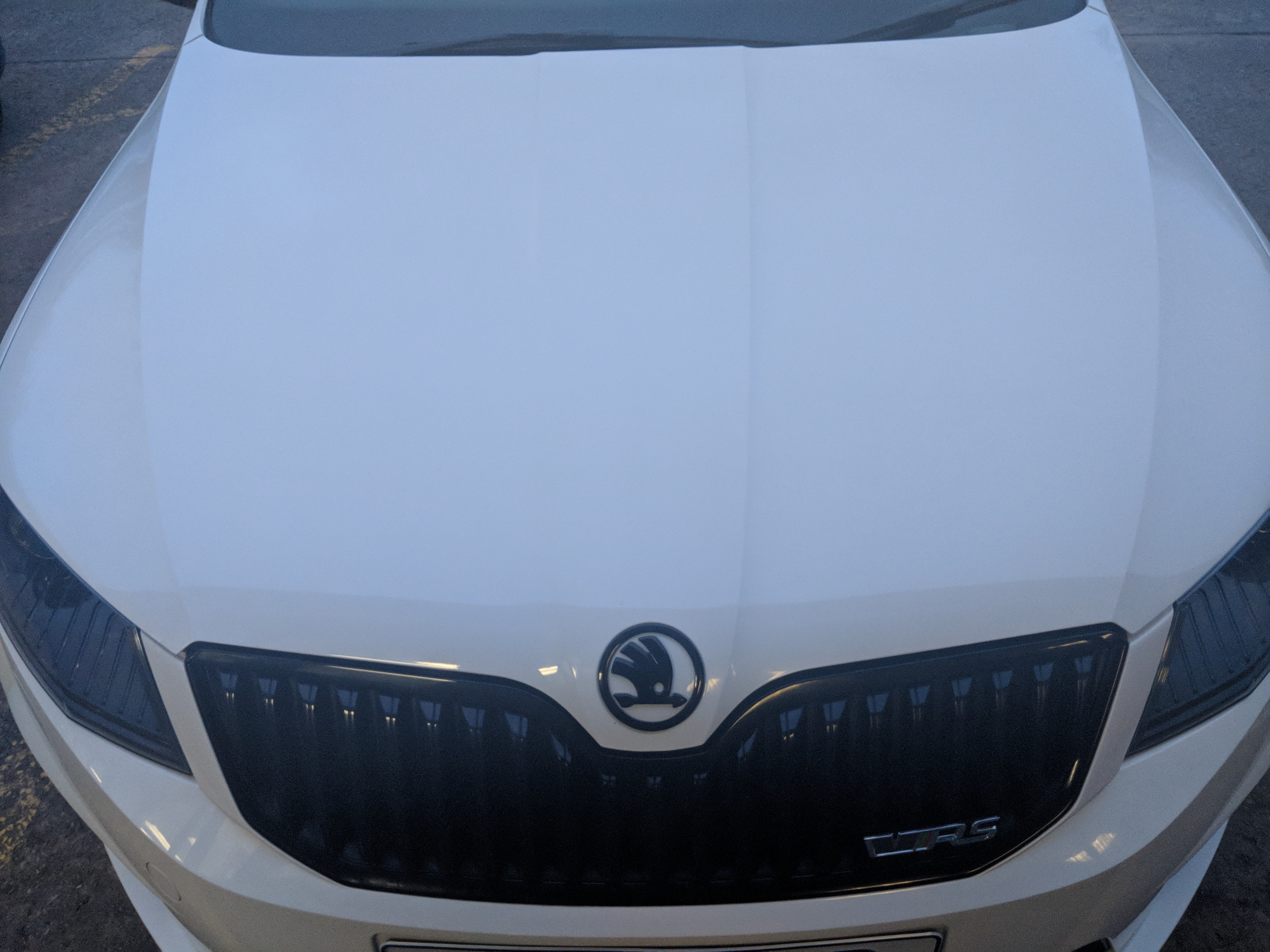

Pics
I assume it is easier putting the new one one then?
does
look better in black
Edited by Ballsy
Can confirm that it is a quick job, the chrome snapped in to multiple pieces and the new grille clipped in nice and securely.
I managed to complete the work with just a screwdriver for leverage and the correct head for the 4 bolts at the top of the grille for easier access.
Also... The chrome bits can be sharp when they snap. Cut my hand twice, fortunately I have a red car!

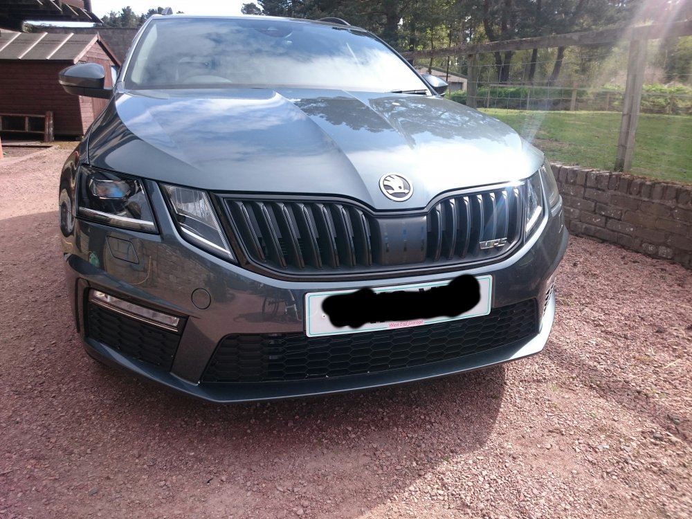

Hello, can't imagine you'll see this now as a fair few years old but do you remember where you got your trim from?
I also have a face-lift vrs exactly same colour as yours and estate too!
Thanks
