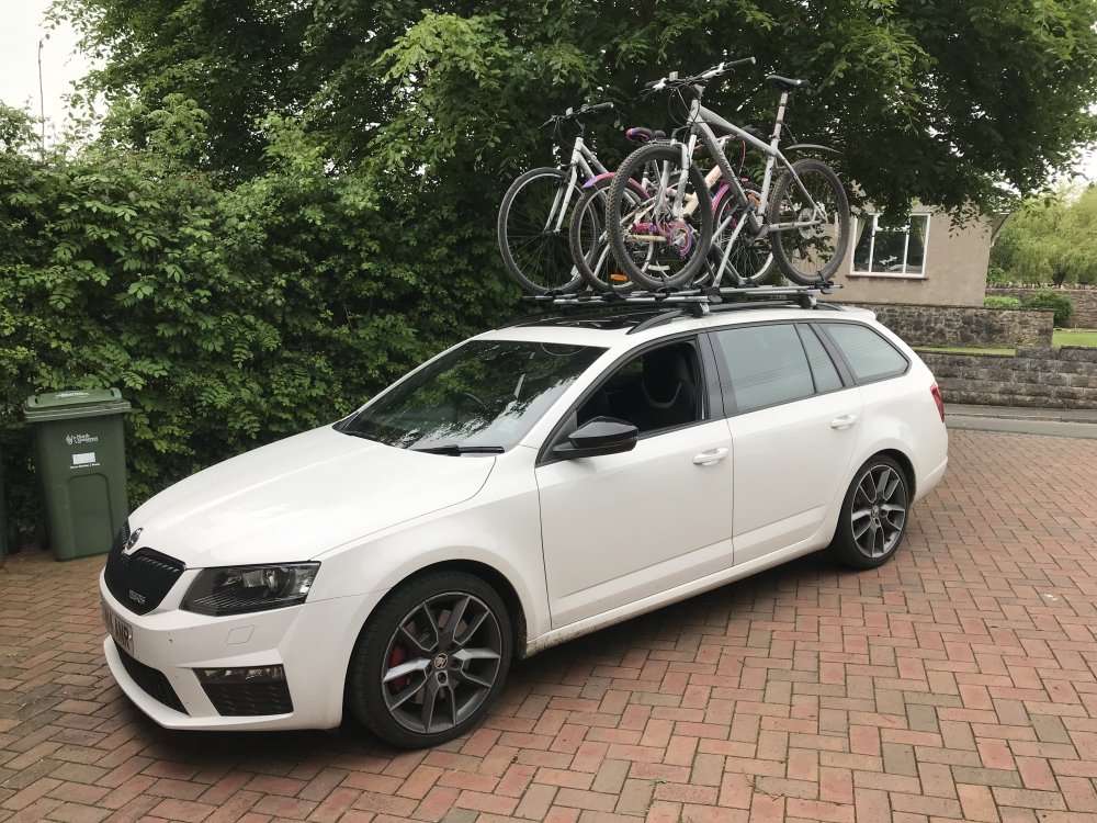

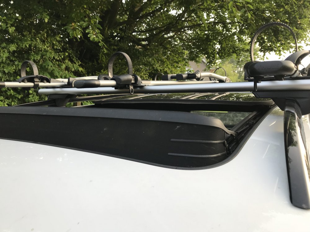

@grumpytwig Finally got round to fitting the bars & bike racks this morning.
They allow the pano to operate normally - result.
I have moved the front bar back a little from its usual position for the roof box and pushed the rear bars right back to avoid the fully open roof - the roof rails are closer together at the back, so it was a bit tight with the glass right back.
Couple of pics.

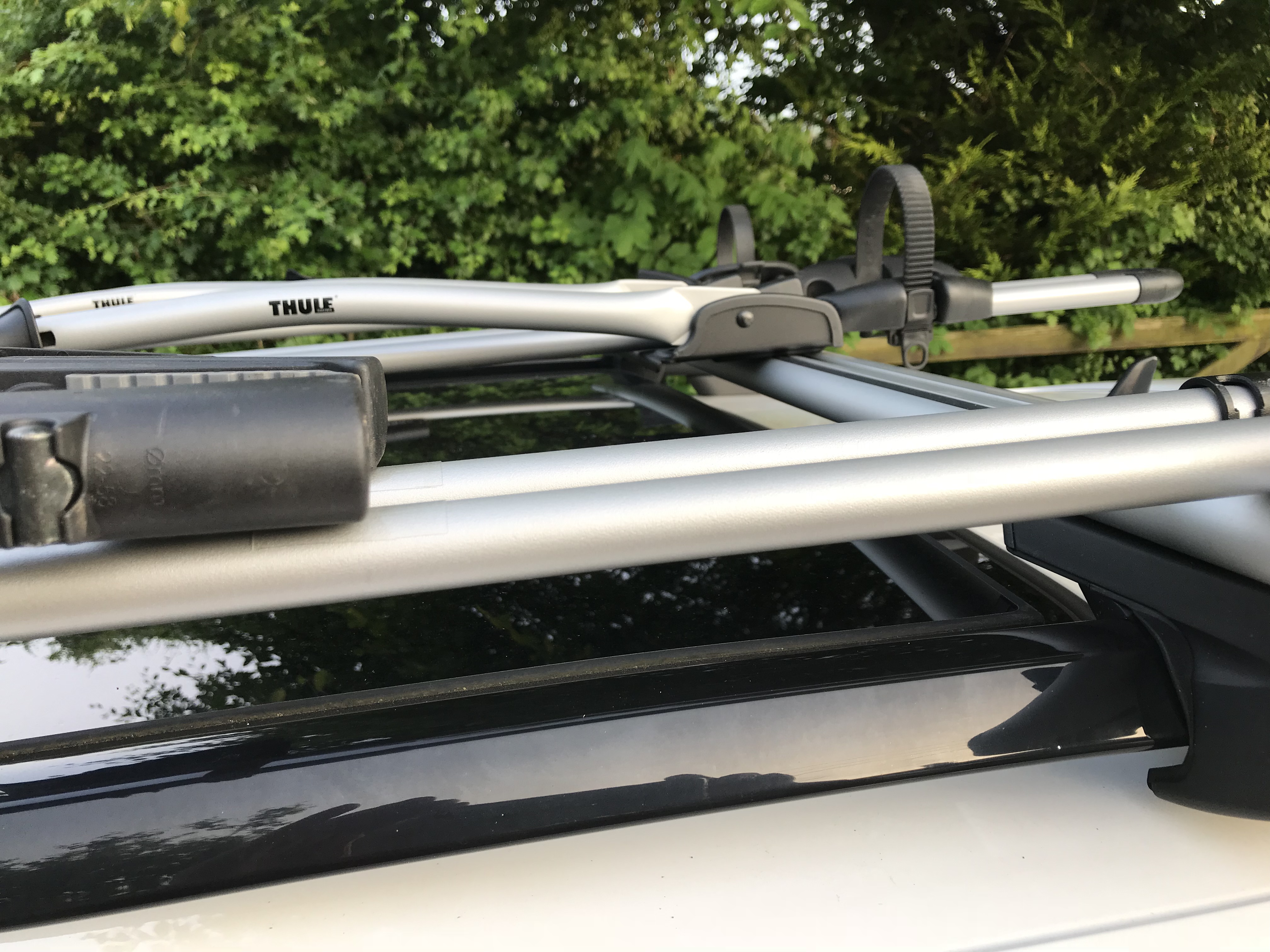

Have just been through this process. That's to the previous posters, made it a lot easier.
I've gone with the Thule rapid system 775 footing. They provide plenty of clearance. Sunroof operates as it always has.
One thing to note, with all the proride bike carriers on the roof, there is a lot of wind noise when the roof is open. It's not unbearable, but it's definitely there!
Anyway, some pics of the result. I think they look awesome in the black.

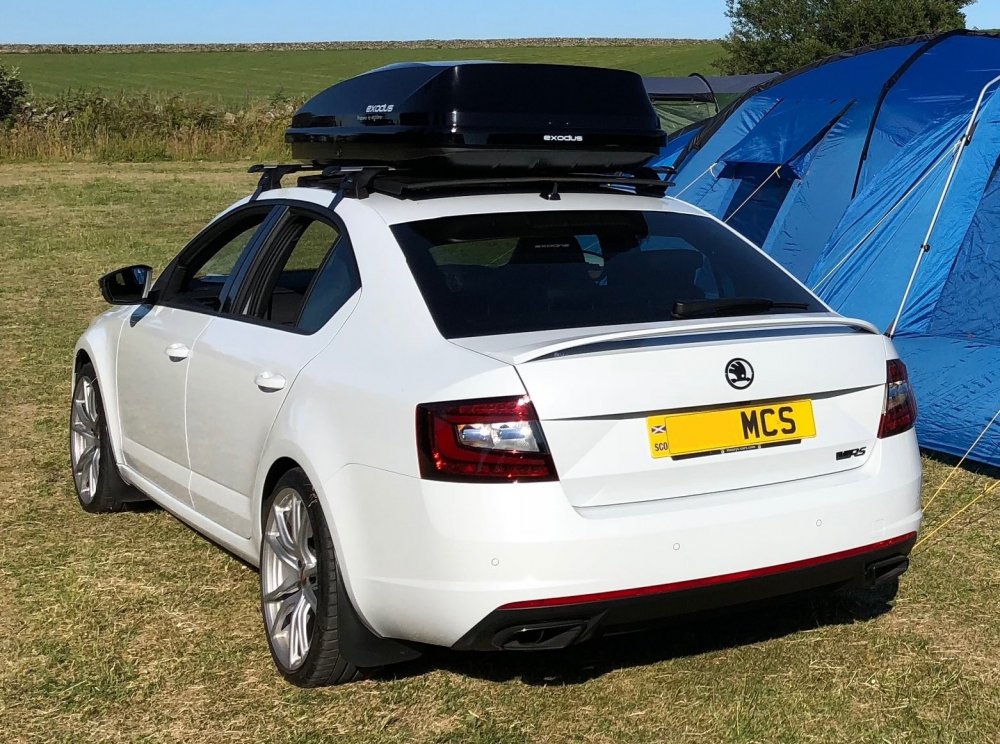

Here's the Whispbar / Roofbox / Sunroof combo on my 245 hatchback if it helps.
Sunroof opens just fine :)

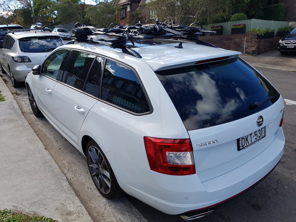

On 07/07/2018 at 14:04, Charlatan said:
So an interesting post script to this.  That middle bike rack faces backwards, which means there is a nice long flat bit that sits directly above an open sunroof.  Had some rain the other night, followed by a beautiful morning, so family loaded in the car, sun roof open and off we go.  First hard stop and the water that (unbeknown to me) had settled in bike rack overnight came pouring in through the sunroof.  Freak out ensued, but thankfully (by incredible luck) the water ran straight into the (thankfully empty) cup holders  where it was easily mopped up.
Anyway, lesson learned!  Oh, and its also a heck of a lot noisier up there with the roof open!
