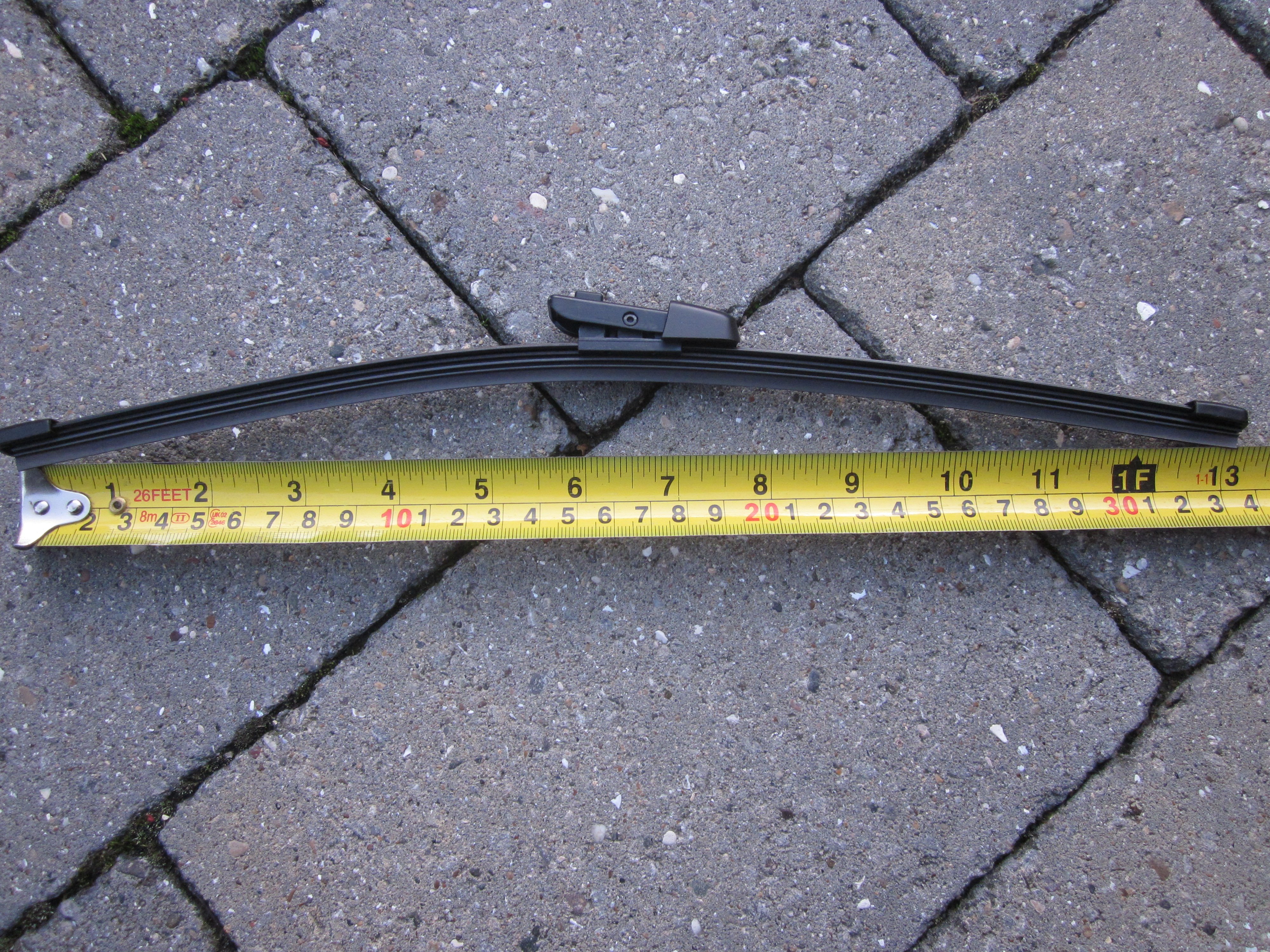

  • Just for you - at 2245h with ice on the screens.   630 530 340   aoproximately    ps - my front LH blade sometimes leaves a badly wiped area on the upper few in
  • 24”/600mm - AP24U - 3397006837 - listed for Octavia & many other vehicles - not Kodiaq   21”/530mm - AP21U - 3397006834 - listed for Fabia, Praktik, Roomster, Superb & more - not Kod
  • All those pretty pictures in the Snow thread but too cold to measure the wiper blades then!?
Rear wiper...

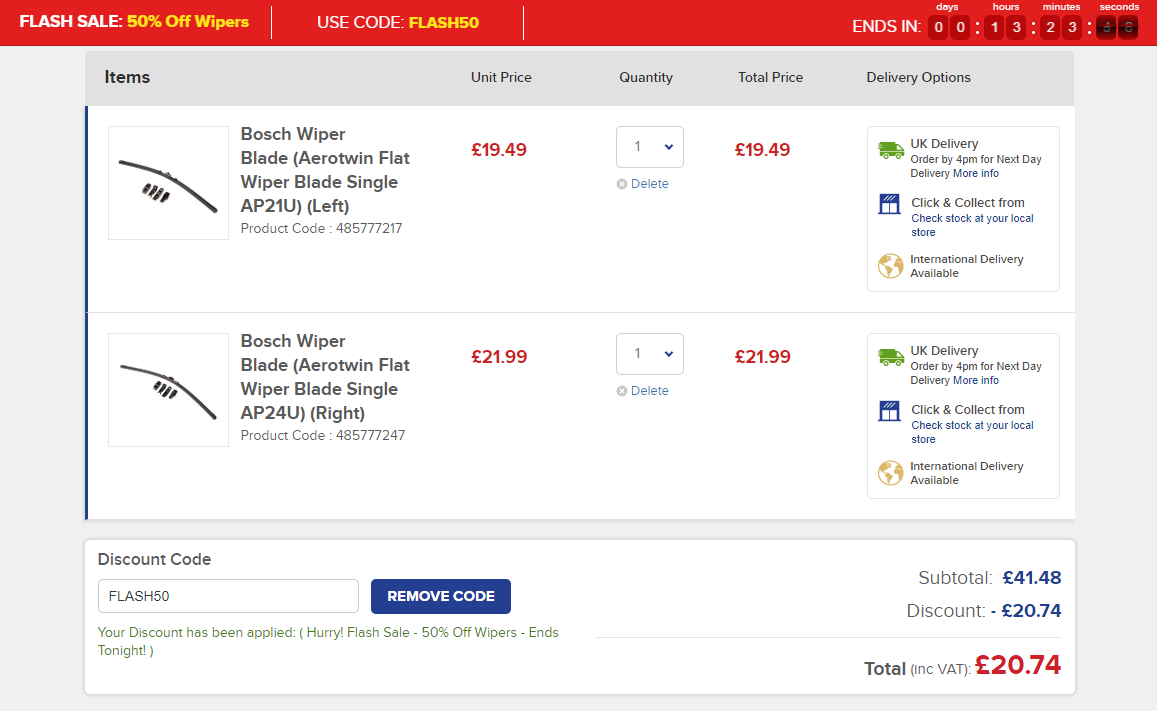

Euro Car Parts have one of their many sales on wiper blades until midnight tonight, 50% off...
The front pair and rear delivered for £28.48...
Or just the fronts for £20.74...

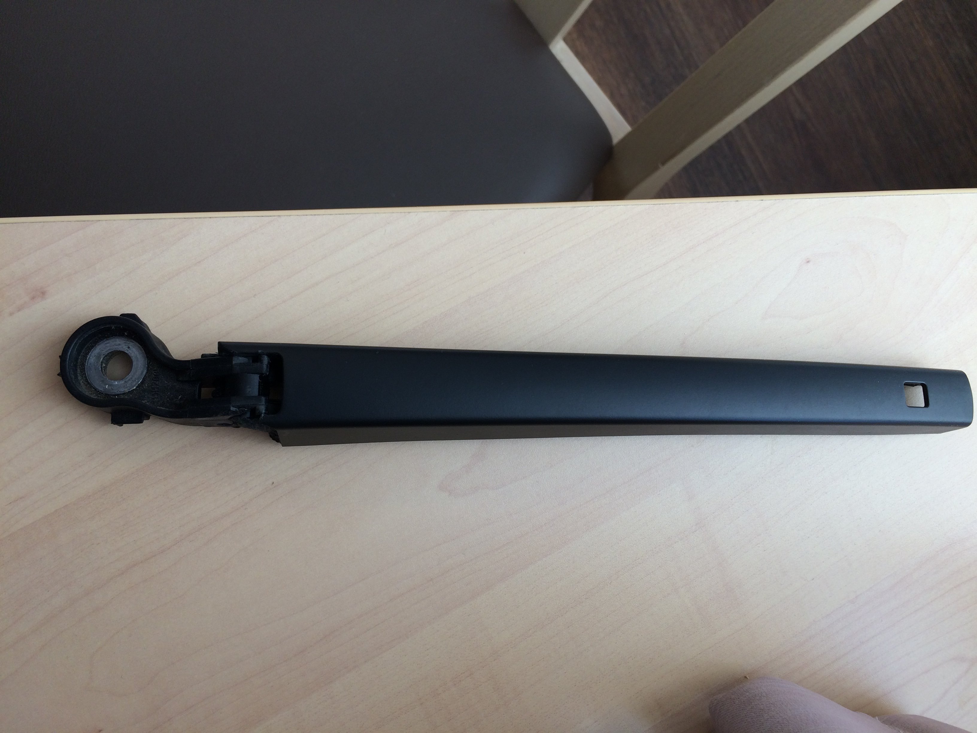

Last night a wee vandal helped himself (or maybe herself) to my rear wiper blade.
For some bizarre reason, the eedjit wrenched the whole arm up in an attempt to pull it off. Numpty. I hope they caught a few scratches.
Arm pulled out of pivot. Bits of plastic broken. Only retained by the bent spring. Bastid.
I decided to remove the arm completely to avoid inadvertent screen scratching in the absence of a blade. It’s a long way home.
’twas reluctant to come off the tapered spline. Not a touch of grease. Beware.

So my wee German vandal cost me a new rear wiper arm. £34 at my nearest dealer.
Part number 5G9-955-707
Fitted it with the old original blade which was hiding in the boot.

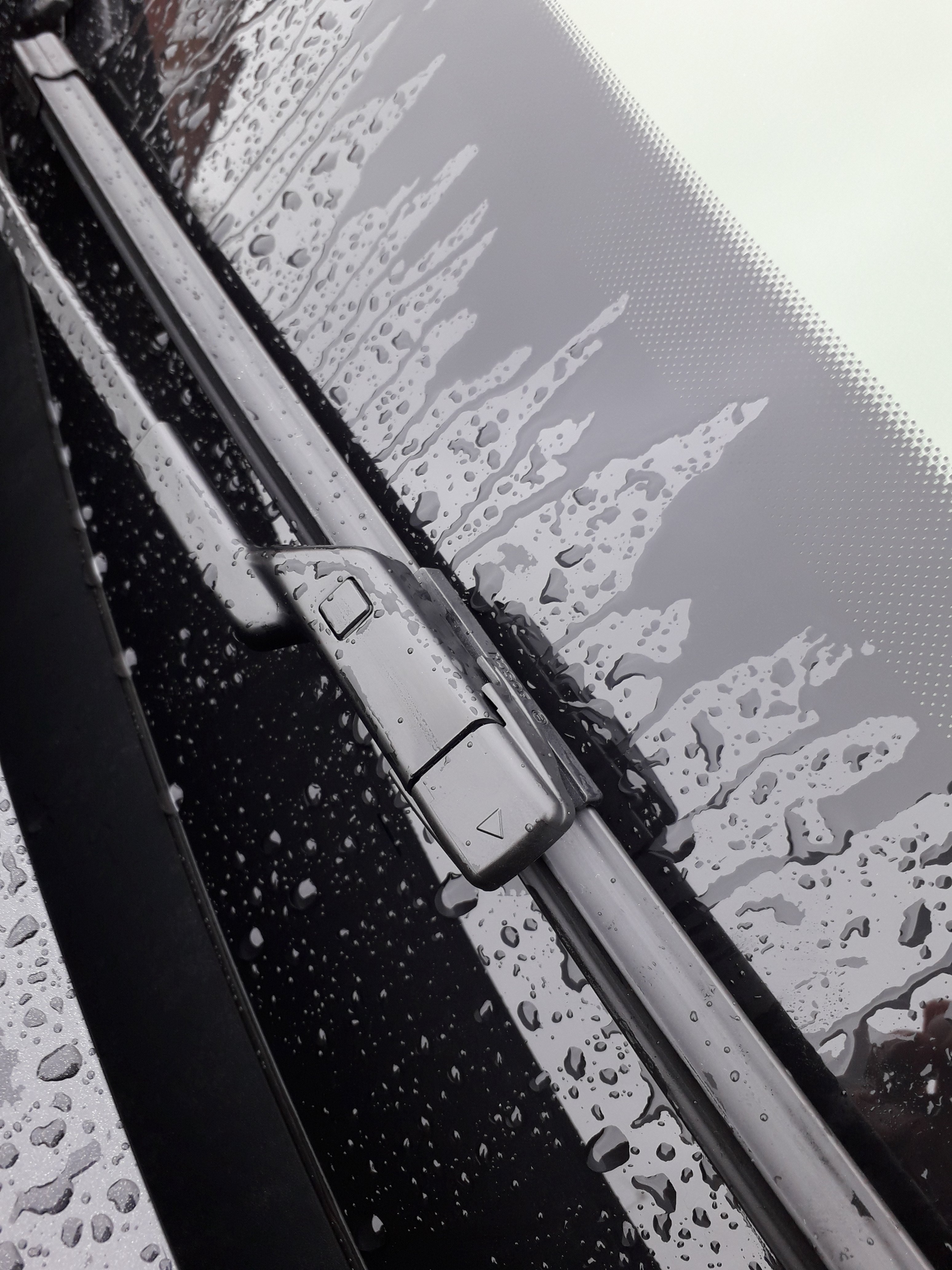

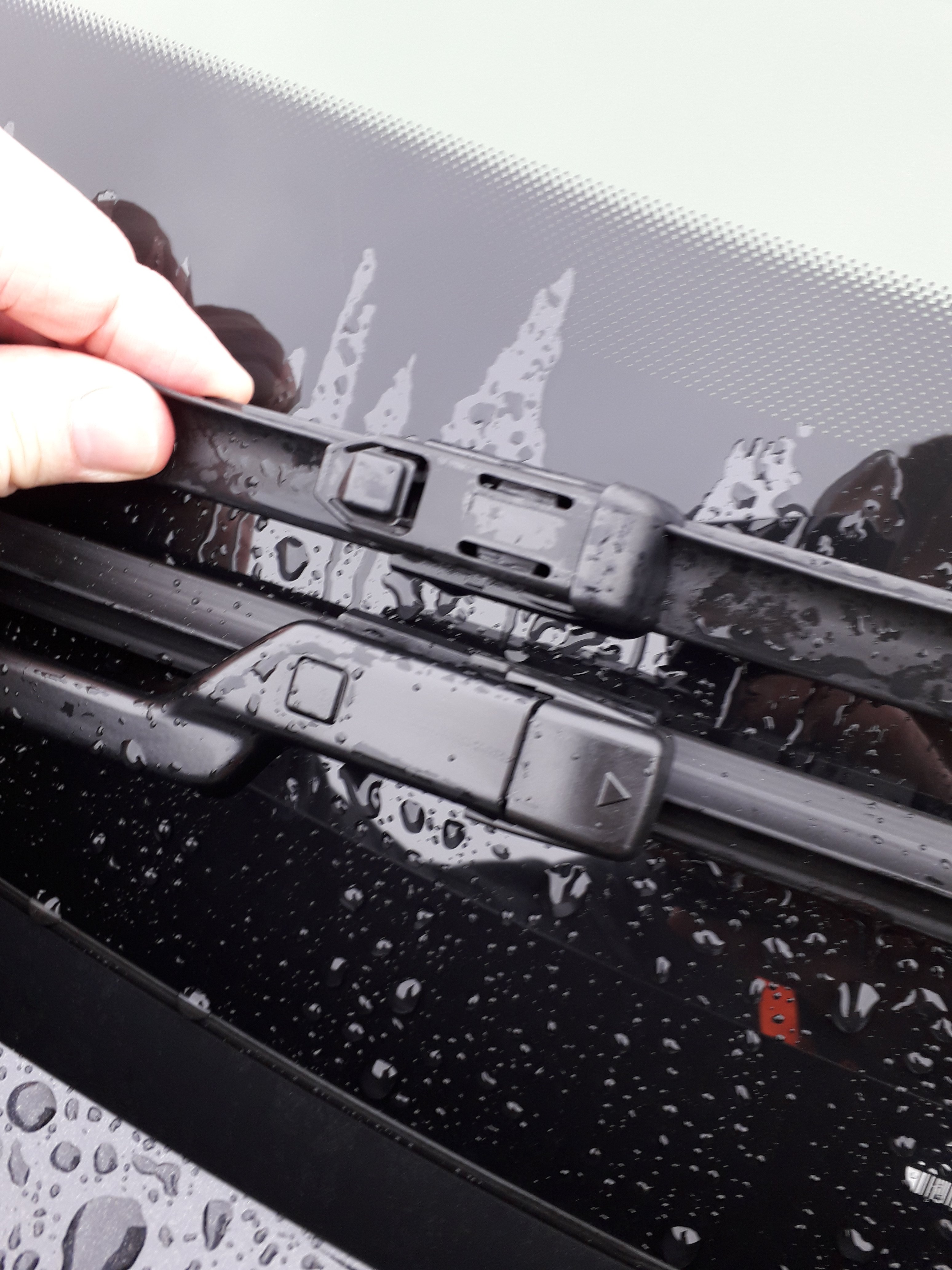

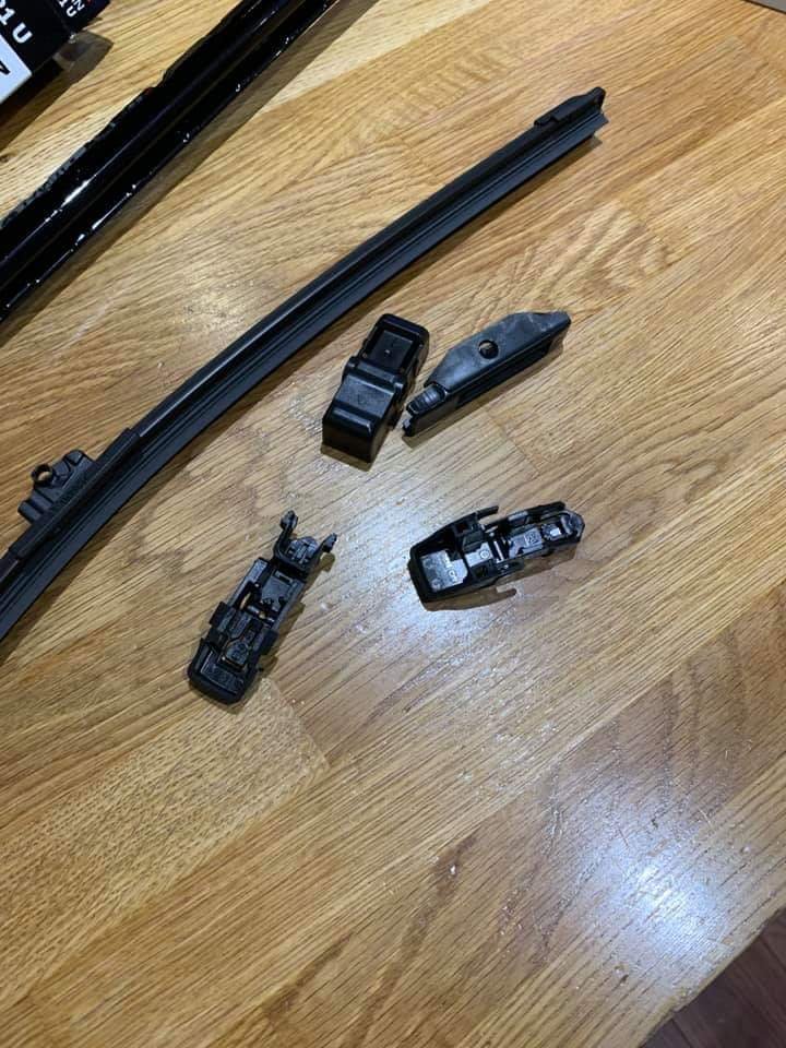

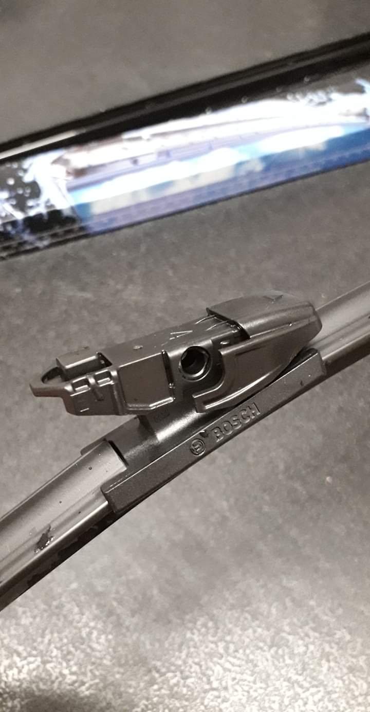

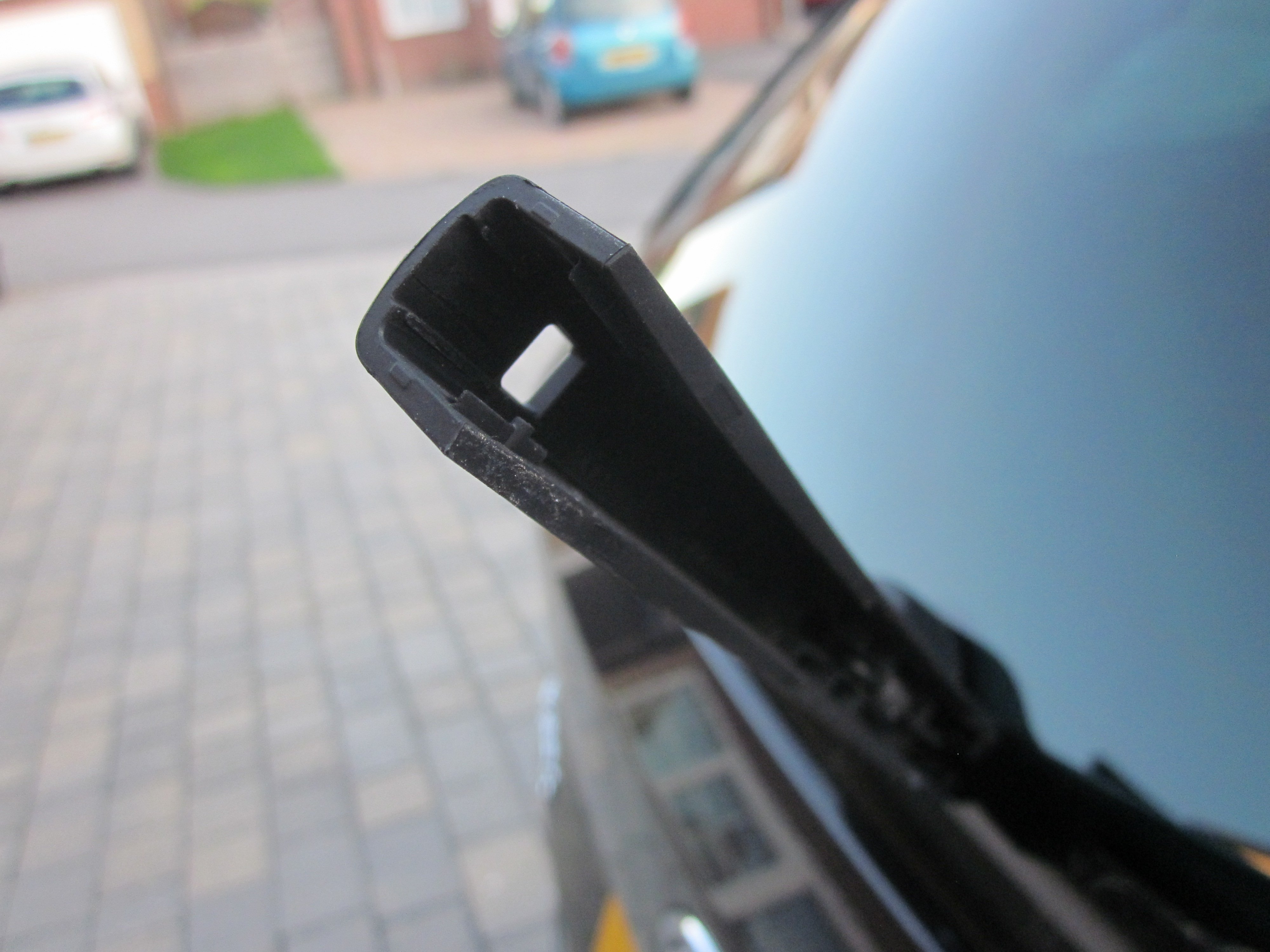

For anyone who needs wiper blades and has ordered the Bosch AP21U and AP24U then of the four adaptors provided in each box, you need adaptor number 4...

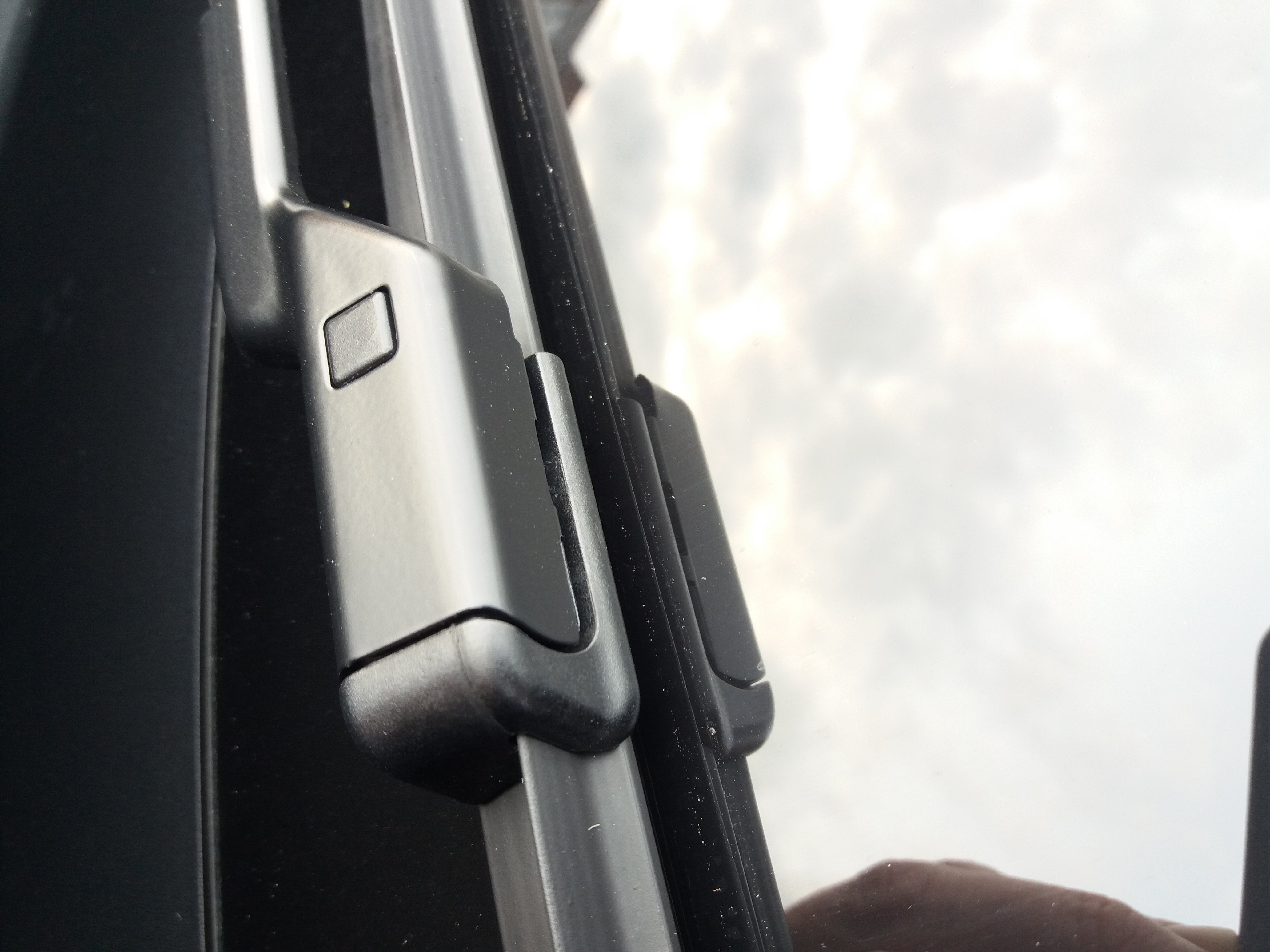

When fitted...
Old (original from the factory), in my hand, and new (Bosch AP21U) fitted to the wiper arm using adaptor 4...

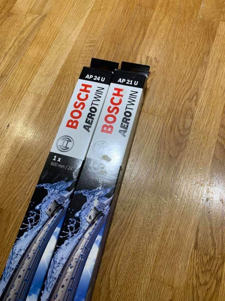

Will try Bosch Aerotwin Plus 65 + 53 cm next week. Seems to be pretty tight between two baldes when in resting position.
Edited by linni
Tested.
Bosch Aerotwin Plus AP26U
Bosch Aerotwin Plus AP21U
Bosch Rear A331H
First one is 65 cm blade, fits perfectly.
Last one is rear blade, 33 cm / 13"
Great, so the slightly shorter as well as the slightly longer blades both fit!
