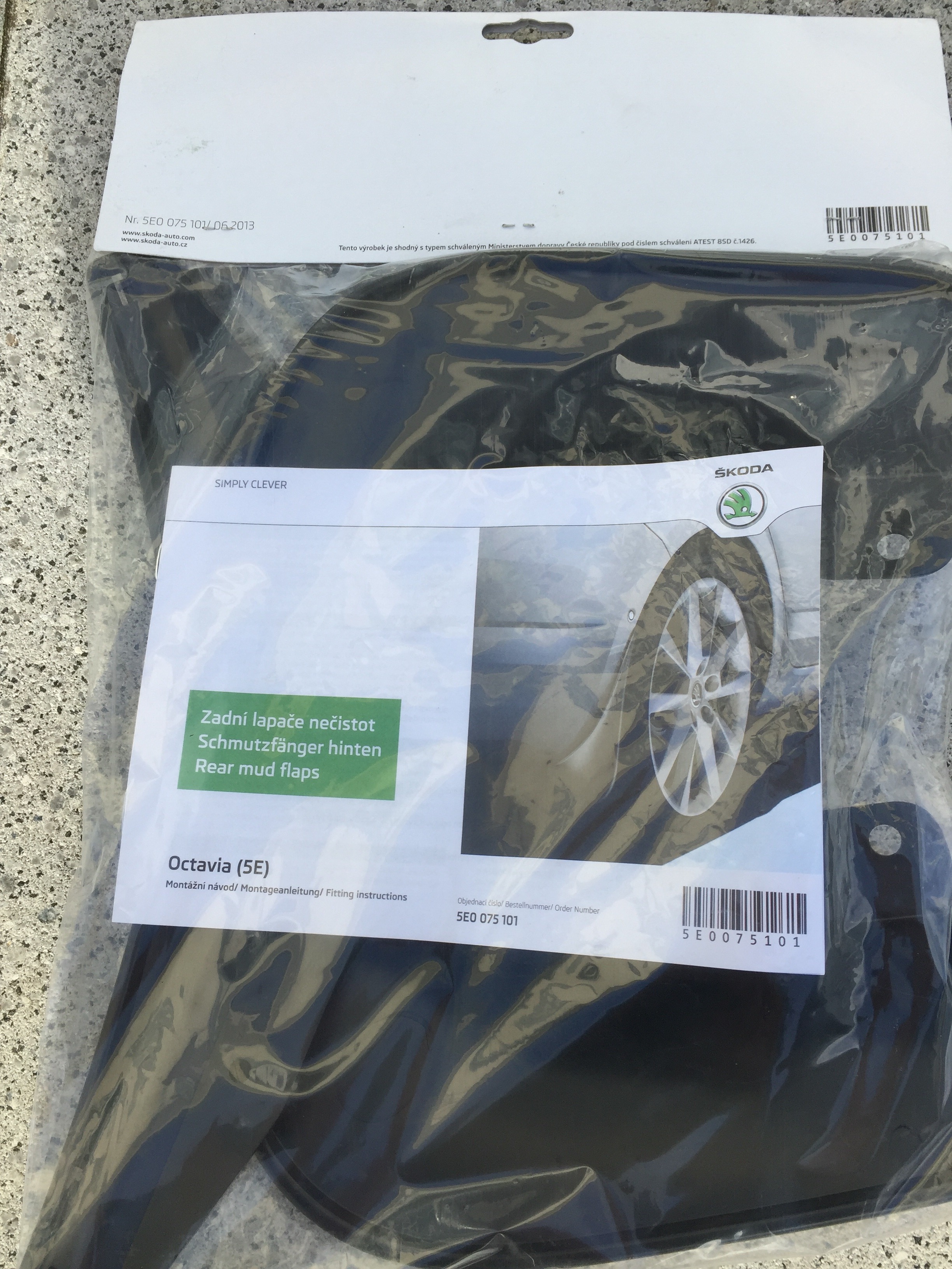

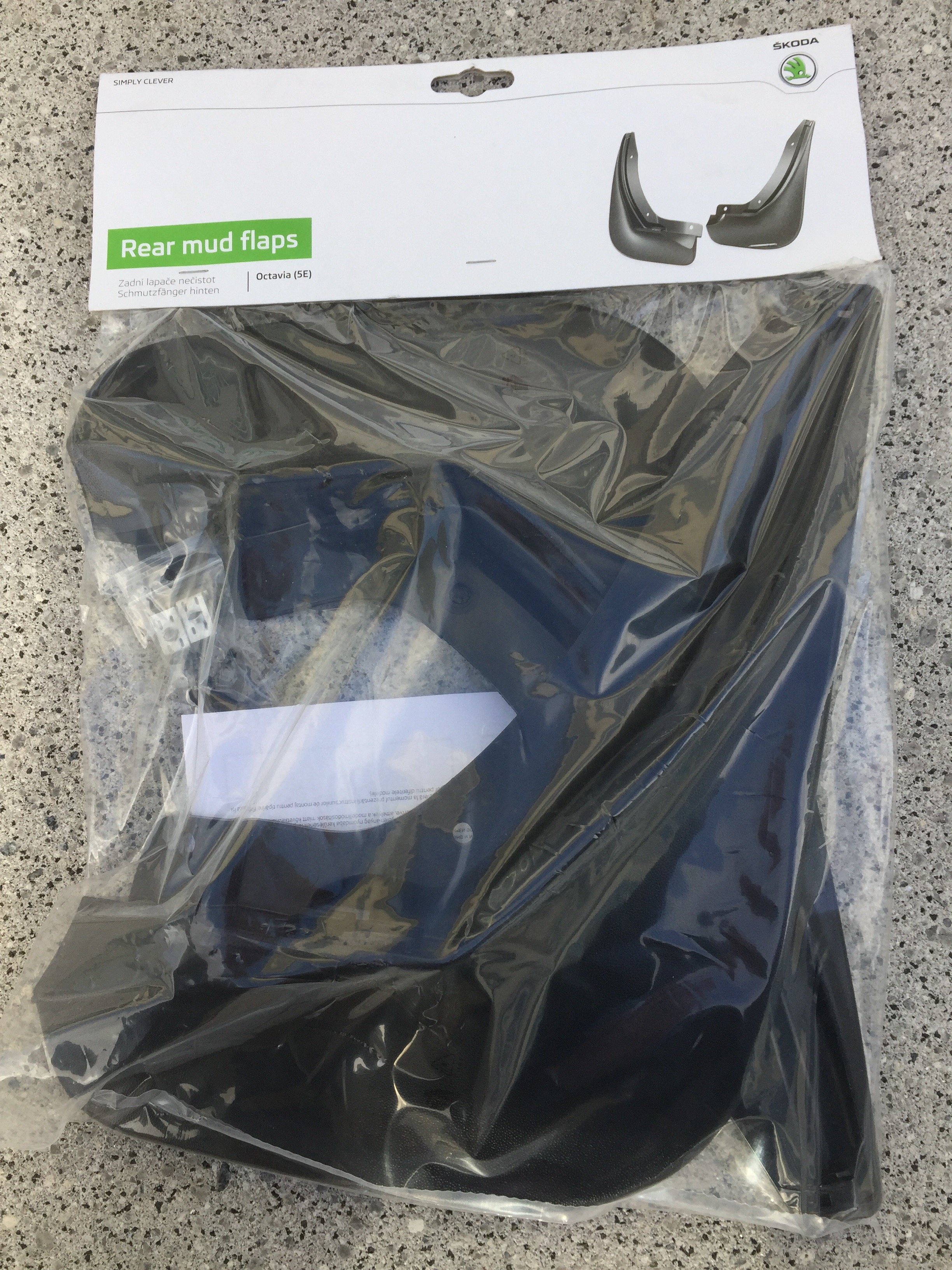

Stop! Don't buy those rear ones for the facelift vrs, they don't fit - the underneath screw hole is in the wrong position. I know I bought a set from superskoda, then had to order the non-fl version as they fit (I know sounds crazy!)
Thanks, so non-FL rears!
Definitely mate. Can take pics tomorrow if required. I've still got the FL rears (need to sell them!)  The FL part number for rears has got A at the end, you need part number 5E0 075 101 with no A at the end, these will fit

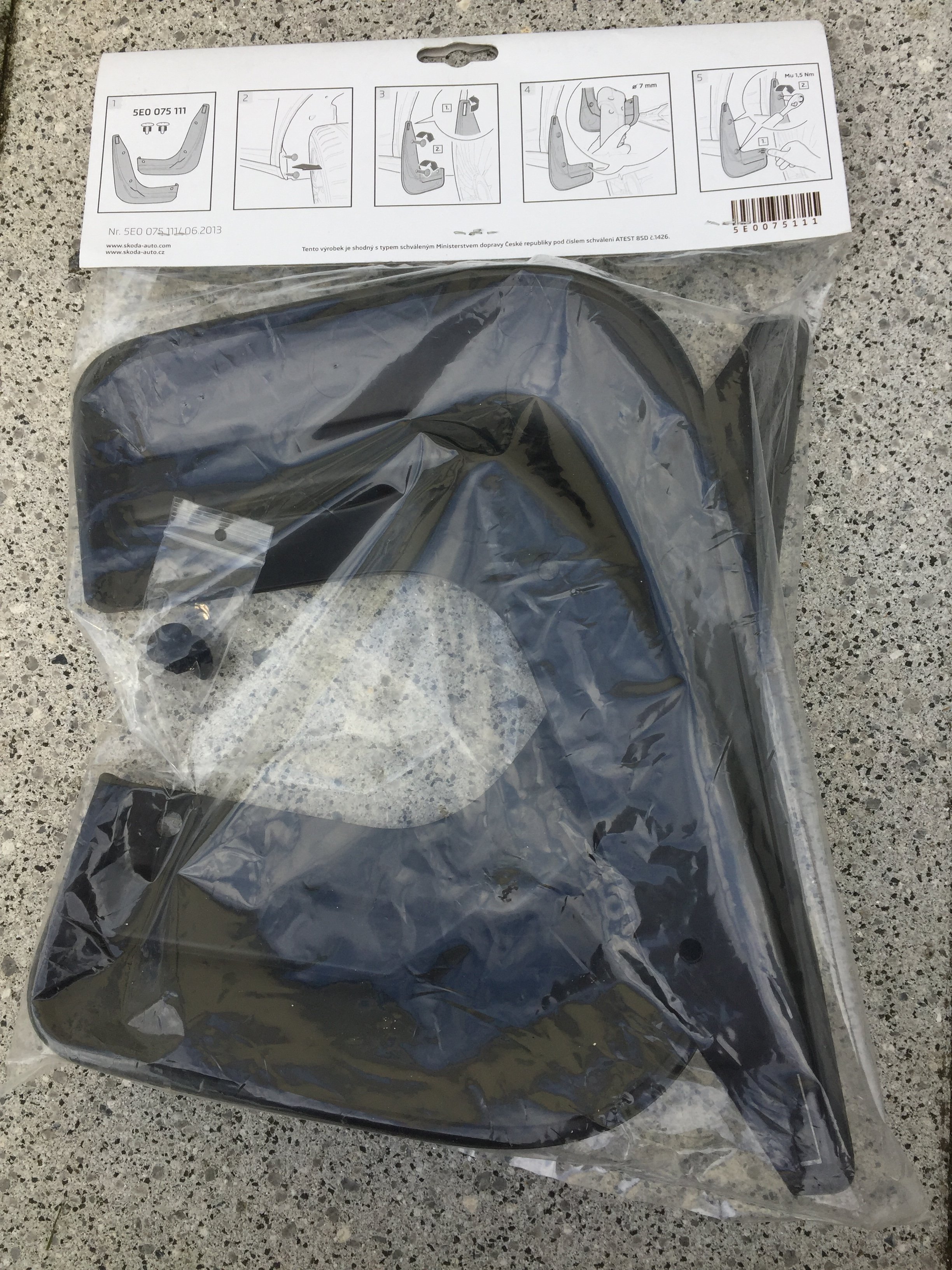

Do I need a fitting guide or is it relatively simple?
They come with instructions in the pack. Only had a quick look. Basically remove existing screws on wheel arch where mud flap is going then use these to fix the mud flaps on. Think the front need a 6mm hole into the wheel arch liner. Didn't get a chance to fit mine today. Lashing rain all day as soon as I picked up my car.

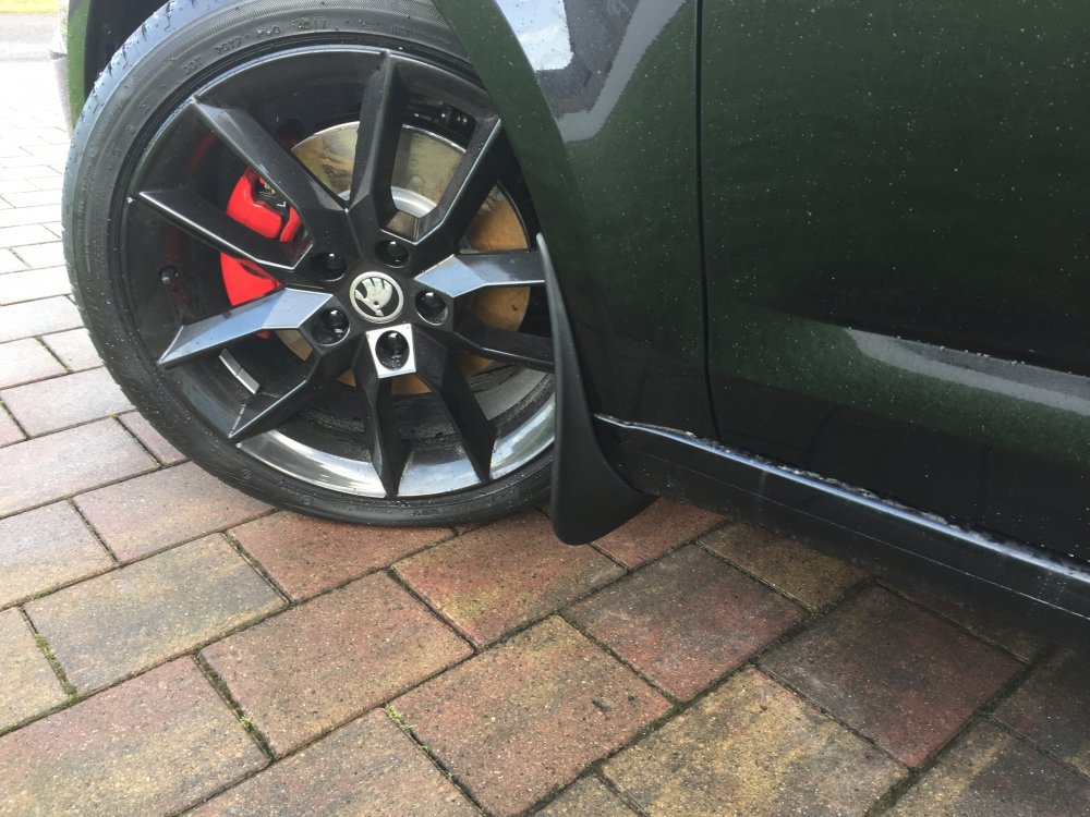

Are these confirmed as fitting the Mk3 vRS estate? I need some as soon as :)

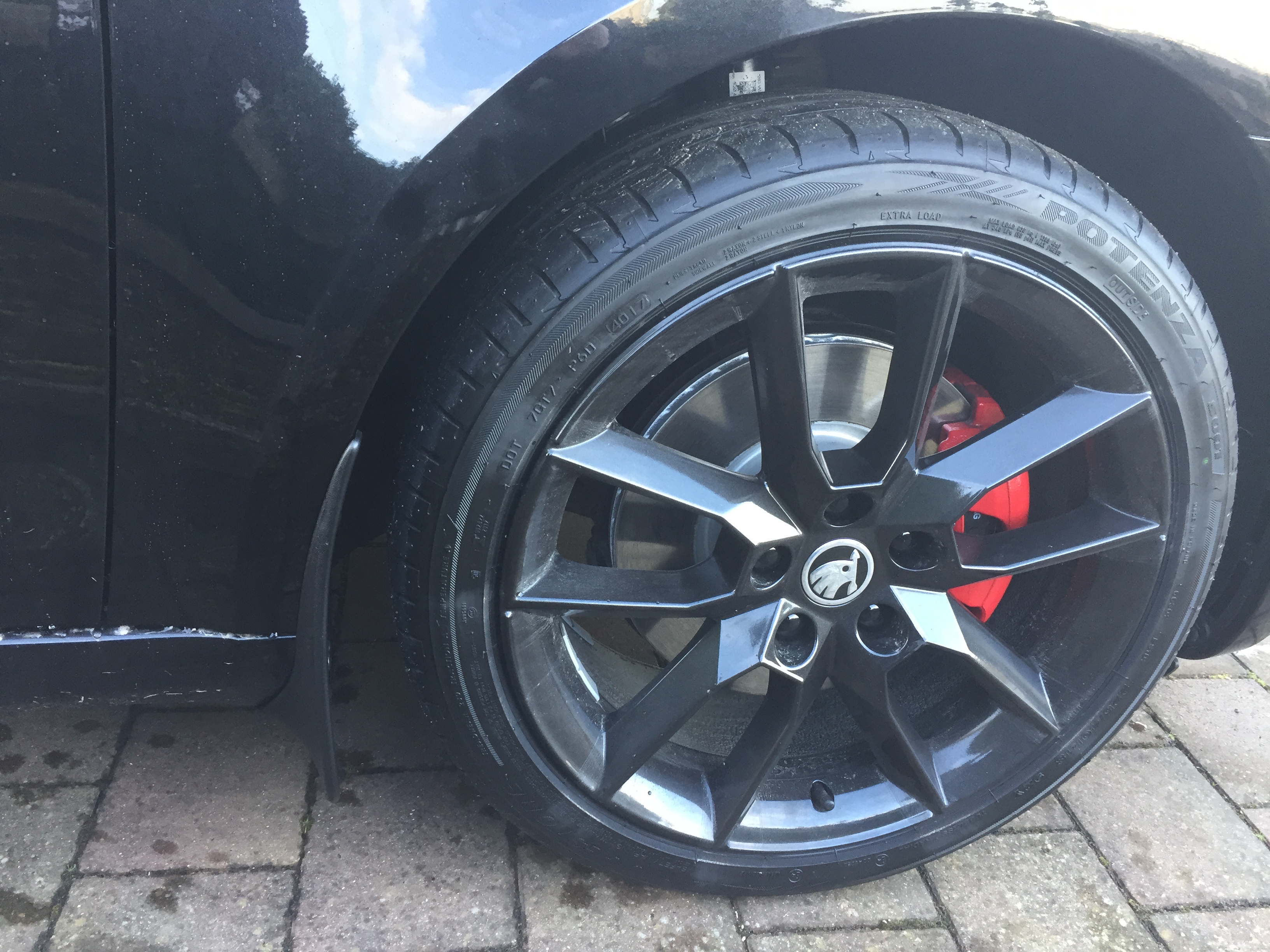

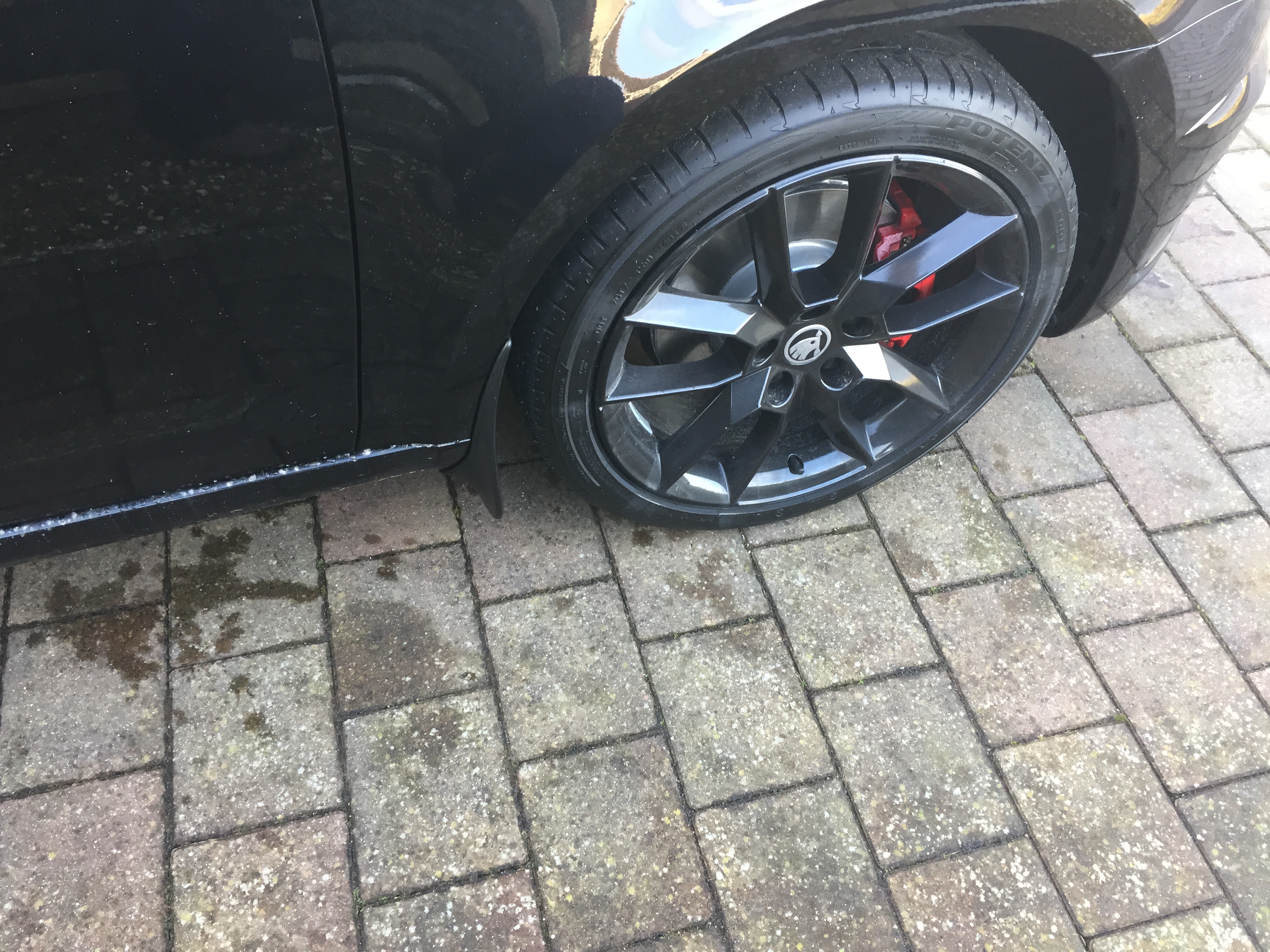

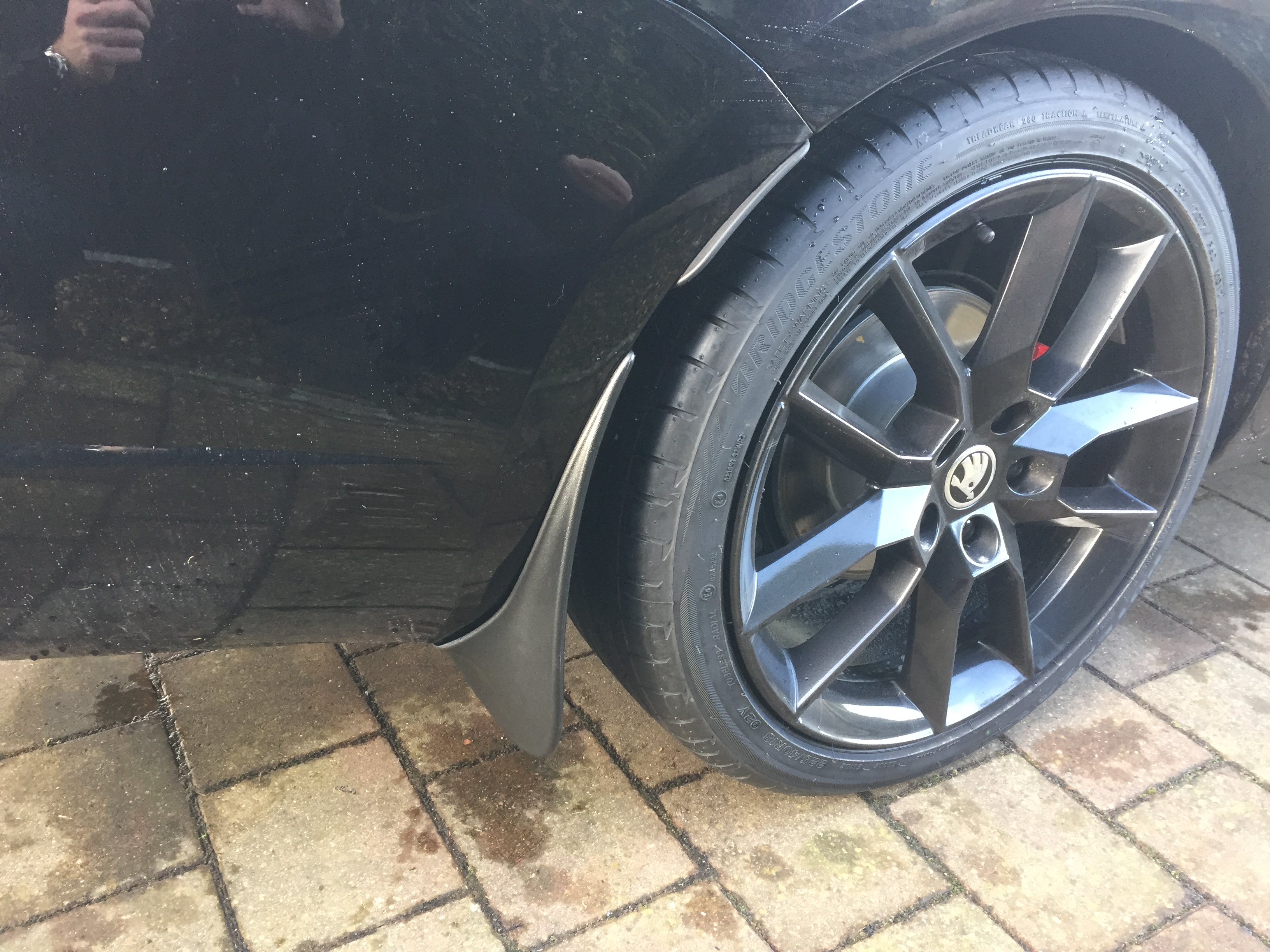

They fit mine:

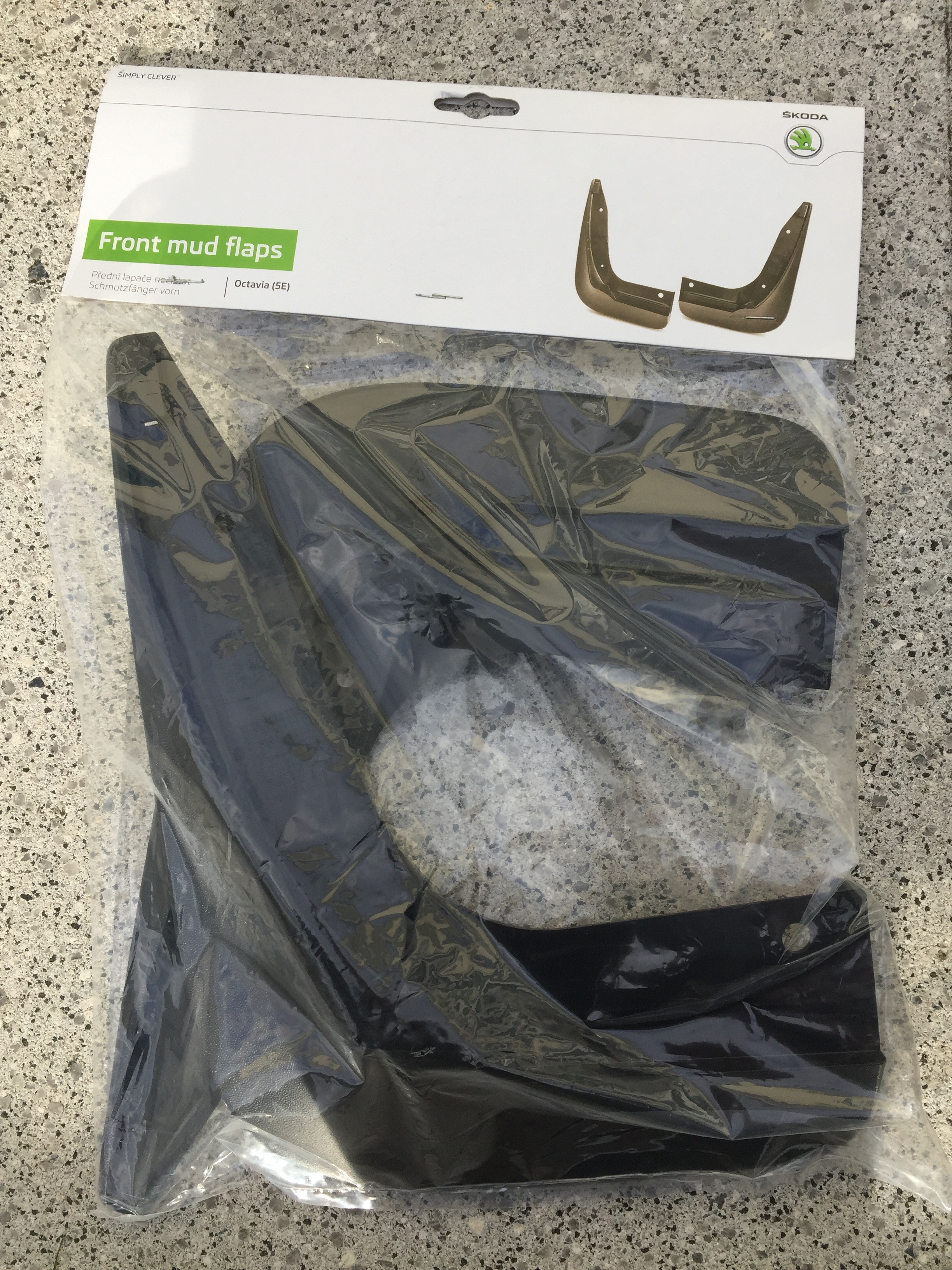

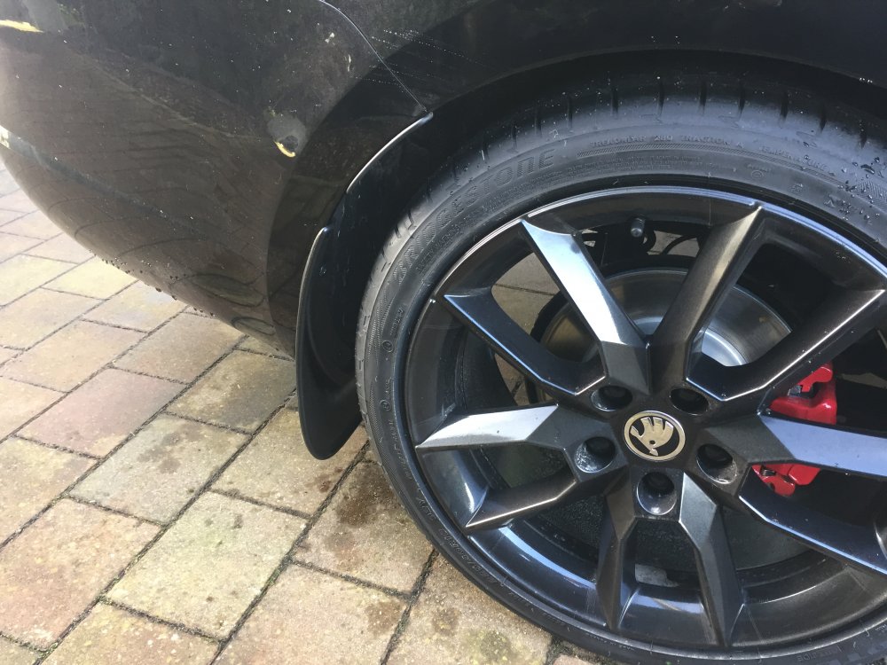

Rear done. 2 x T20 Torx screws to remove and 1x plastic Plug/clip. If you have a small ratchet you should be able to do it easy. I don't. So I just gripped the T20 Torx bit at 90° with a pair of pliers to undo the screw a bit then undo with fingers. No need to take wheel off. Front next when it stops raining.
My only concern at the moment is that the instructions show 2 plastic chassis covers under the car. I only have one. The one under the exhaust is not there. This is what the plastic plug/clip attaches to. So mine is just into the fabric wheel arch liner which seems a bit crap. The whole rear bumper on that side just moved around too much in my opinion. Does anyone have 2 or is it just 1 fitted???

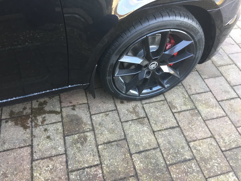

Front ones fitted. Full right hand lock to do right mud flap gives you enough space to do the screws and drill your 6mm hole into the plastic wheel arch liner. Opposite for left hand mud flap.
