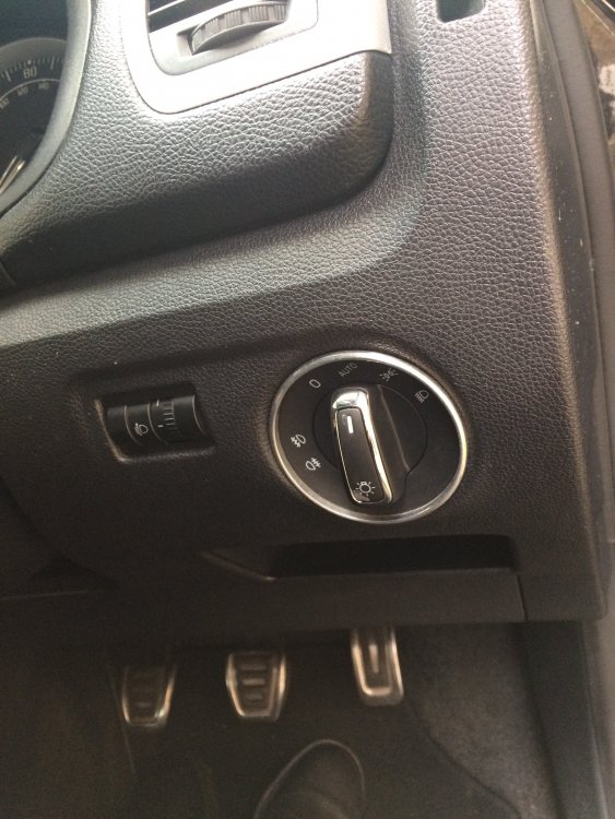

As you can lower the lights with the control next to the switch, you can set the lights a bit high and experiment with the in car control knob to find what you think is the right level.
Drive at night around on urban roads and check the dip cuts off sufficiently low to stop dazzling oncoming drivers. I also found tweaking the nearside unit toward the offside to be more centre of road rather than lighting up the footpath gives me a better hotspot/visibility on the road in front.

i never thought about that tilting switch next to the control...its at 3 sometimes...must get moved a bit when i put the key in or switch on the lights....
i will set it on 0 and set the lights a bit high...check

i made the mistake of somehow twirling the height adjuster to 3 over the last months and never thought to zero it
i think i will put a bit of tape on it to hold it at 0..or 1 whatever the highest position is
this might have been my problem to start with

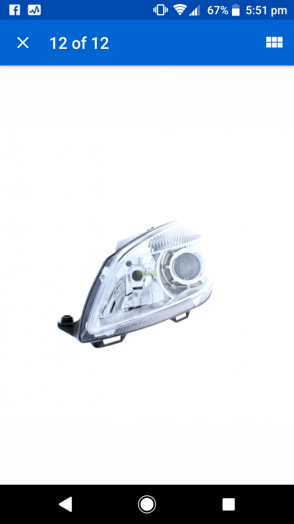

Thanks... This one has projector type fish eye lens and a separate main beam light, but the dip beam bulb looks a sod to change tbh
i think the one bulb which goes into the projector hole is the main headlight...wait for more info from the old lads here
the other light is the parking light and is a sod as some folks have pointed out...
with the single element bulb the dip is done by masking the bulb from the top via a little electrically driven shade...
i will watch this post to see if i have got this right...i know my fabia 2 1.4 has those shades...i can hear the shades lowering and see them on my garage wall
i was told all this was the way the projector lights worked...but you may have a later design..my fabia is dec 2008
cheers
geof
Mine is a different light as the lights changed from 2010-2015, this is mine with a separate main beam
Where yours is maybe like this?

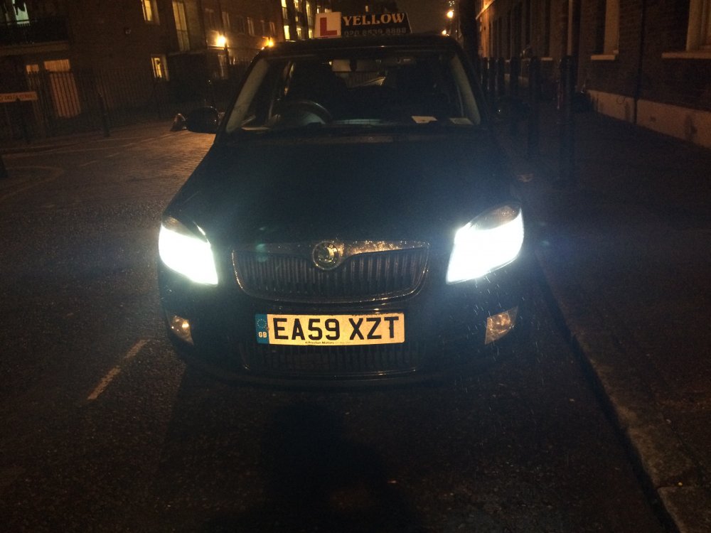

I got the ones with the "EYEBALL" on the inside as opposed to the later "EYEBALL" on the outside. I think MrCrow, yours are the same as mine...
Just fitted my LED bulbs, along with the replacement bulb holder... Very nice! Brighter, whiter light with more glow on the road and further along.  I am most happy with them and I was running Nightbreakers already so they must be loads better then "Normal" bulbs. I paid a tenner for the pair, which is a great deal and I may just get a spare set as I don't know how long they will live. The fans on them are very quiet in the box and off the car but are more noticeable once they are fitted as the headlights kind of act as a speaker of sorts. I haven't fitted the rubber covers back on though as I am going to replace those with ones with holes for the bulbs. Not because they protrude but just to help the cooling.
yes i have now seen the difference today in truro park and ride...4 skoda's in a line and a 2010 model next to mine...its obvious now
the fans on led bulbs lead me to think they get pretty hot...and then deteriorate otherwise
