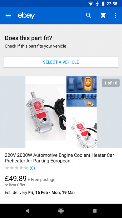

Most of these devices come with one built in. Not sure about the Skoda but think one of my old cars had a thermostat which closed off when cold so wouldn't have allowed circulation round the system unless at operating temperature. Might be wrong about that though as I haven't thought much about coolant systems in recent years. Any idea about that on the Superb?
The better devices have thermostatic control so they shut off at a certain temp, usually 65-70 C or something like that, and some won't turn on unless it reaches a certain cold temp either. some come as kits and others just the heater that you have to wire in yourself. You can get drive-off connectors that disconnect safely if you forget you are plugged in!
Most are between 1-3 kws. Obviously the larger ones heat things up quicker. The biggest potential issue is space - I have not looked yet at what space is available as obviously you need to connect the devices in line in the coolant system. Would be good if someone had already installed one and could comment!

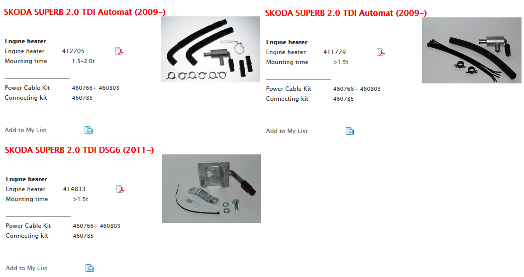

One of the heaters I'm considering is from Defa. Here is their manual and it has some data from tests they did near the start using their coolant based heaters:
https://www.defa.com/content/uploads/Documentation/Downloads/Technical-information/Electrical-preheating/Technical-Handbook-EN.pdf
Not independent of course, but at minus 20 they claim this reduces particulate emissions by 15-30%. They also did the test at minus 10 and 0 but there's less data. At minus 20 fuel consumption 8-12% lower (I think over the entire test journey). It appears the first 2 km is where the biggest savings are made, with an example 1.9TDI engine reducing particulate commissions by ~30% at 0 degrees.
But they don't do a validated coolant based heater for the Superb though, not the 2.0 diesel CFGB engine anyway. The only validated heater they do for this engine is an oil pan heater, which you stick to the oil pan so it's easy install and it heats the oil. it's lower wattage than the coolant heater and I expect it is less efficient. From what I can ascertain from other users it increases the engine temp about 20-30 degrees from around 0 C. Is that worth bothering with, I don't know.

I spoke with Defa but only the contact heater is verified as suitable for the CFGB engine. They say this might be because some cars engine management sensors get confused when a coolant system is installed. As your link shows the coolant version did work with what I think was the older 2.0TDI engine version. I doubt there is much difference but maybe there is. Thing is, I wouldn't want to go to the expense and hassle just to find it upsets the car. The contact heater is an option of course but it is not as effective.
