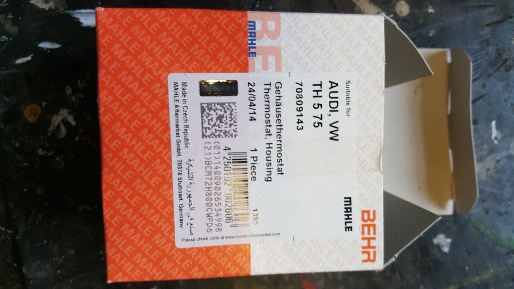

back on topic, Defa got back to me and very helpful explained the following:
"On cars with DSG gearbox there are an oil cooler on the top of this. In the hose who’s go into the cooler there are a thermostat, this will not open before the water is hotter than we can make in the system. Therefor you can’t use a hose heater"
Does anyone know what the temp rating on the DSG thermostat is? Anyone got a diagram of where it is?
Underneath beside the battery another common failure on these I am sure the opening temp is 75 as stated on the box
When it fails the indicated temp on your mdf stays about 75 instead of 90

Thanks DEL80Y that's super helpful. 75C is a pain because most of these preheaters can reach a peak of 65 or even 70 but I haven't seen one that achieves 75+
I found a VW workshop manual for a golf that has instructions for installing a coolant pre-heater but the 2.0TDI isn't listed and this will be why. Doesn't look likely that this is possible then. So it'll be a contact heater, webasto or PTC.
