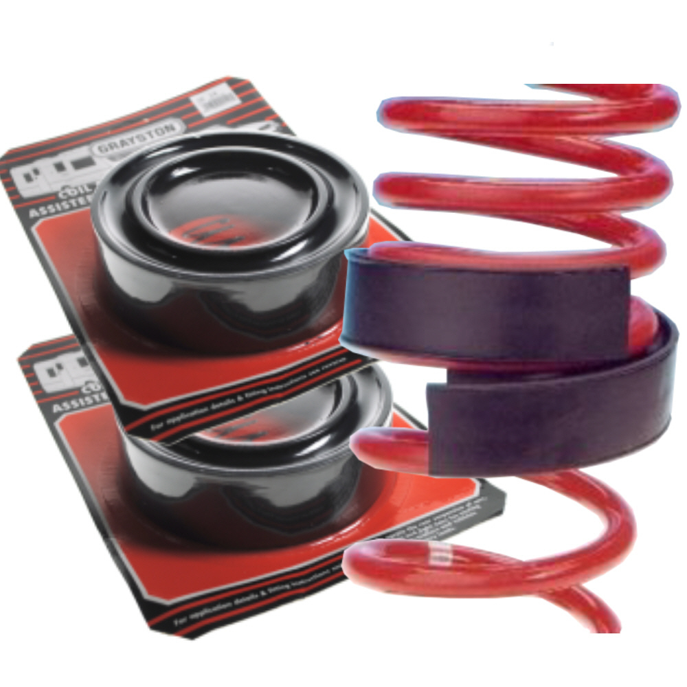

Much Cheapness.
Graystone spring assisters.
bit confused, how is  adjusting ride height going to improve weight distribution? to be fair the rear doesn't look that much lower than usual, not a noticeable difference like other cars I have kitted out.
I'm starting to tow a caravan with my vrs est but with only a 75kg noesweight I'm thinking about fitting mad spring helpers.has anybody fitted these
