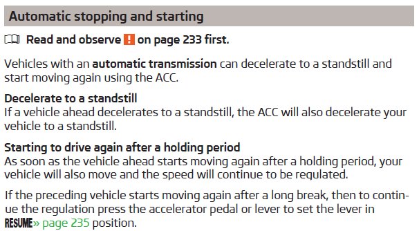

46 minutes ago, MorrisOx said:
The other point to bear in mind about ACC is that it doesn’t work below 15mph, and I suspect the system will begin to struggle as it approaches that threshold. So it will always ‘lose lock’ in motorway crawls - though it should tell you when it disengages. If it doesn’t, that’s a poor design.
My car has DSG and ACC will bring the car to a stop and set off again in traffic jam crawls, often below 15mph.
Edited by Fatso
It will if you have both DSG and lane assist because you can set it and it will operate as Traffic Jam Assist (that's what they market it as) and it will follow the car in front, keep in lane, stop/move again, etc.
I don’t think that’s ACC at work - Skoda states quite clearly that ACC can ‘...maintain a constant distance to the vehicle in front at speeds of 15mph or more’.
Yes it is using ACC - how else do you think it detects the distance to the car in front :)
But not on its own - ACC alone doesn’t have that functionality according to Skoda?
I don't have lane assist, just ACC and DSG.  It works down to 0mph and when stationary says something like "ACC ready" in the display. When the traffic starts moving, just tap the accelerator and it's off again.
Does this help?
Traffic Jam Assist and ACC both use the same radar to maintain a distance or speed from a vehicle ahead.  If the road is clear it will hold the speed, if not it holds a distance at the current traffic speed if that is less than the speed setting.  Traffic Jam Assist will not function without the ACC being on (whether active or not).  Lane Assist uses a camera and not the radar.
