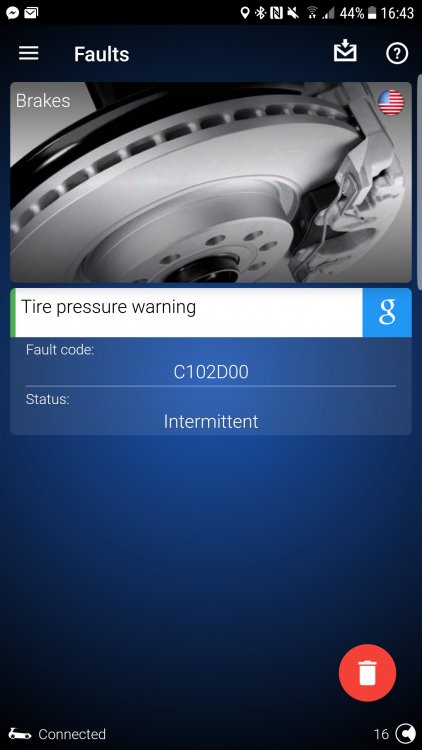

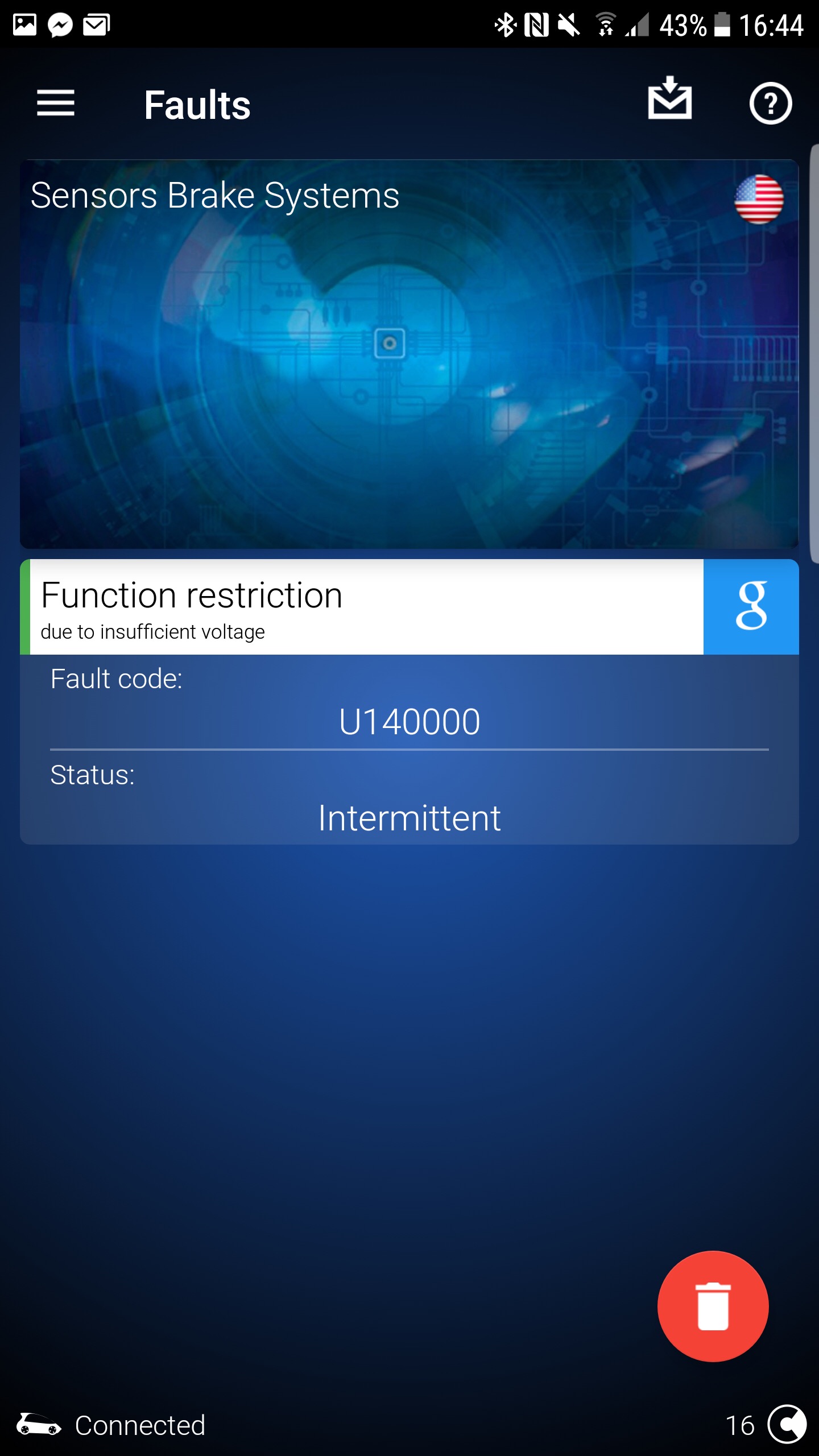

plugged it into the Citigo and for some reason I’ve got two fault codes :dry: (shown below)
Has anyone else had these appear before?

Tire pressure warning uses ABS sensors to determine speed differences between tyres. That's how it knows if tyre is under inflated.
Intermittent ABS sensor failure will make also tire pressure warning failure.
If memory serves I have had same faults couple of times. Nothing to worry about. Probably some moisture between ABS sensor and sensor ring is my best guess.

I’ll check tyre pressures, reset the TPMS and then clear the codes - see if they re-appear.

I’ve checked tyre pressures, adjusted where needed and pressed the ‘SET’ button. From there I plugged in the OBDeleven and cleared the two fault codes. Turned ignition off and on and started the engine. Scanned for codes again and no codes appear!
I assume it triggered those codes when the TPMS kicked in a few months back.
Could be. I thought it's intermittent sensor failure but it could be under inflated tyre. Even better.
I should read codes some day.

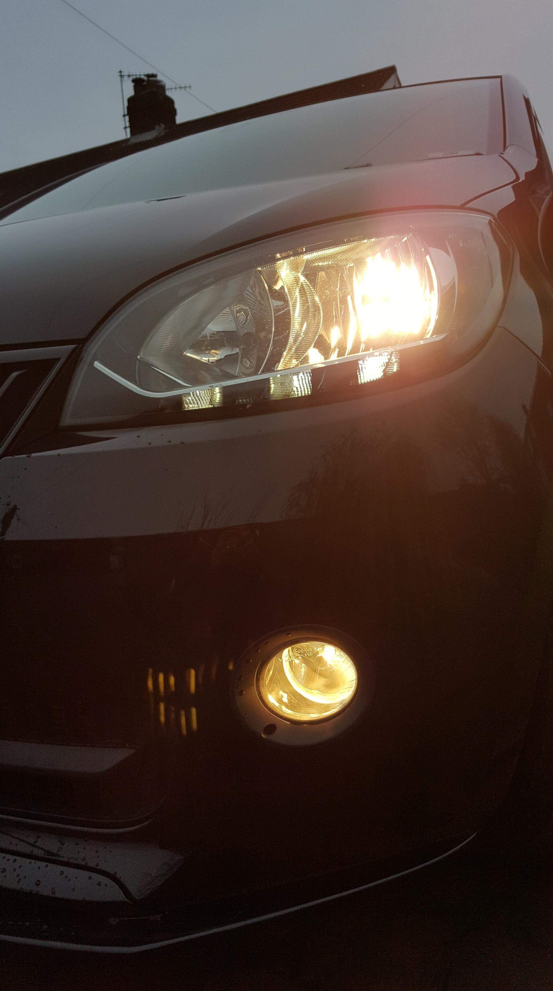

Sorry, I meant to come back to this! I have coded in cornering fogs on the car and sorted the auto locks coding. That’s it really, nothing like the Octy but there’s a few things to do :)

How’d ya do the cornering fogs? I have to admit... I was looking for the lazy option (under apps but there’s a big lack of options there!!).
Under the lighting module there’s an option to enable it, would have to check exactly how though as I barely get chance to drive it these days. Enjoying putting miles on the service managers car atm :)

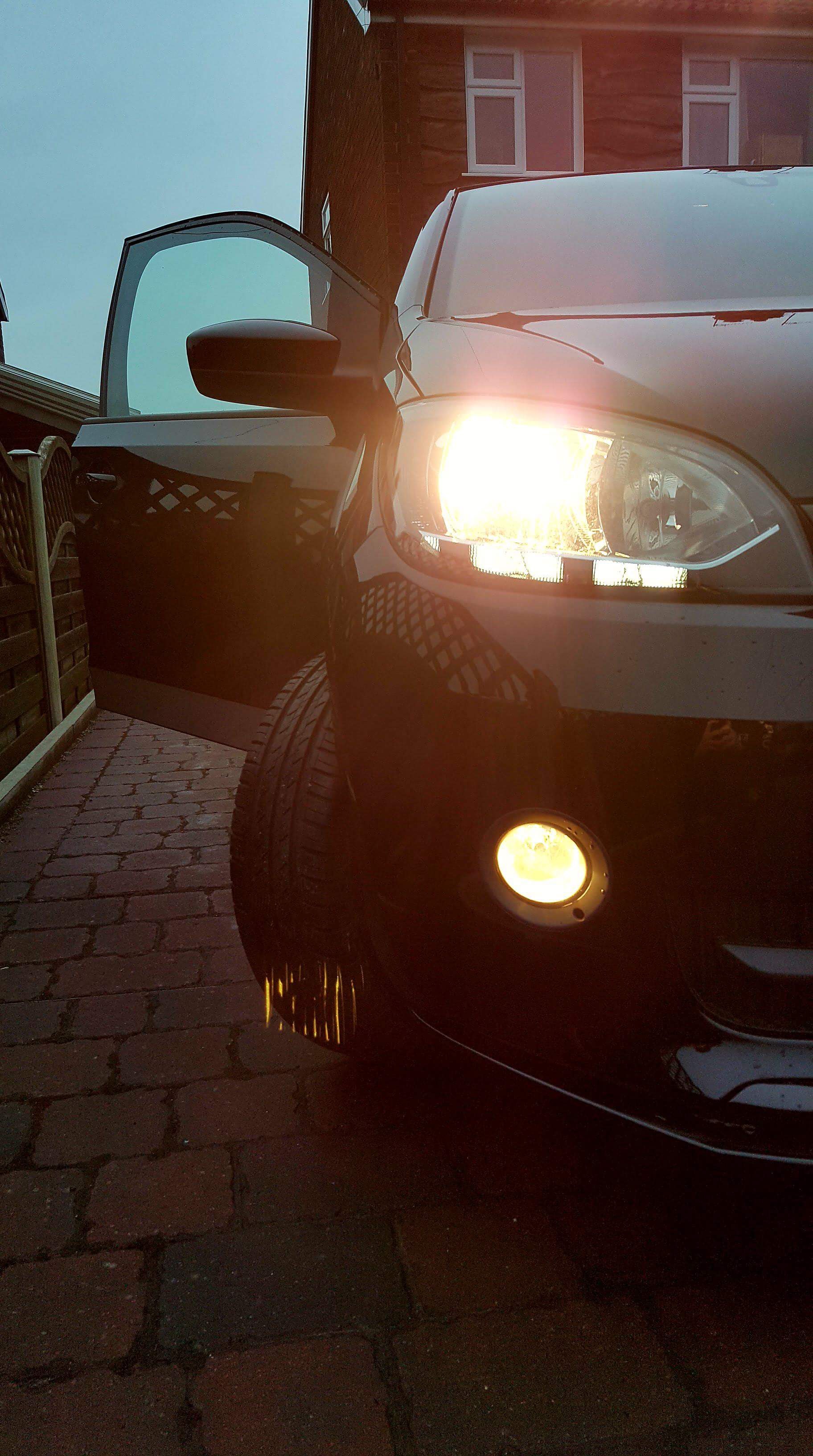

Checked OBDeleven and they have actually added abit more in APPS for the Citigo.
I’ve just enabled cornering fogs.
