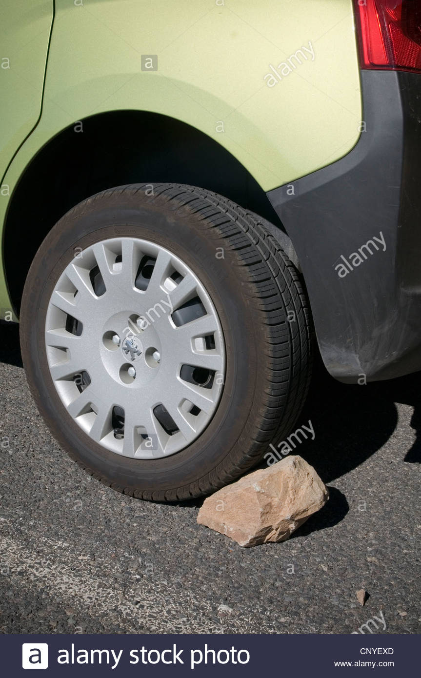

As usual the Highway code is behind the curve with Electric Handbrakes, and as many know in some locations Hand Brakes are useless in various environments / weathers and might pass a MOT but not a holding a vehicle on a slope.
Plenty will have been brought up or learned to drive in steep areas, towns, villages and the likes and had bricks / block available where they parked
or even carried them in the boot.
Like Steering wheel locks are back for car security, bricks in the boot might make a come back.
(Toe rags can then have something to hand incase they forget their Centre Punch.)
