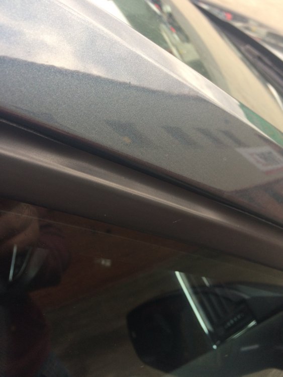

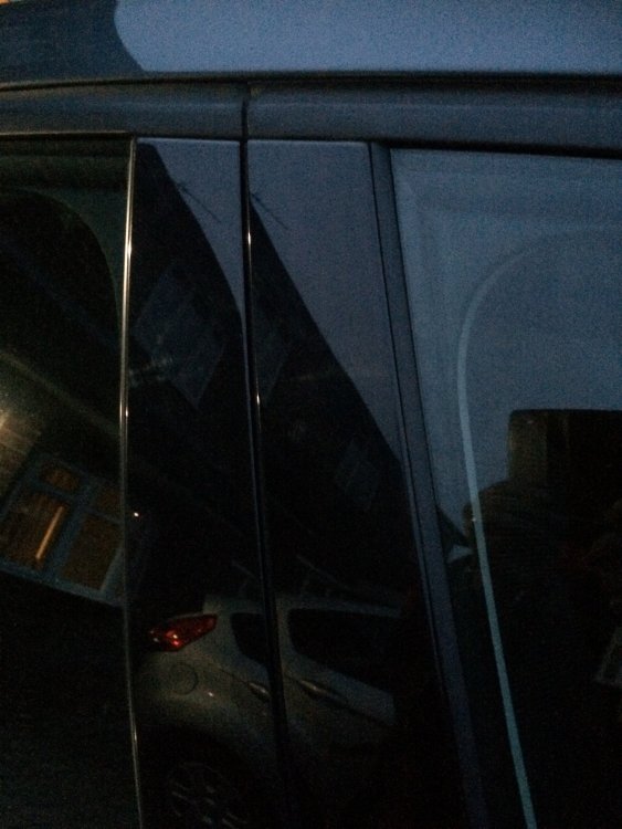

A poor door seal will create all sorts of wind noise, even from low speeds. Mine got compromised once and was immediately obvious when on the move. In my case it only took a minute to fix it but it's a bigger problem if you suspect door misalignment or the seals are not up to standard.

Well hopefully. The noise i hear can be solved or suppressed based on what people are saying. Mine is the hatchback, and 16” wheels. So that should tick a couple of boxes for being quieter car in the range. Apart from independent rear suspension, however like I say. Again people on this forum have also complained about noisy ride, cabin etc on vrs. So maybe this is a issue. Also my previous cars, 11 year old Leon 1.9 tdi and alfa mito 1.3 Diesel. I’m not coming from premium brands.
Ive come to expect my car will not be limo quiet . Just expected quieter that is it. Especially when you consider 22k when new. Now what I call cheap .
Thanks carrock!
Pictures are a great help. Like I say, if I can just calm the noise down and make my journeys to work more relaxed I will be happy.
