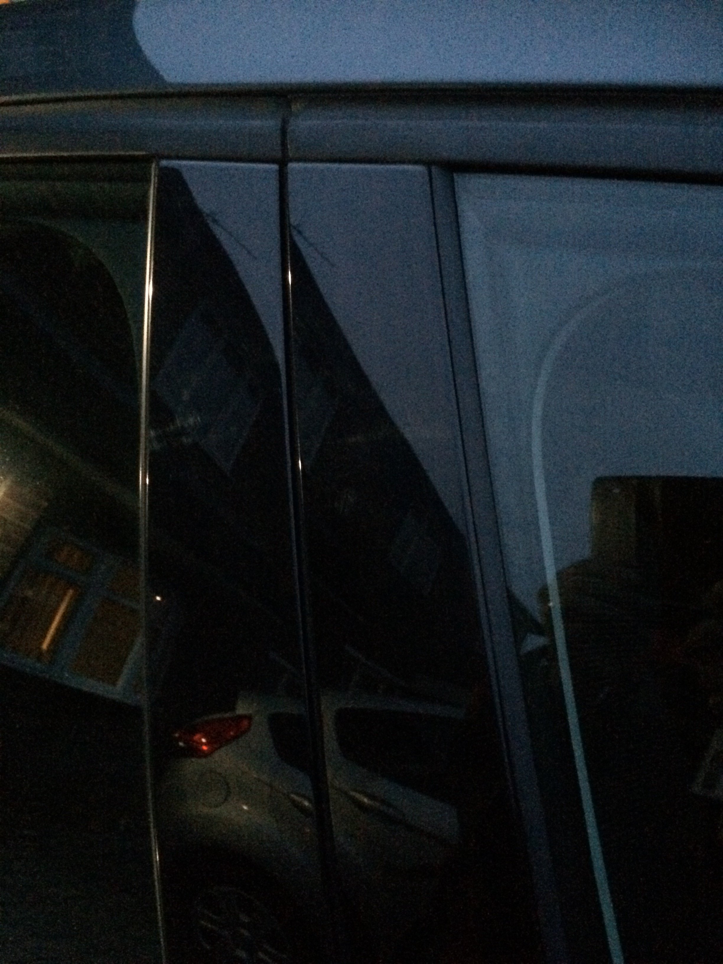

Hi all. Sorry had crazy weekend plus leaving early for work and get home late. However I’ve taken a picture now of the area.
All still good. Road noise is now exceptable and car could do with 6th gear. Strange not from a power wise point of view, just to help sit comfortable at motorway speeds.  However car is much better, much more comfortable and  sound levels in the cabin much better. I’ve added a photo of the area. Sorry couldn’t get mod as it would mean taking the trim off. All I could get from the time I spent with dealer. This piece of trim as a mod on the fitment. To prevent wind noise and help seal fit better. Dealer ship I used was listers, Bedworth. I’ll call again to see if I can get a copy. In a couple of weeks time I’ll be visiting bass junkies, who seem to stock all the sound dampening and sound proof material. So hopefully vehicle will just get better!
Hi alpha. Sorry just read your message again. The trim is the original. Mod is to do with re fitting of this trim and making  sure it pushing seal tight at the top
