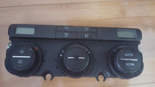

thought i might give it a try, but i wonder...in all the youtube videos, people first turn on the defroster, so it powers up, and then they check if there is any voltage on the lines...
this is a real newb question..but yes. how i am supposed to check/power the lines, if the heater turns off immediately?
I suspect the switch is faulty. If it is a push switch if you press and hold the switch will it stay on as long as you are holding it in?
Or is it a lever, 2 position switch?
Edited by xman
it's a push switch, and no, it will not stay on as long as i hold it. no matter what i do, it shuts off after like 1-2 seconds
it looks like the image under. and the upper one (front window) works fine
Have you tried swapping wires, bottom to top switch, to eliminate the switch? Not sure if this is difficult to do or not
