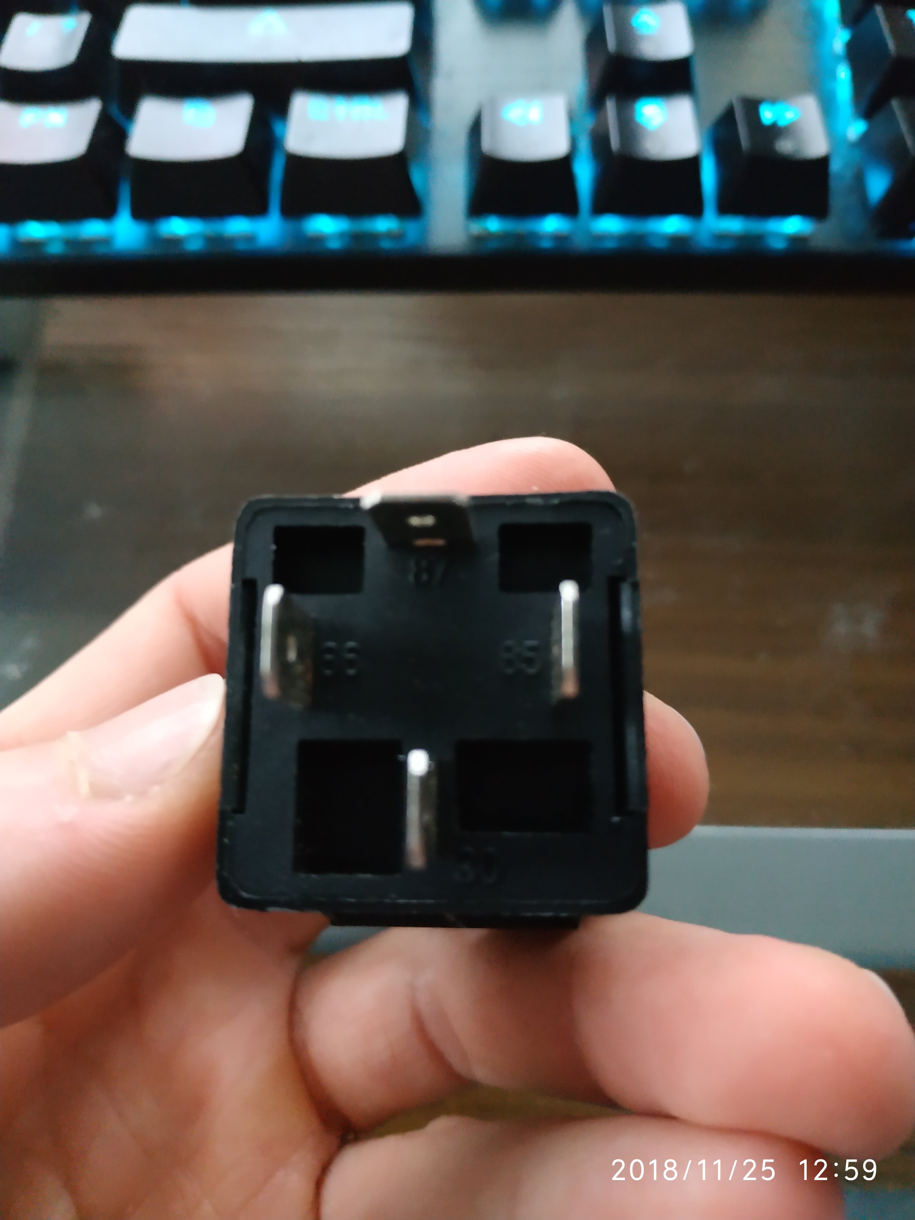

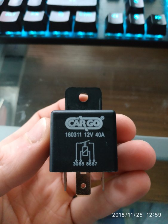

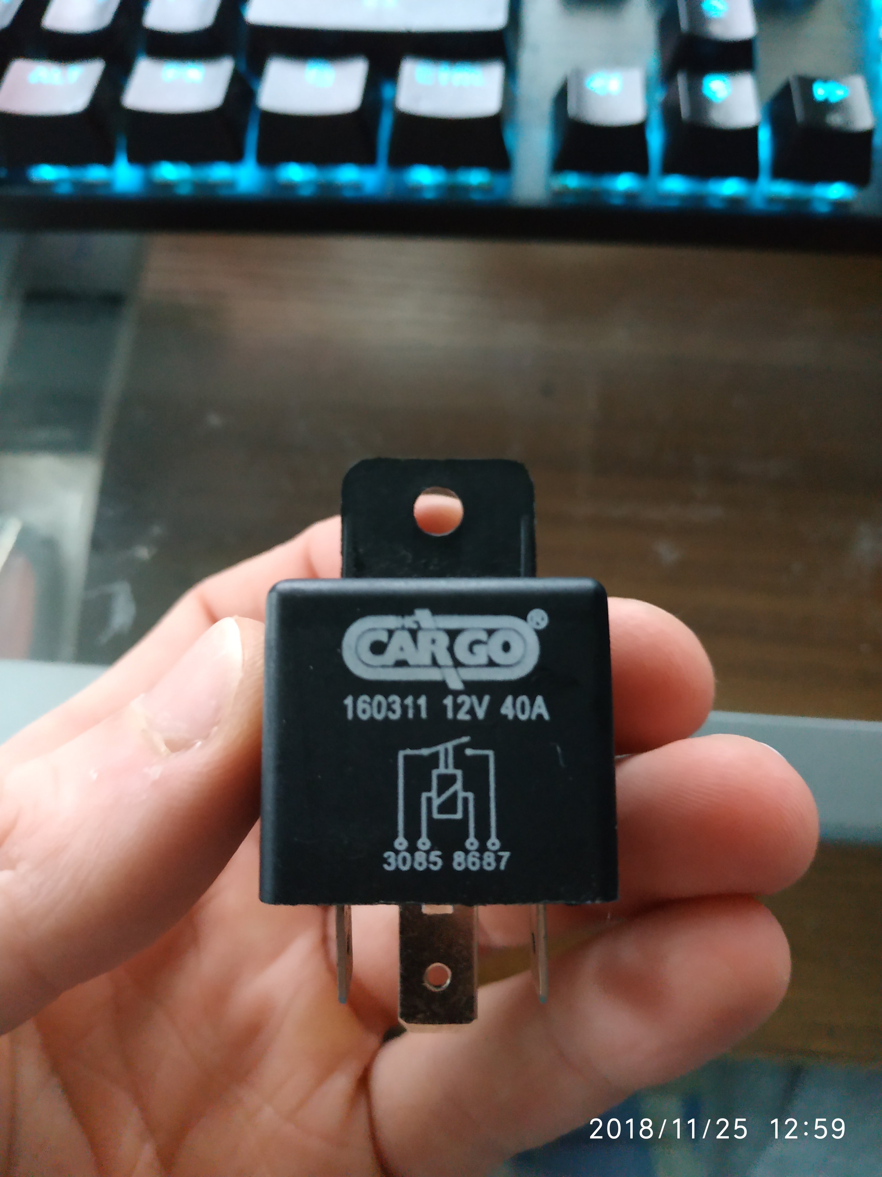

after a while, i found this lying in my glove box (attached images)...
it kinda looks like the relay we're talking about?honestly, i found it there after i took it to mechanic...but i since I'm real newb with cars, I never knew what it was, so i just left it there.
Is it possible he pulled it out, tried to set me up with some climatronic bull**** so I'd pay a lot of money for him to only change relay, and me not really knowing...?
Also, i provided a video of how it looks like ---> https://vimeo.com/user92111412/review/302668080/01075d9770
Again, sorry for being amateur with cars...but we can't all be into everything right?
That looks like an aftermarket relay that has been left behind by the mechanic so it does look as if the mechanic has proved the issue is not the relay.

you could measure the coil to see what the resistance is but ideally you could test it by applying 12v to it and making sure the switch contacts close. Or you could try putting that other relay in you have if it is the same style to see if you get any different results
You can also go across the relay base, and make sure you have 12V across the pair that switches (you will probably need engine running) this will prove you have power and a circuit through the screen element.
