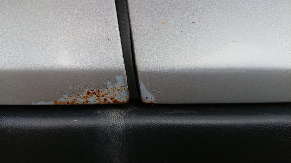

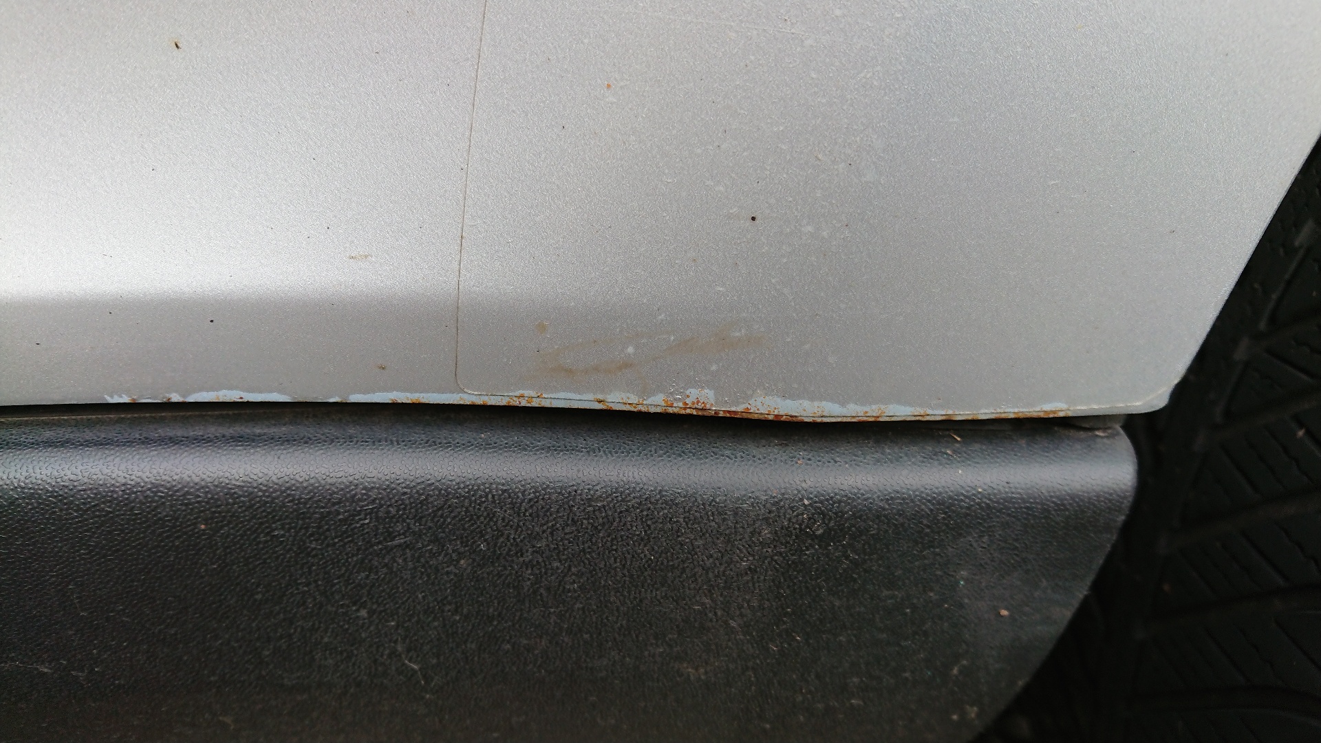

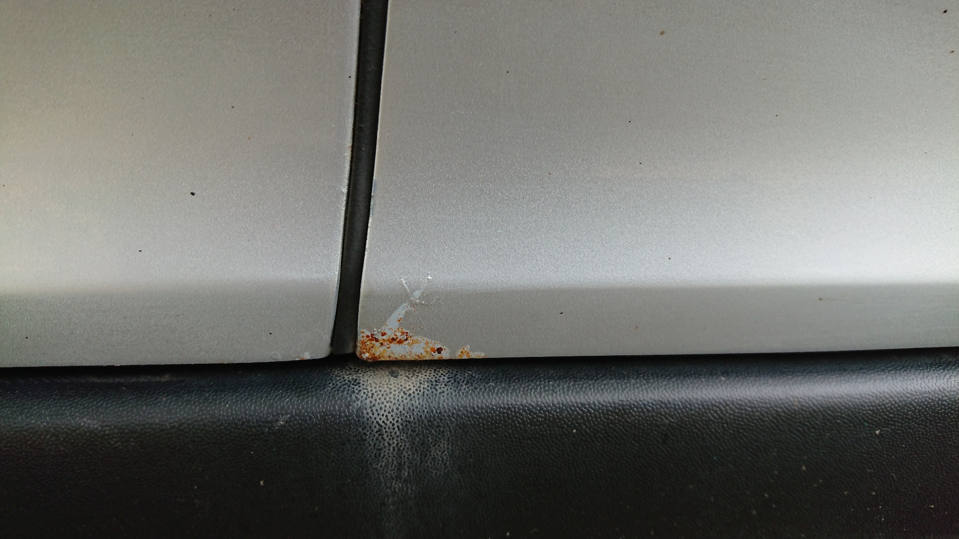

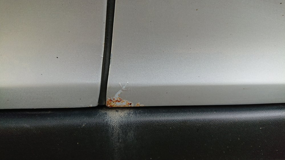

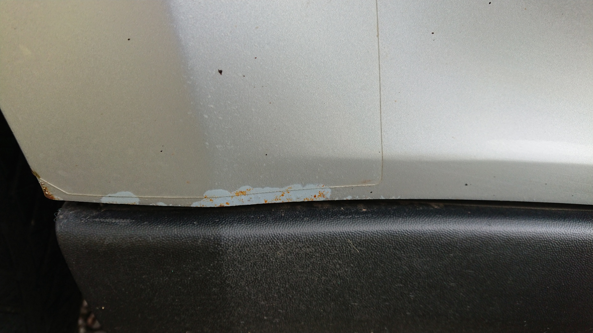

I've been pursuing this substandard repair/respray job through D M Keith (who did the work ) and Skoda for a while, to no avail. To cut a long story short, my 2010 Yeti had the rear wheel arch damage problem common in Yetis of this age and earlier that didn't have the plastic protective strips fitted. D M Keith Leeds resprayed all four doors and fitted plastic protection strips to the rear wheel arches. Skoda picked up the bill. My concern is that after 18 months the doors looked like the attached images. They are now considerably worse after another half a winter - my requests over the summer to have this fixed under warranty/guarantee were fruitless. In my opinion, a complete respray should last a lot longer than 18 months, and should definitely not make the sprayed panels look worse than they did before. Skoda was not interested in rectifying the problem, and D M Keith was adamant that it was Skoda's problem. My questions are 1) Is this an acceptable result 18 months after a respray, or should D M Keith rectify FOC under guarantee what I consider shoddy workmanship 2) Should I pursue this further in the small claims court or just limit the damage with a tin of rust stopper and a can of silver spray paint from Halfords? Thanks for your help!

That is a shoddy job and totally unacceptable.
The helicopter tape protection should cover the back edge and wrap under the door too, check on another Yeti.
The responsibility for that is down to whoever did the paint job, insufficient primer and topcoat flaking is caused by a non existent bond due to poor preparation between coats.

Thank you Urrell, I have no technical knowledge of car paint jobs, but what you have said makes a lot of sense. I have owned cars for 30 years, and this is the first time I have ever had a rust/paintwork problem. Interestingly, the tape is pulling away from the inside of the wheel arch - so another bodge job...
