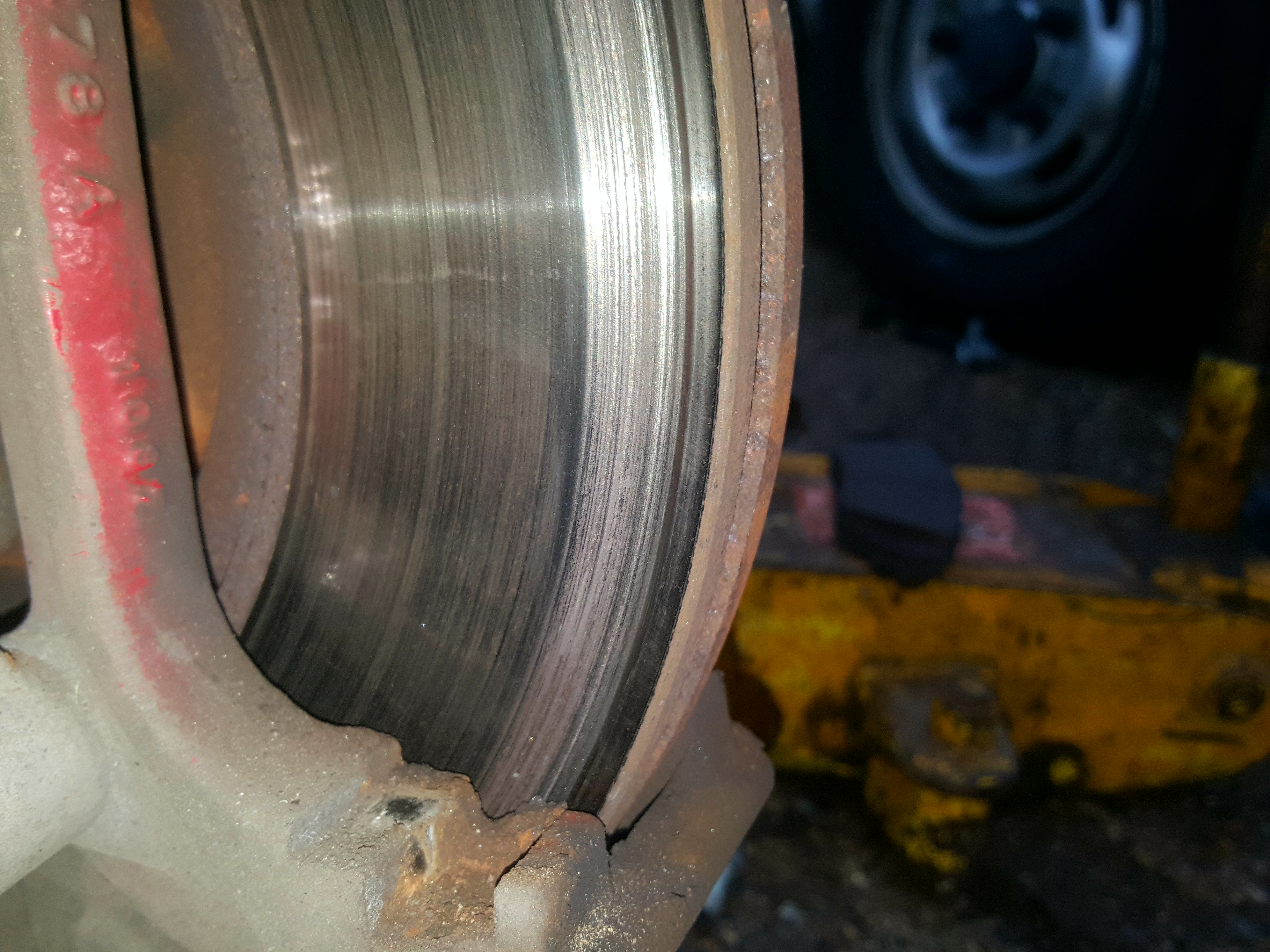

Bit shocked & don't like or agree with it but, fortunately the Master Tech that inspected my car doesn't either & found a slight oil leak on a caliper which IS a warranty item. Therefore, both the pads & discs have to be replaced due to "consequently damage" gonna buy that man a drink me thinks

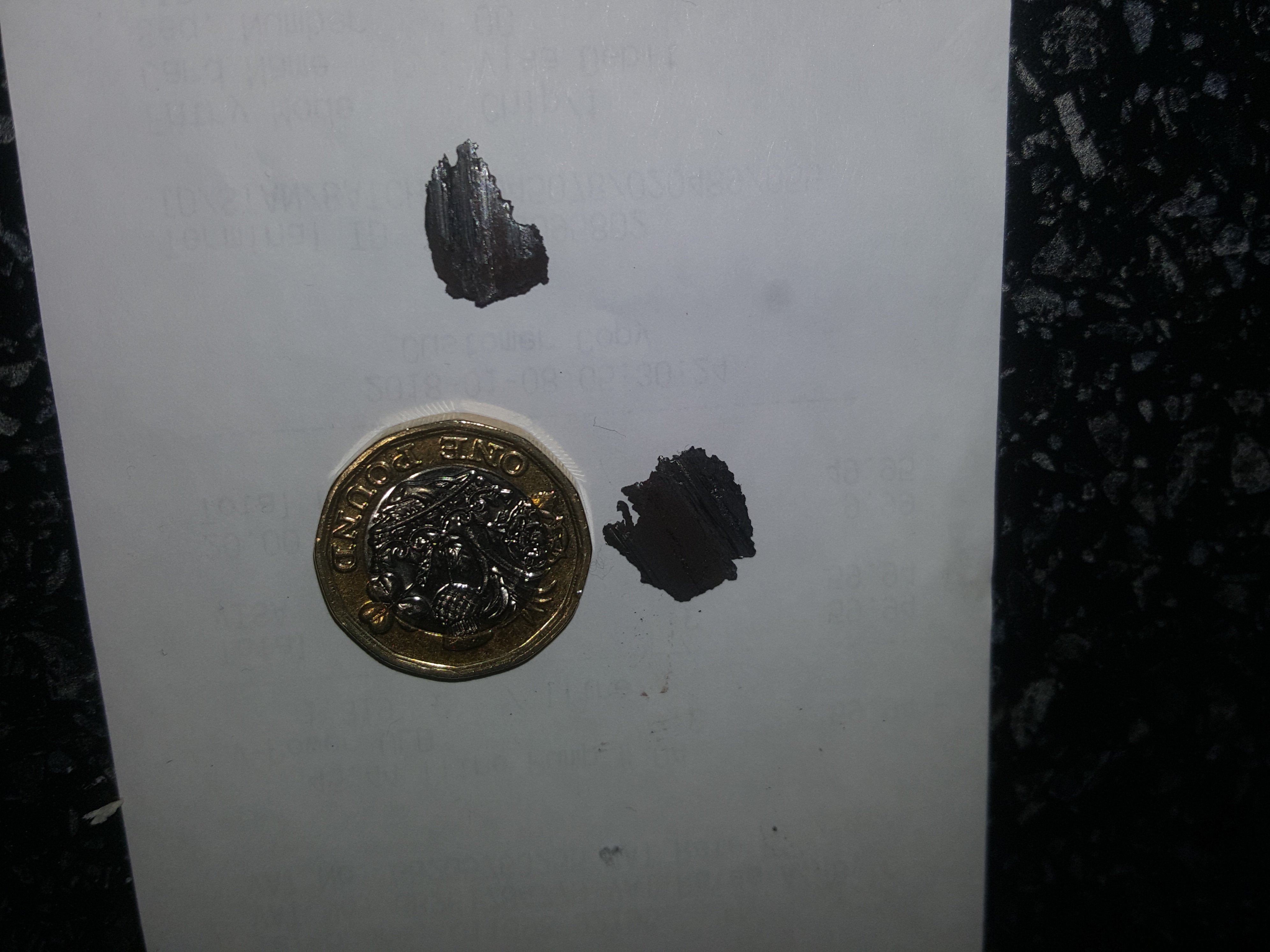

Surely, brakes & pads are meant to last more than 4,800 miles, pieces of metal built-up on the pads have been eating a groove into my disc.

I'd say the fluid leak is a torn seal in the caliper caused by those pieces of metal fillings, not good.

Did the chunks of metal come out of the pad friction material? How did you retrieve them?
Yep both lumps were embedded in the brake pad causing a loud grating/grinding noise together with wearing a rather deep groove in the discs themselves.
Apparently, metal has replaced asbestos in brake pads in the last few years & under heavier use this kinda thing can happen but, some mechanics claim this a defect of the brake pad. This certainly a line I would have persued had the need arisen.
My mechanic retrieved them for me whilst having some other bits n pieces done to the car. Not very easily done as the groove was wearing in the backside of the nearside front disc obviously, mechanics make it all look very simple !

Sounds like the pads were defective to me.
Yeah I'd agree with that

Asbestos hasn't been used in brake pads for about 25 years, it's was banned a few years before i started in the trade, the ony metal part on a brake is the backing plate, the friction meterial is a composite of different things but not metal as far i know.
How did that £1 coin get in the brake pad? :o  :biggrin:

Must be a defective set of pads as not only were the pieces rusting but were also attracted to a magnet. Dunno kinda makes them metal to me unless, you have any better suggestions ?

Most brake pads have metal in their composition, some can even be made entirely out of metal (sintered steel). You wouldn't get full metal pads on road going vehicles, but most cars have semi-metallic ones as standard - they have metal shavings in them I seem to recall, helps with longevity amongst other things.
Defo defective pads, and i'd say very cheaply made pads as well, perhaps some dud's got into the production line as i've never seen anything like that,
to be honest it looks like a piece of a fitting shim but do MK 3's have them on them on the caliper's, i know my MK 2 don't have them.
