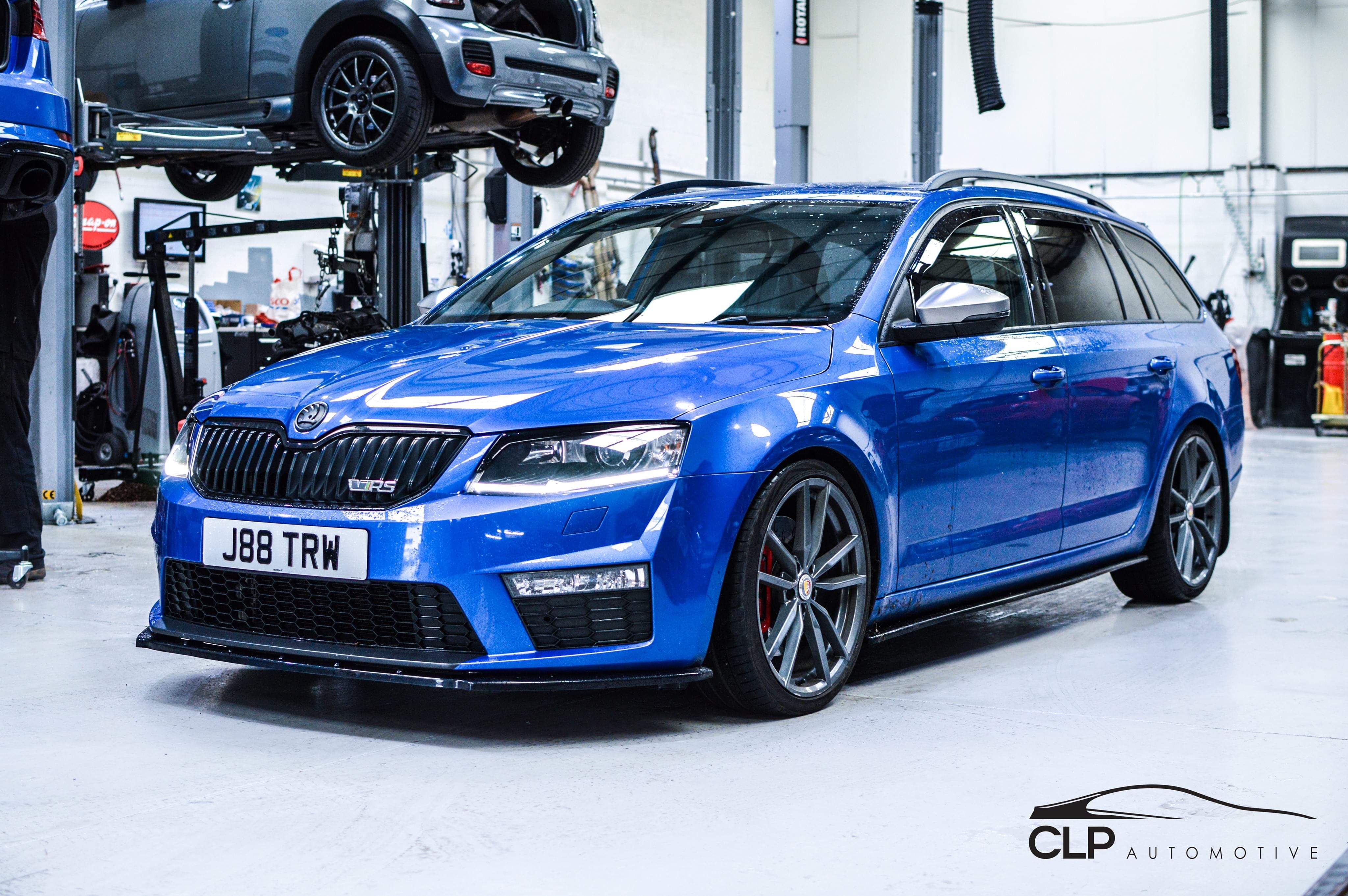

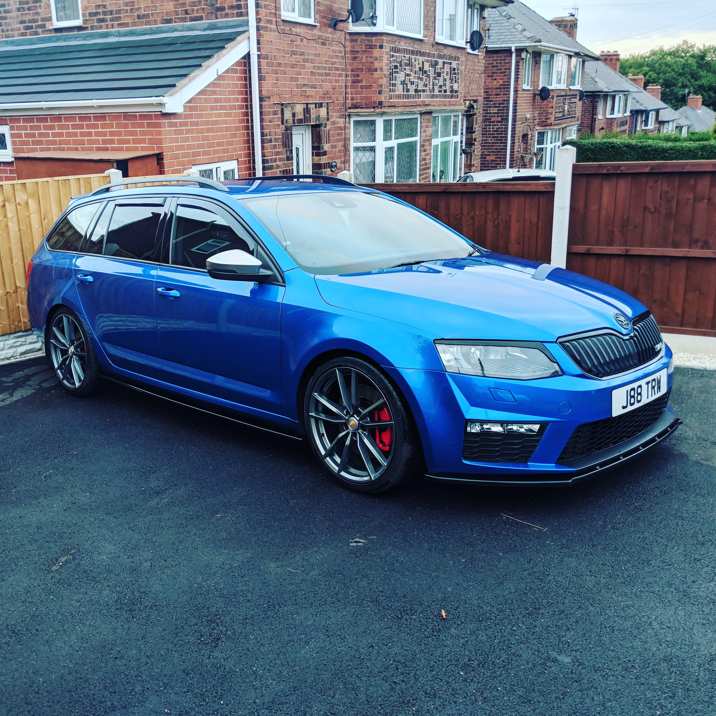

  • Here we are - On with Pretorias and strut bar thanks to @Ant-Vrs   Looks great for summer!

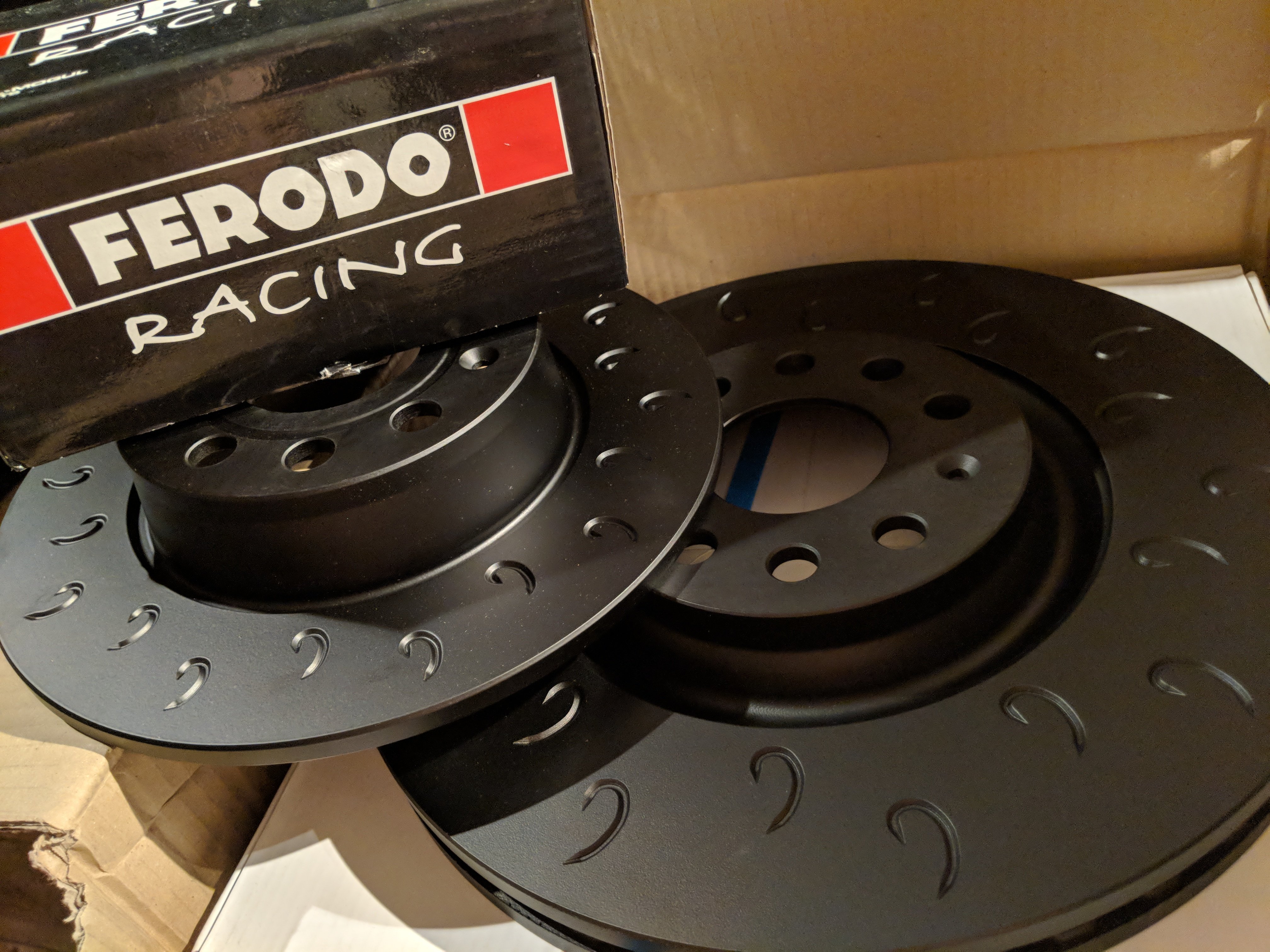

  • New discs and pads week!

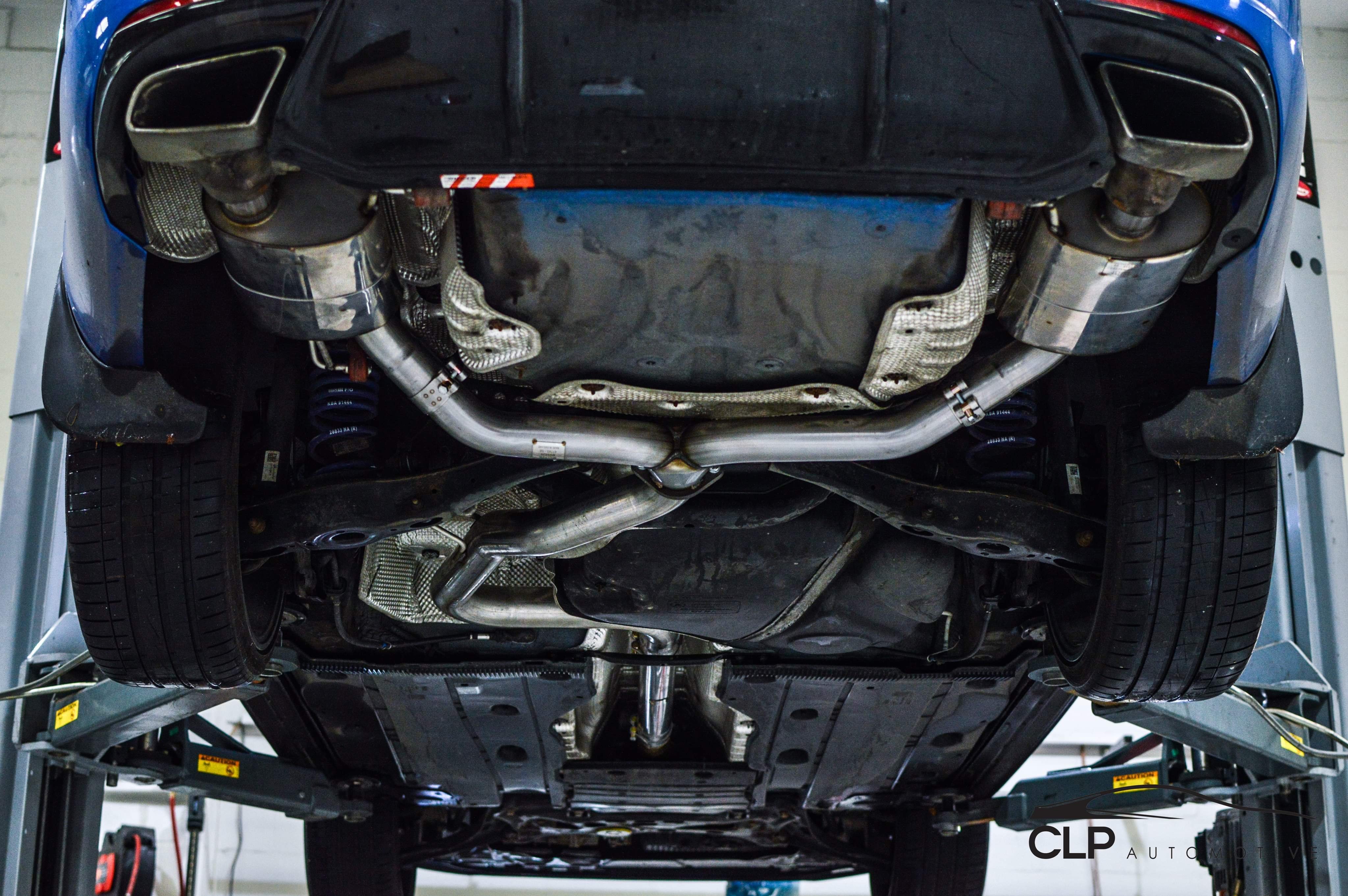

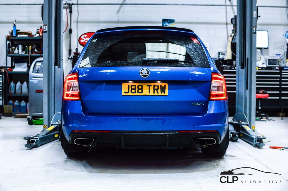

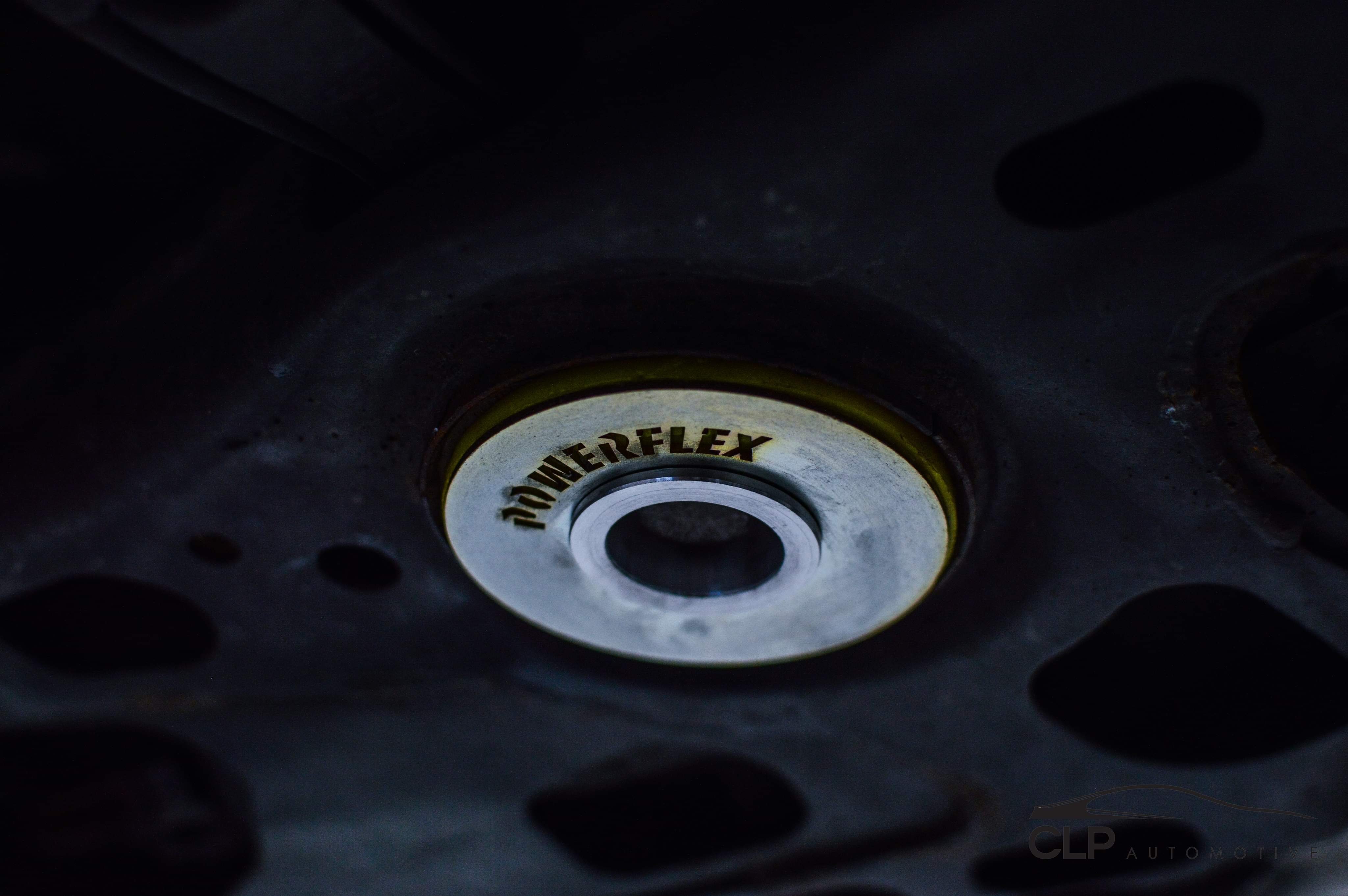

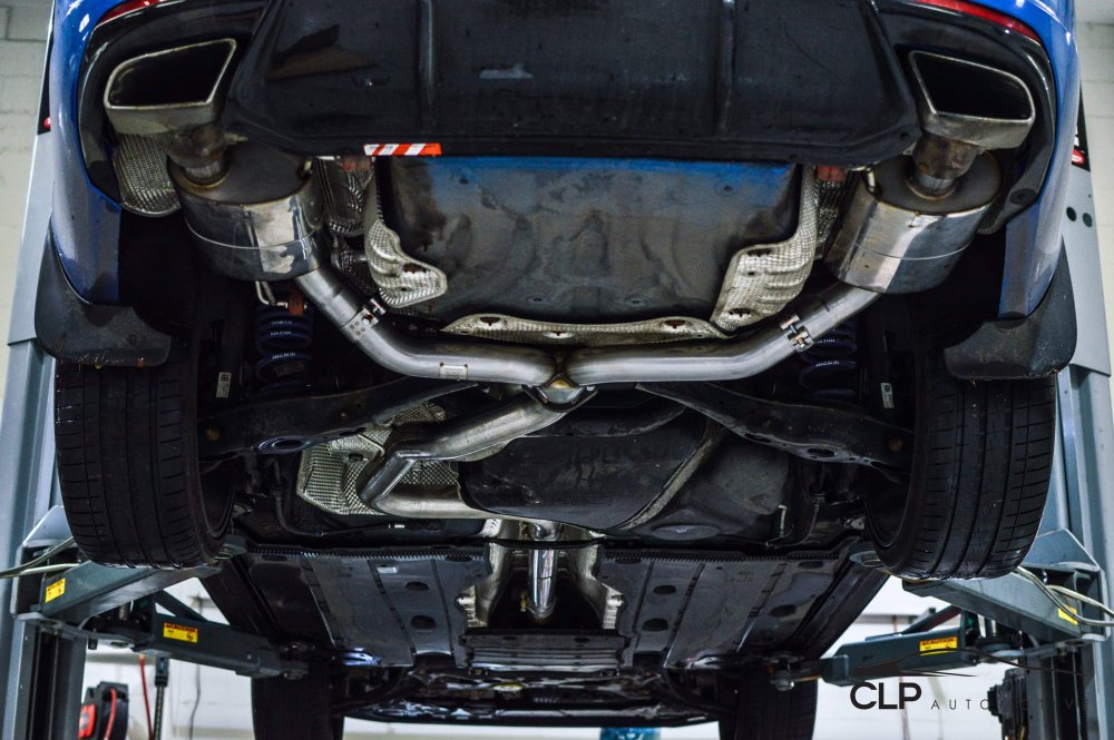

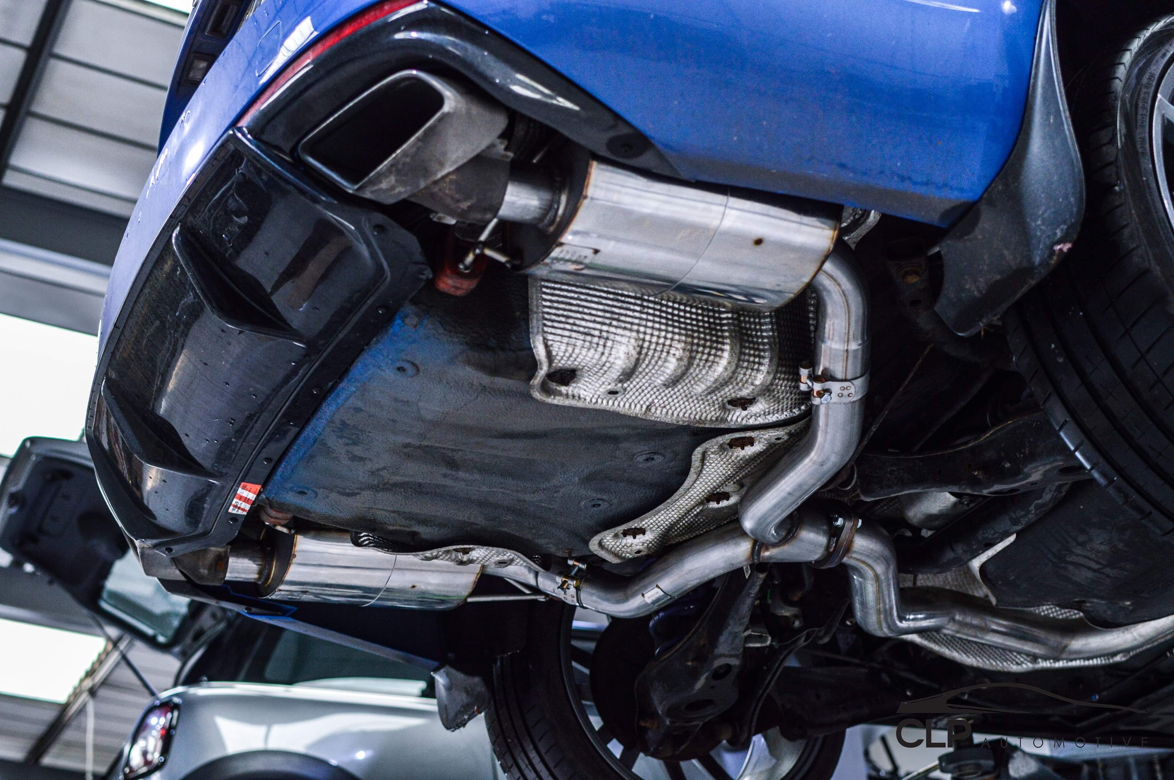

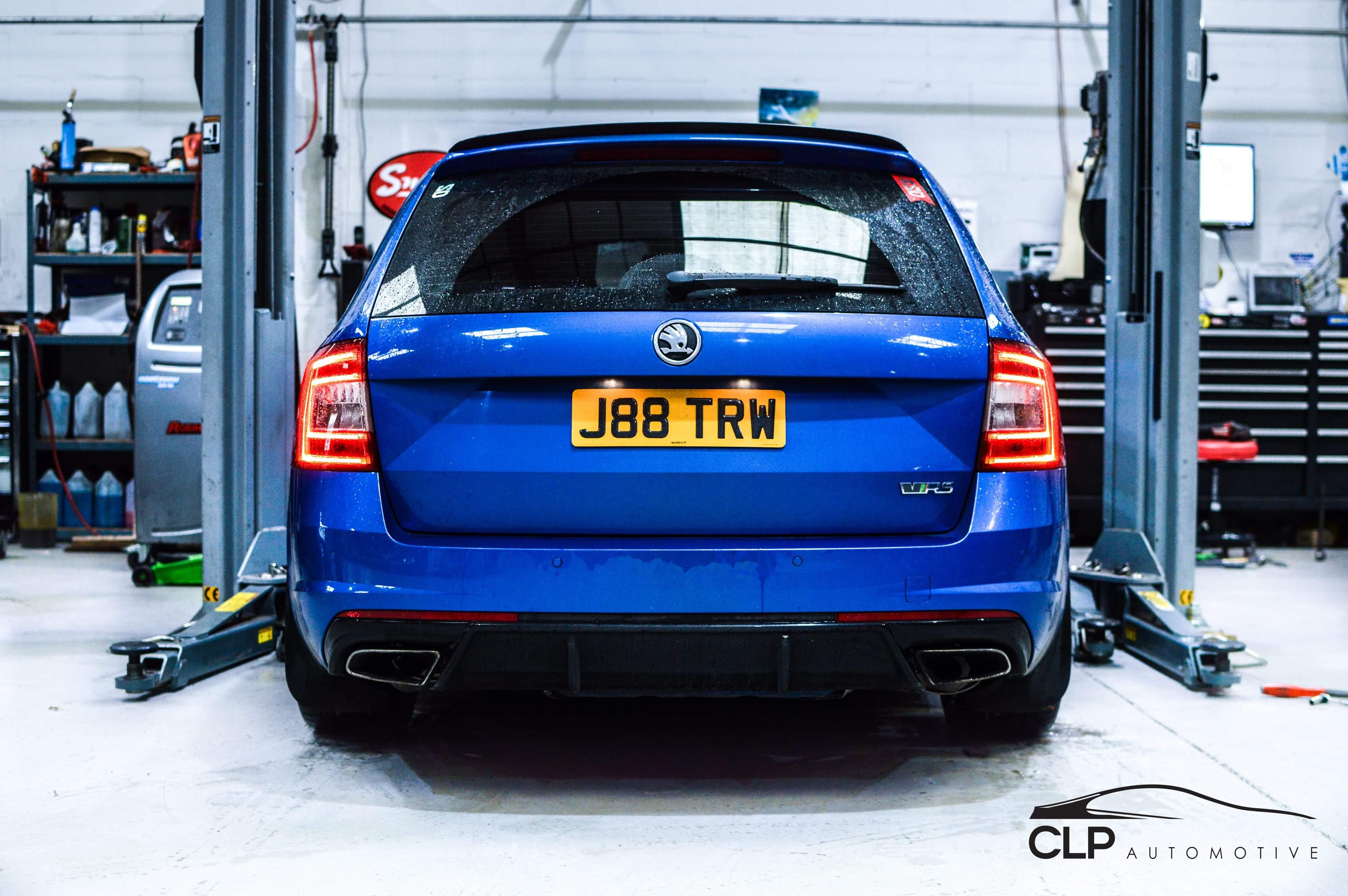

  • Went for 3" Milltek catback non Res during black Friday to fit my 3" Milltek downpipe and sport cat. Also fitted a powerflex lower mount.

How are you finding the strut brace Tom?
Feels better with it on :D - Handles well with it being lowered too - Stiffened ride.

Those wheels suit the car so well.
Did you go with a stage 1 map?
Thanks :)
I went Stock - Stage 2 around 330hp/520nm

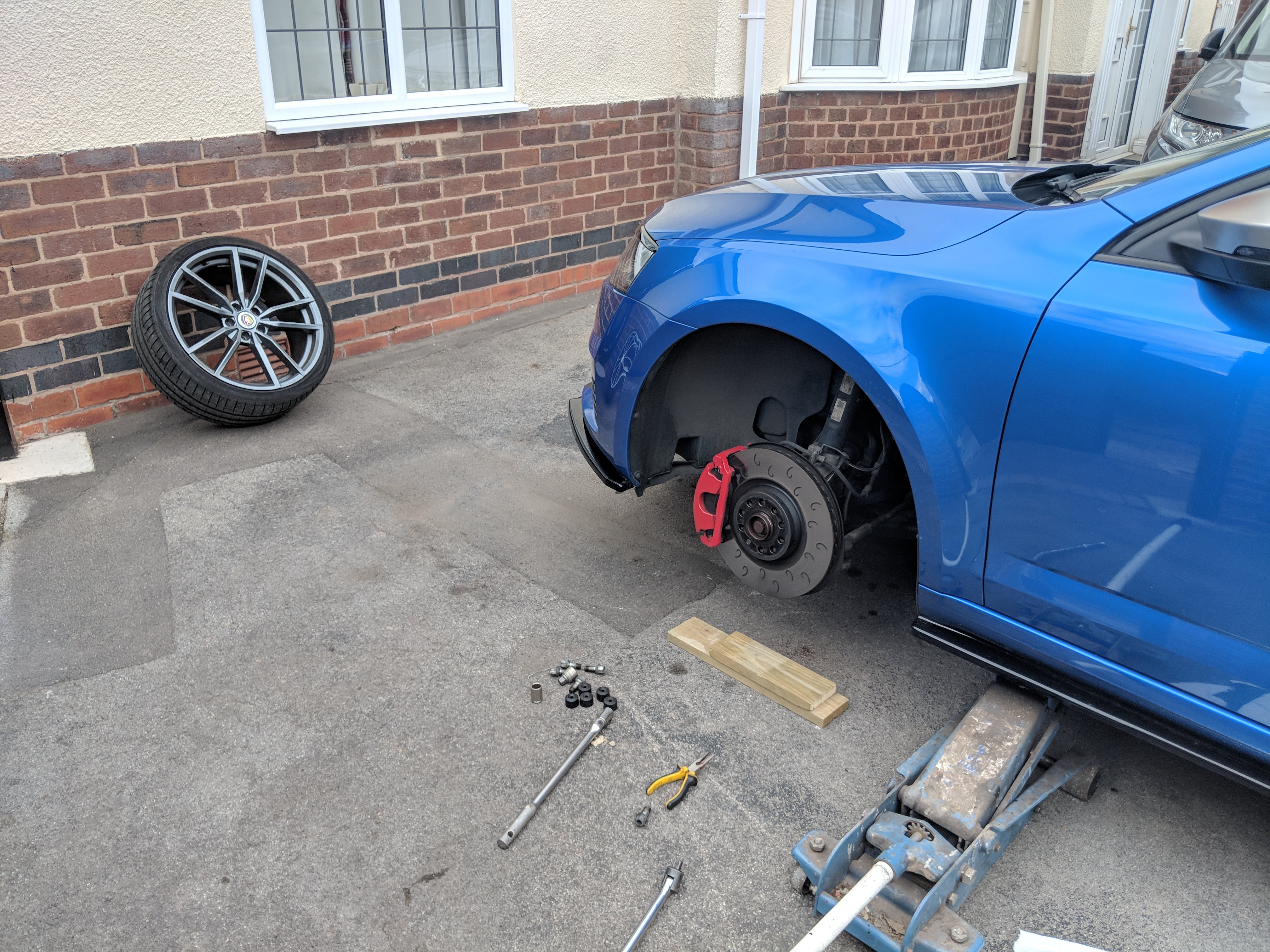

You fitted the new Pads and Disc's yet?
Yup, all done, new brake fluid too. Front pads are loose though making a noise over bumps. Got to inspect

Update - Front pads are great at stopping but they don't fit well and move about vertically and over even small bumps they rattle - hugely annoying.
Switched them out yesterday and put in ebc redstuff - Returning the Ferodos.

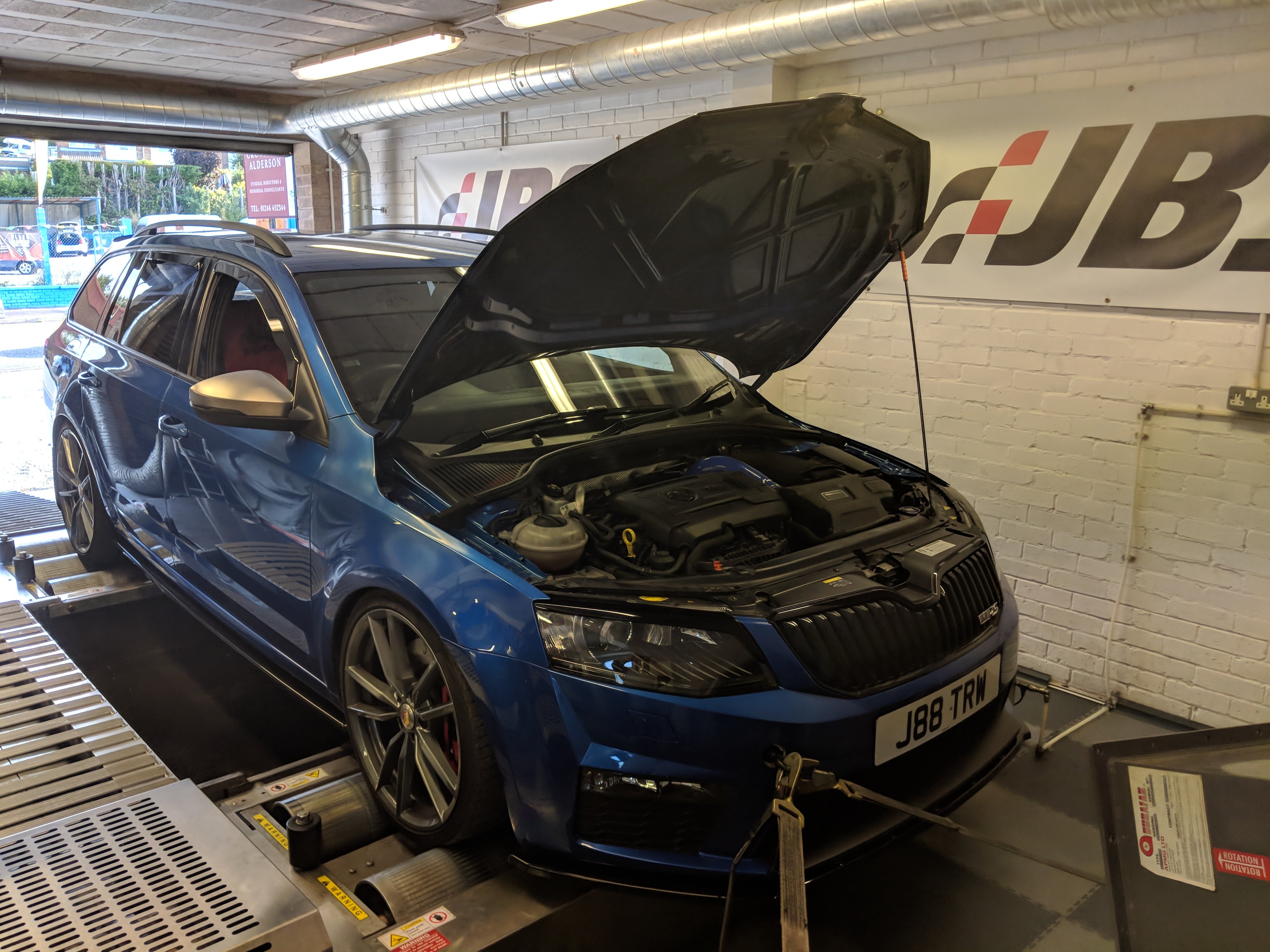

Also finally dyno'd at JBS and made 307hp/389ftlb for a Stage 2 Shark P map - low hp results - Some people have said JBS have more accurate rollers and usually dyno with lower results than other tuners due to this.
It's quick so I'm fine :P

What point are you jacking up on there Tom?
I've been jacking mine up on one of the big front subframe mounting bolts to avoid damaging the sills.

Little triangle on sill I think advises where underneath - Not had any issues with it :)

Interesting, cheers!  When you're next under there check whether the paint and underseal on the sills is intact.  My understanding is that those points are fine for 4-post lifts as the car is raised evenly (straight up) but a jack raises the car an angle (upwards and slightly outwards) which places a sideways force on the sills which they're not designed to withstand.
My S4 had the same narrow sills and jacking points.  I bought some special slotted rubber jack pads from the US to solve the problem, where the slot width and depth were specific to the car.  Something like this:

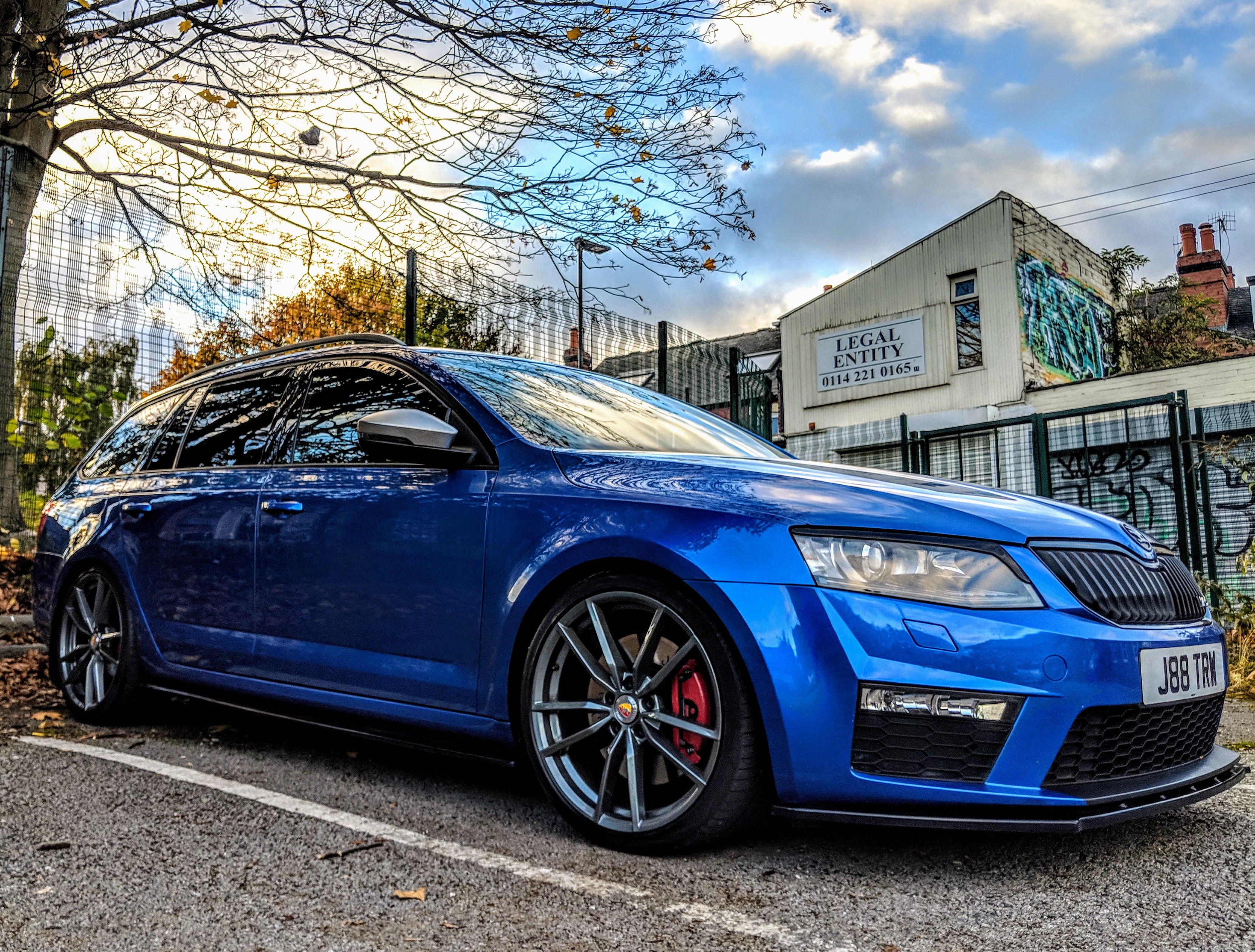

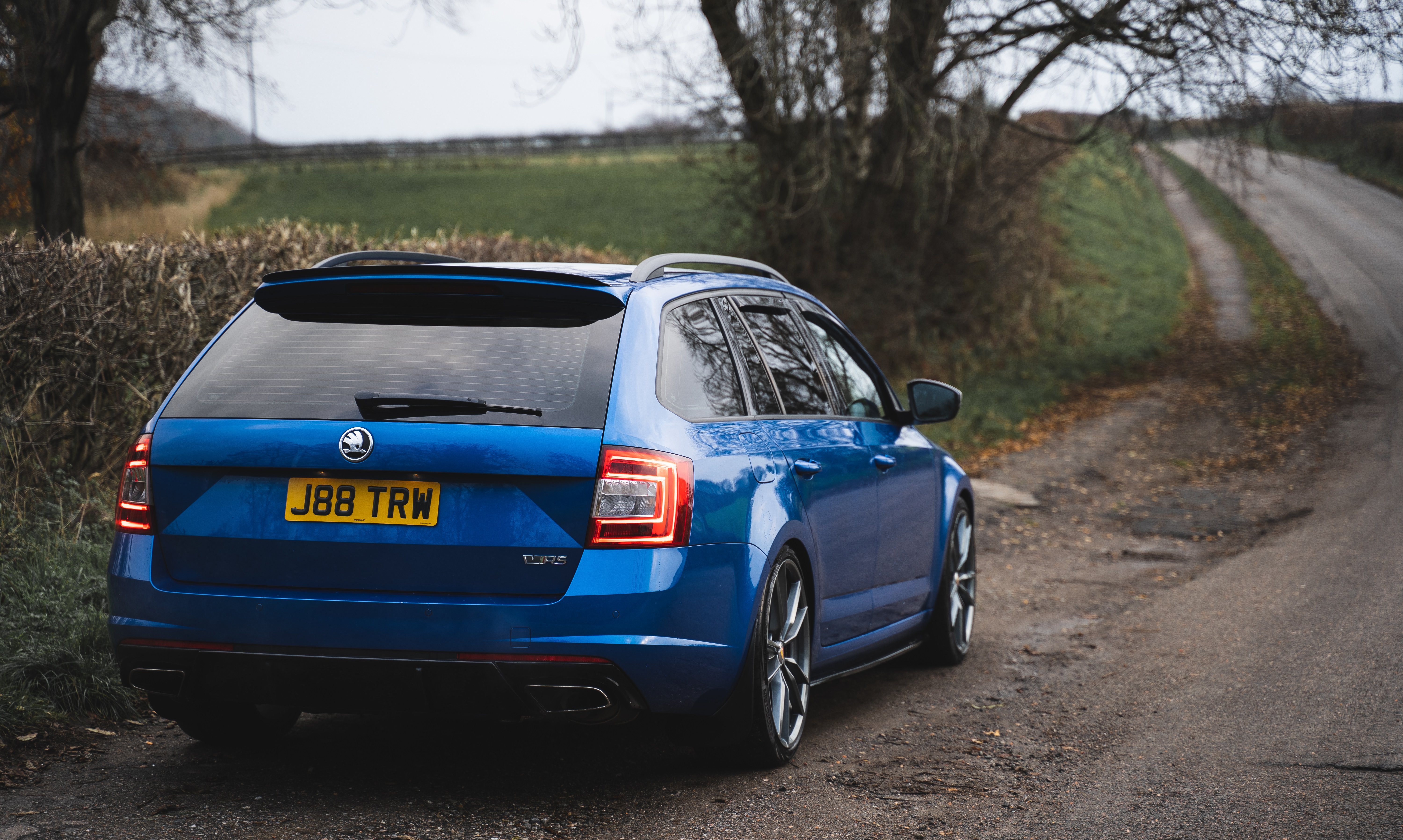

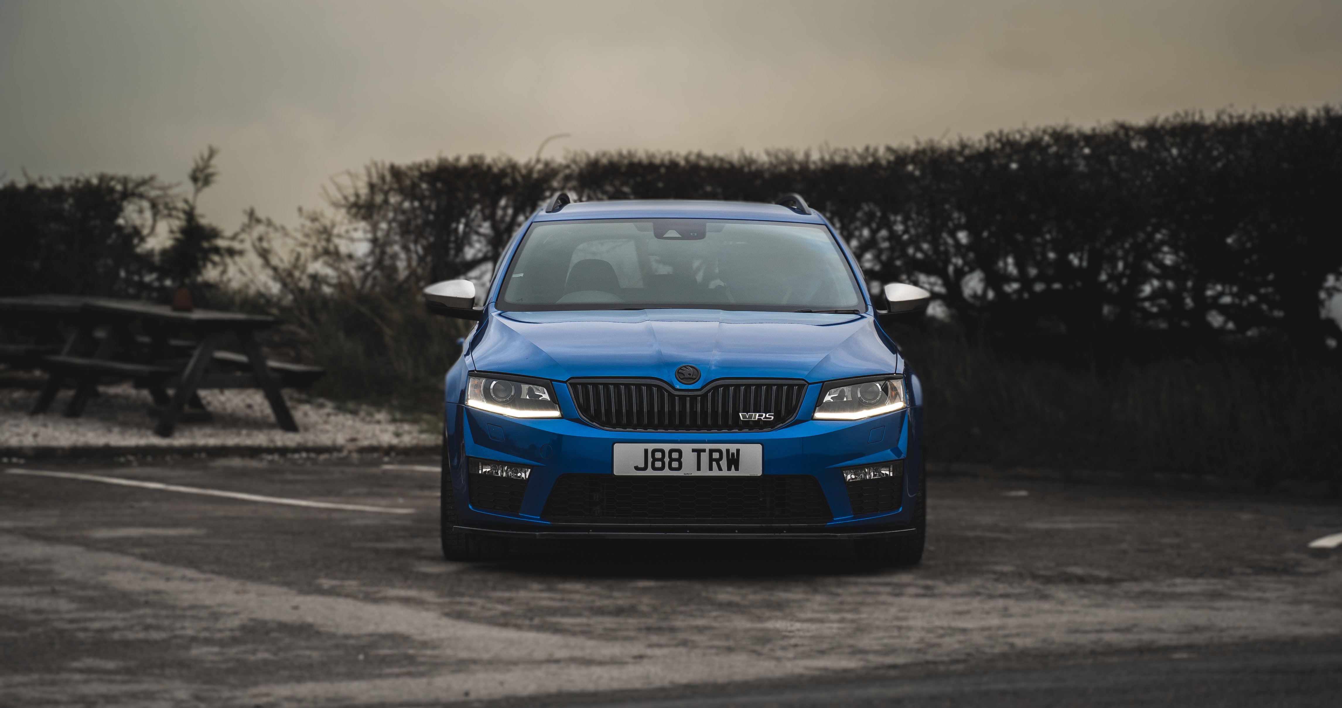

Last few nice pics before she jumps back onto the Turinis (with spacers!!!) and winter tyres!
:D
Ooooh nice. Just seen this thread and personally this is my favourite MK3 Octavia on the site.
Great job
Great job
Cheers dude!

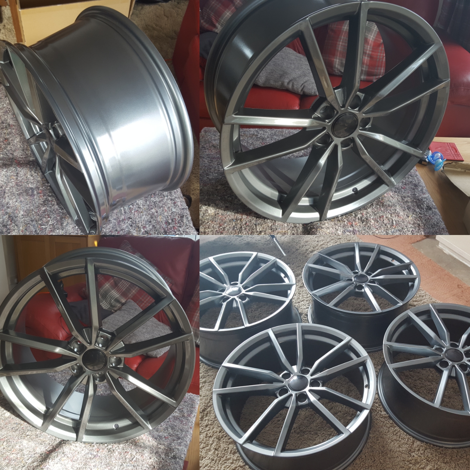

On 03/05/2018 at 10:19, creamvRS said:
Wheels arrived Monday.  Waiting on tyres.
Also booking my remap in for end of May with Shark.
Did you go 18's or 19's in the end?
19s 8.5j et45
