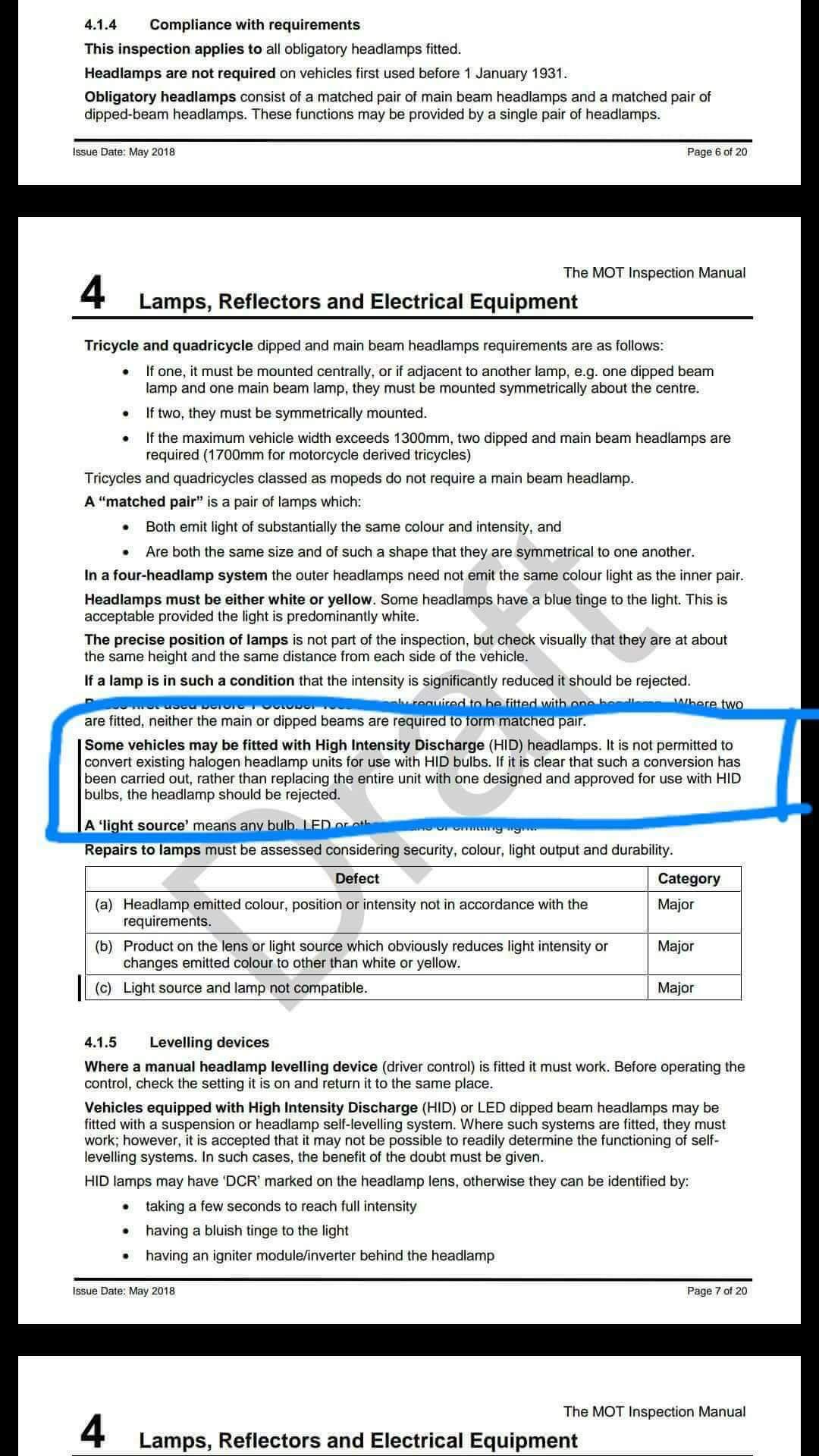

With greatest respect to @hutchysrs50, be aware of new MOT regs being introduced soon. B6B6FB79-6003-457C-9123-33668287348D.thumb.jpeg.0cf28315d0618bac5c2f0434641679a6.jpeg
Of course these regs would not apply to genuine xenons.

The conversion applies to halogen lights running xenon bulbs which isn’t aloud.
having hid xenon bulbs in xenon lights is fine.
