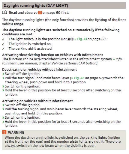

To save battery turn off Daytime Running Lights as well. See: -
That's one of the top things I love about the looks of the car :) those DRLs are supercool, no way I'm turning those off :) I'll better let battery die than not see those lights :)
