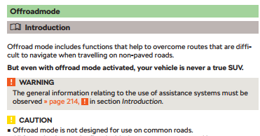

Off Road mode is not for snow really, it is for unpaved surfaces. It only intervenes below 30km/h. The manual does contradict itself though!
offroad1.PNG.5cc03e331e462b4e05c159fb13a3a60e.PNGoffroad2.PNG.3d227acbe6391f0a5a6f23815aeaeb57.PNGoffroad3.PNG.58a631ad7faf899ff3193e985c77ec41.PNGoffroad4.PNG.3a08dd89df18f43f2f29660e6aa9ef59.PNG
Incorrect, I am pleased to know! Perhaps you are thinking of the downhill assist thingy or the green slope dashboard light. However, if the light is out and the car is doing more than 30kph rest assured the OFF ROAD MODE (whilst still showing as on, on the switch itself) is still operative for LOTS of other things... :biggrin:
I did say the manual contradicts itself :)
