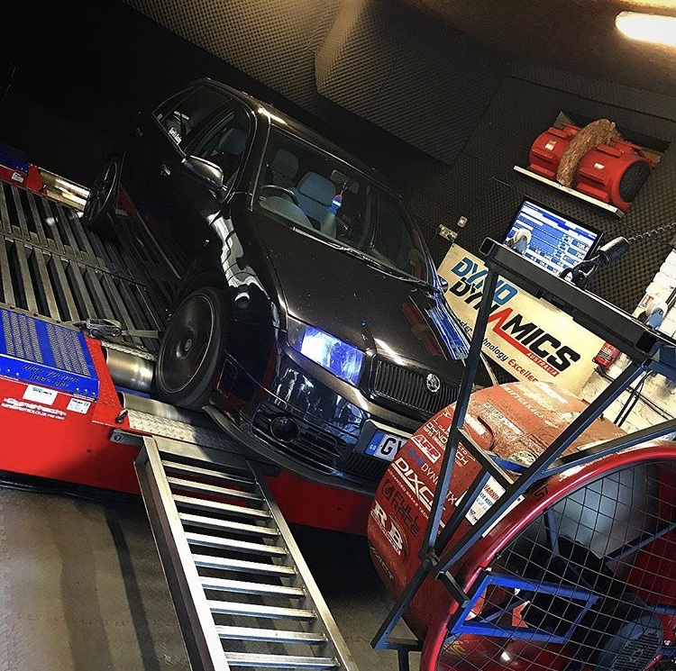

The photos I have of the progress so far are vague as I wasn’t expecting to keep the car. I noticed as soon as I got the car the exhaust was in bad shape, so I bought one of them exhausts everyone posts about, tube decat and tip, that went on nicely and painted the grill surround black and fitted new style badges, aswell as one of them eBay rubber lip things! Shortly after that I got myself a remap, the car made 166.8bhp and 325ftlb.

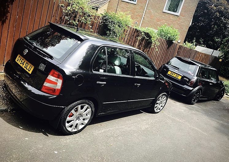

I couldnt stand the standard 16” wheels so bought a set of spiders with good tyres for £120, they still need a referb now but that is coming.

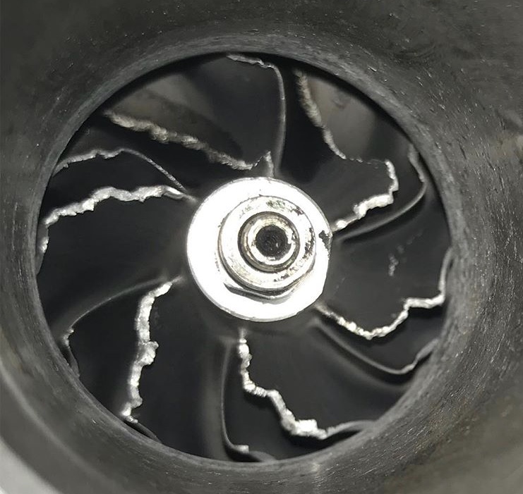

couple of weeks ago the turbo decided to go pop, no warning signs, no smoke, no lack of power just went as I drove down the road, a pop followed by siren noise!!
at this point I was unsure what to do, I purchased a new CHRA Cartridge and got RD Automotive to fit it for me, £45 later the turbo was rebuilt and fully cleaned out the VNT system. He said it was slightly sticky but nothing bad!

Heres some photos of the car and I will take more now as I’m keeping it and try and keep a decent progress thread going!!
Looking good mate. Spiders suit the car so well. Pretty much same idea as me. Bought as a sensible daily to munch the miles and earn its keep. I'm seriously fighting the urge to put the sachs sre smf kit and lsd in while the clutch is being done.
They do indeed mate, they come up cheap with good tyres, my 16s needed tyres so worked out cheaper and better looking wheels, 2 birds etc!! Wheels need a refurb bad, they was painted really badly by prev owner and they’re chipping off like no tomorrow, undecided whether to keep gun metal or go gloss black with the wheels

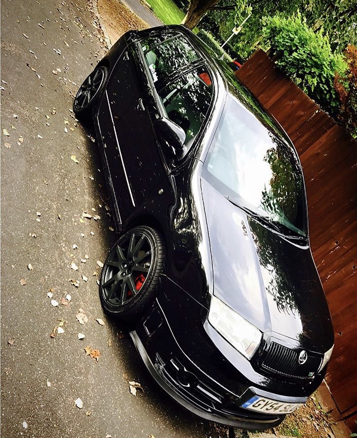

Looks smart, how did you manage to get that grille surround painted? Im thinking of doing mine tried asking bodyshops but they wont touch it as its chrome.
I'd stick with gun metal as black wheels seem to get a bit lost with all the black, especially on photos.
Yeah I had a set on my first fabia before i switched to s3 to clear the brembos.
They are still the best looking wheel on a fabia I think
It’s started to chip mate needs repainting!! However I masked up the badge, the grill emblem, the slats etc and rubbed it down best I could and painted it, I’ve heard you can remove the chrome trim itself but I didn’t want to break anything! I did think keeping them gun metal but undecided if I prefer the black on black with tints etc as my missus JCW looks so smart black on black!
Looks real nice mate, I got the black one too and thinking about painting that chrome part too, the chrome part just sticks like a sore throat on a black fabia :D

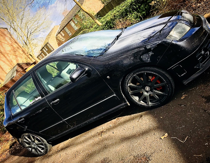

So today coilovers happened! Set of Weitec HiCon GT went on. Upon refitting of the NSF wheel we noticed some play, lots of play infact, the track rod end was shagged, so a new one went straight on! Damn there was a lot of wiggle!!
Set of mk1 mondeo drop links went on too!
also whilst fitting the passenger side my lower Boost pipe has been rubbing on the drive shaft!! Ooops lucky I noticed it otherwise left much longer would of work through the aluminium! COuldnt hear a thing which is what surprised me!! So loosened up the lower jubilee and pulled it all forward hopefully problem solved!

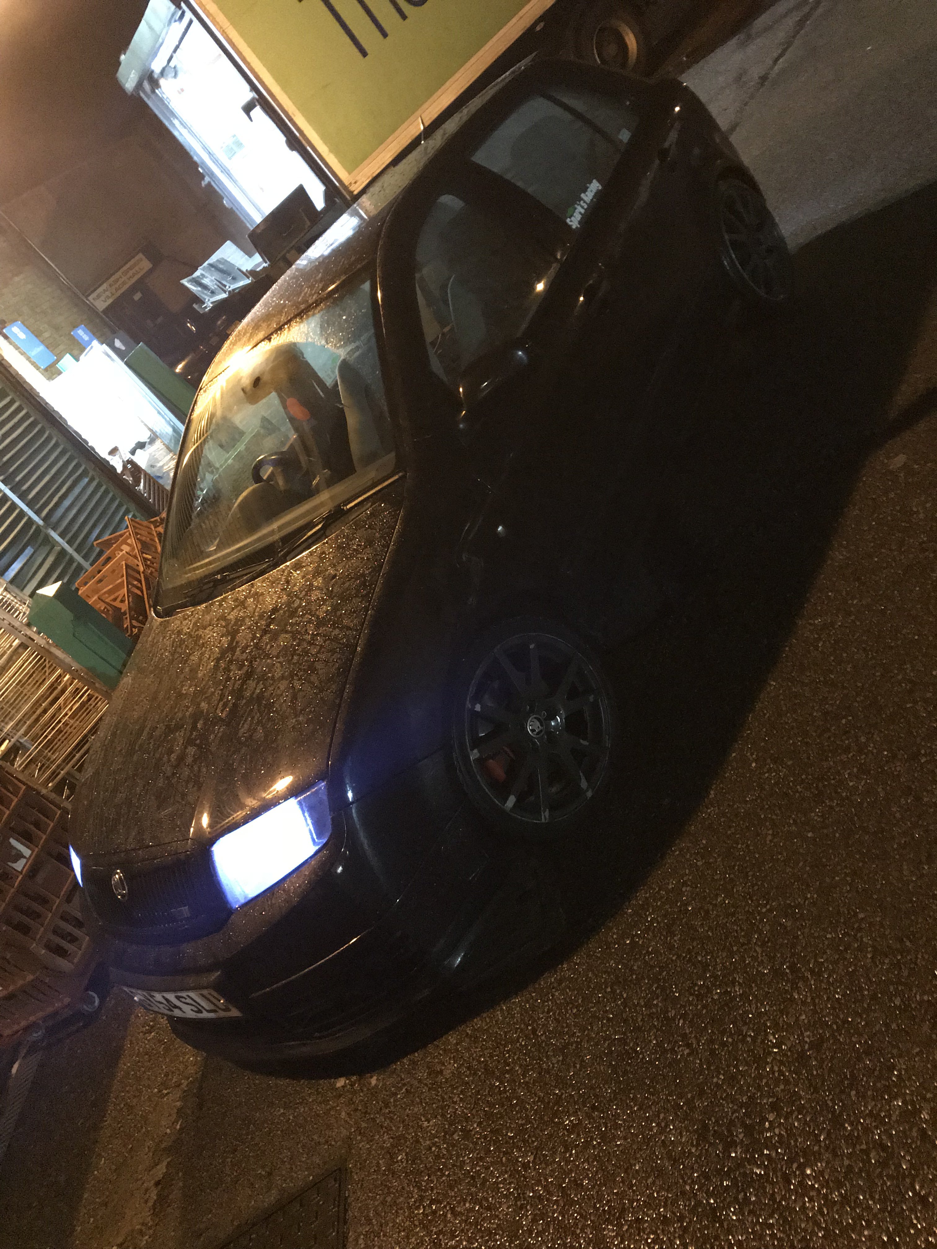

Awful picture as was dark when finished, the cars filthy it’s raining and my wheels are very much due a refurb which is coming. Coilovers are very comfy and feel standard which I’m so happy about!
Got the car cleaned and took a daytime photo, yes my wheels need refurbing so badly!!
