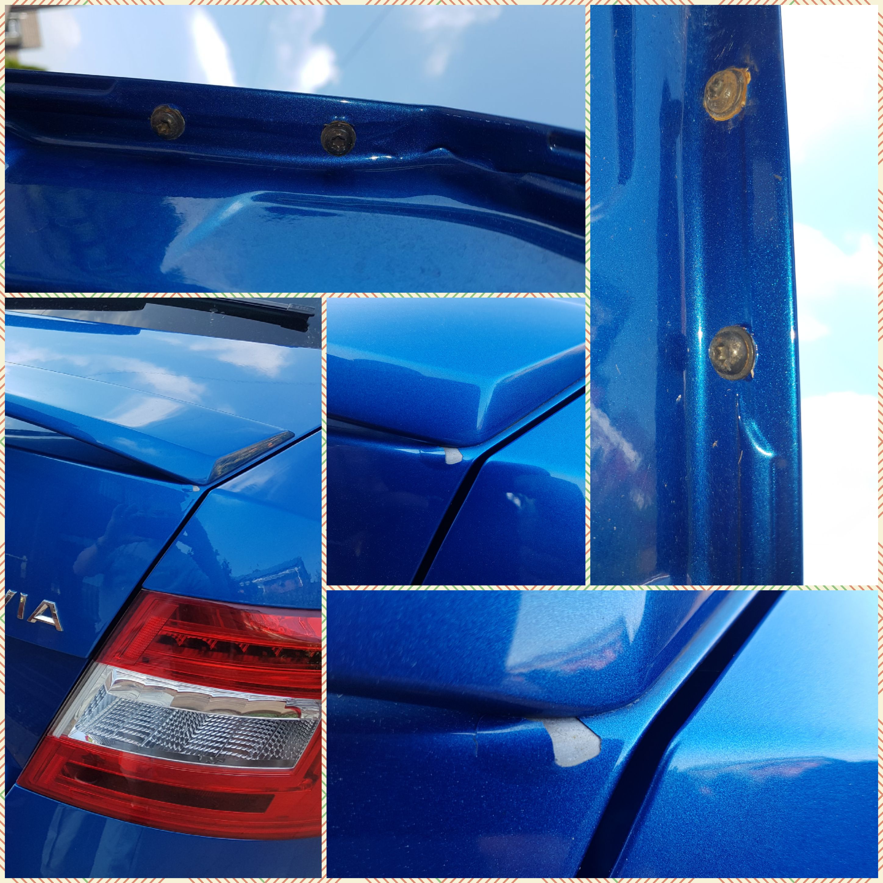

Hi I have just had some paint crack on my hatch next to spoiler and when looked closer the screws for holding spoiler are rusting and there is rust under the paint around screws .
I am trying to get someone to look at it.
This is what happened to mine.

Had a couple of similar cases at my work, ask them to check the inside of the boot (the area where the spoiler is attached), these cases of mine has had the corrosion quite bad on the inside of the boot, in these ive got Skoda to replace the complete boot also.

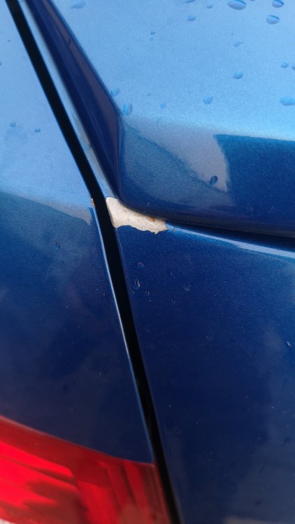

This could literally be a photo of mine. Now a 7 year old car Skoda have refused to fix it under the body warranty, according to skoda there are only 2 types of rust/paint defect covered and this fault isn't one of them.
I have found a body shop who say they think there is a 75% chance they can do a semi respray with whole panel lacquer cover using the contours to hide masking for 180 quid. Not really willing to pay 300-600 offered at alternative businesses. As long as its sealed and I don't get worms all is good. Thanks all for the advice on the washers, I will let them know so it doesn't happen again in a few years!
When he was inspecting the damage he gave the spoiler a little wobble and thinks the cause is down force fluctuations with the tiny bits of road grit under the spoiler slowly waring the paint away and letting water in. He said he was going to put a plastic sticker under there to ward the issue off.
