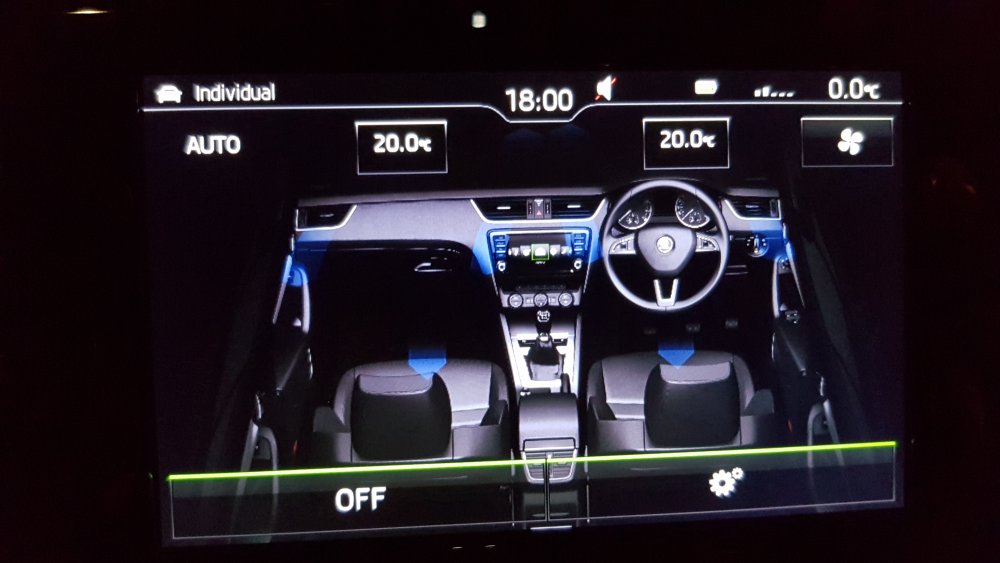

Just out of interest...I have only starting using Auto Climate control in my Mark 3 Octavia estate.
Seems to work well...
Current temp set set to 20C.
What do you set it too in the summer when its really hot ?
Ie if you set it to LO does it cool the car inside to a certain temp relevant to the outside one ?
Thanks.

You leave it at 20°C and it cools the car to that temperature. Lo just blasts cold air with no end in sight until you set a temperature.

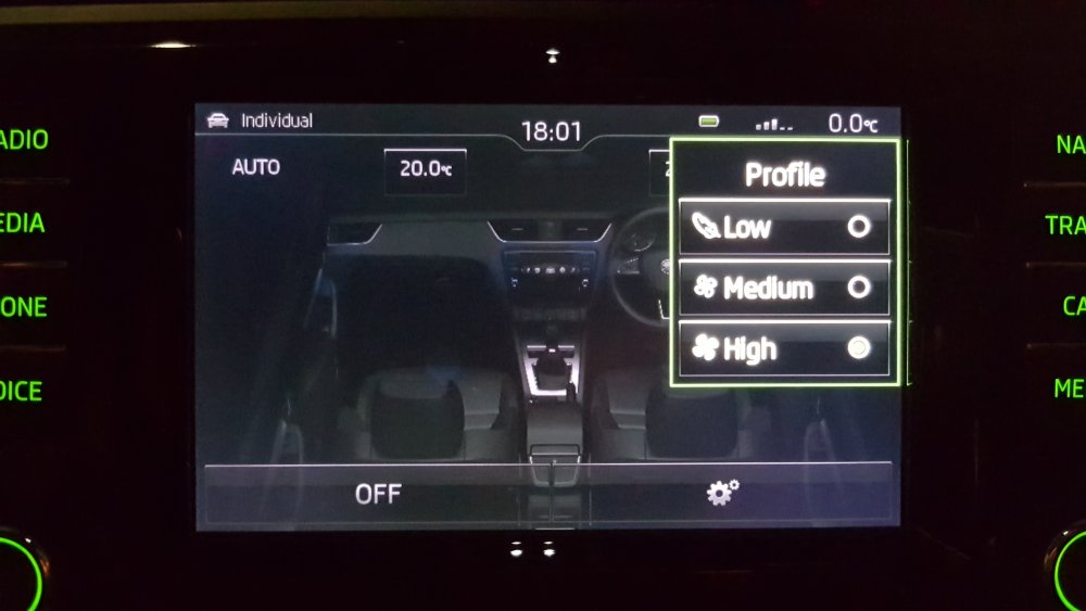

I lost my AC profile option  now fan symbol is missing (low, medium,high) after MIB 2.5 and VC upgrade. Any way to fix this.

Hi
Can anyone support to get the menu back in climate control menu.
