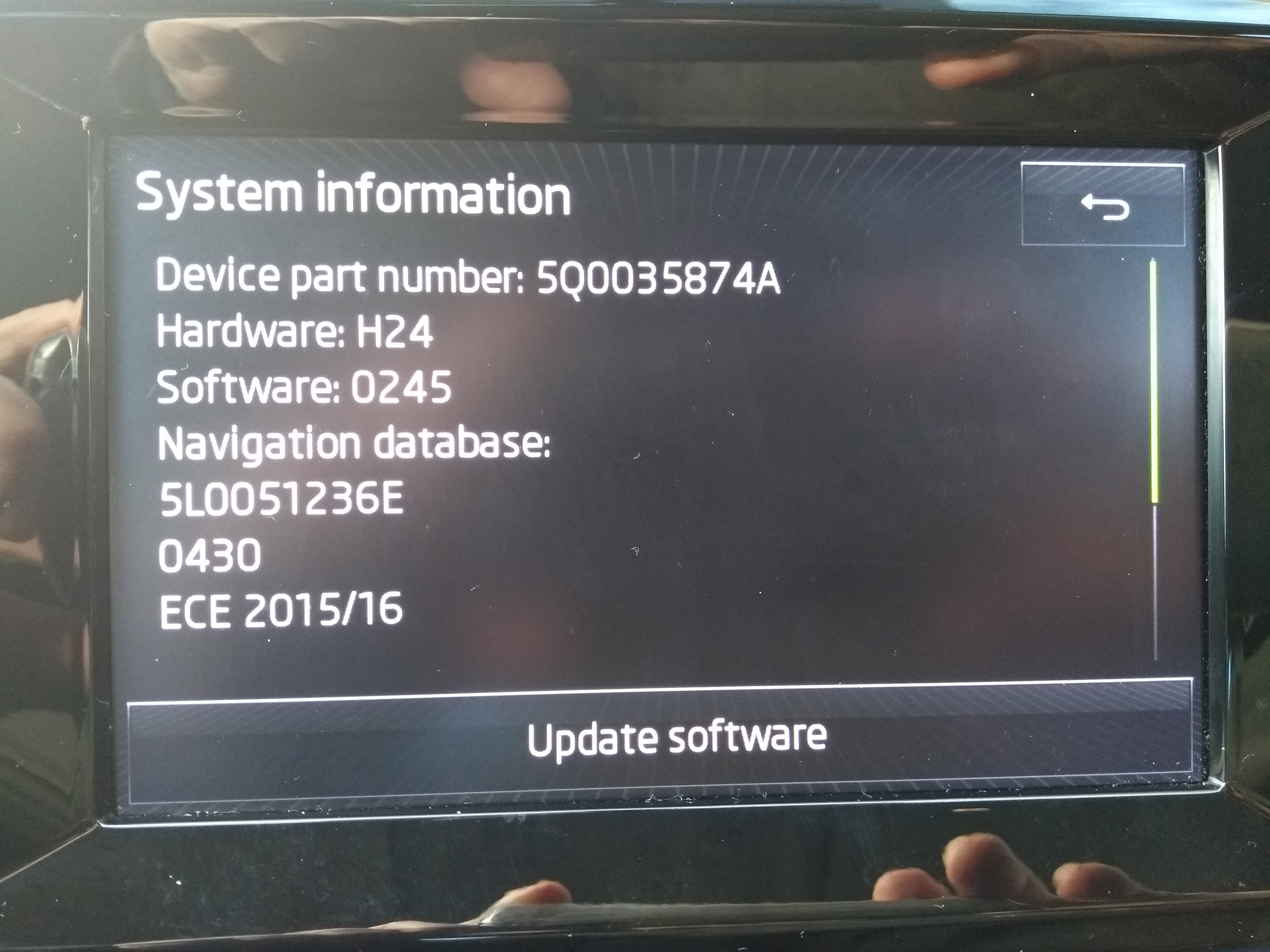

I've been assured that the car has been to the Skoda dealership and had the software updated.
I'm finalising the deal and picking the car up later today and will let you know.
Thanks.
The screen is working but the temperature is about 6°C. I'll check it when we are at freezing.
This is my system information screen after an update?
