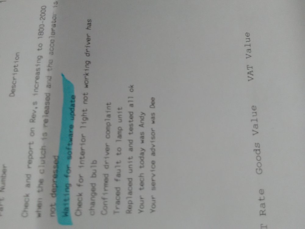

  • SFTWARE UPDATE DONE - FEEDBACK. Software update done and  its much better. To explain fully I will say how it was, how it is now, and how it affects pull away   BEFORE: Lift clutch

I know that this thread pretty old, but just found it. I have also started a similar thread more than a year ago on the same issue, which is still unresolved :
My car however has a smaller 1.2 TSI 81KW engine, but the autorevving issue is still the same.
I am aware of the other issue with the 1.5 TSI engine causing the kangarooing effect, but I am interested only on the autorevving problem. Can somebody tell, what engines are affected in the referenced TPI Bulletin 2049644/2 by @vegit8 ? I would like to go back to the dealership with this number, but just want to be sure that my car is listed.
