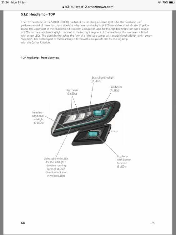

  • Found this in the manuals that silver 1011 posted in the guides section, and it clearly shows the 2 static LED’s that provide the “light bending “

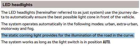

Both a 2017 Octavia and Kodiaq manual do not have an AFS section nor mention dynamic cornering lights. Instead they have an 'LED headlights' section and state:
Quote
The system operates automatically in the following modes: urban, extra-urban, motorway and fog.
The static corning light provides for the illumination of the road in the curve.
There is no dynamic cornering function on LED light systems, at least not for a MK3 FL Octavia or Kodiaq. I'm not aware of it existing on any current Skoda or VW model.
To put it plainly, the headlight doesn't swivel side to side because it physically can't ;)
