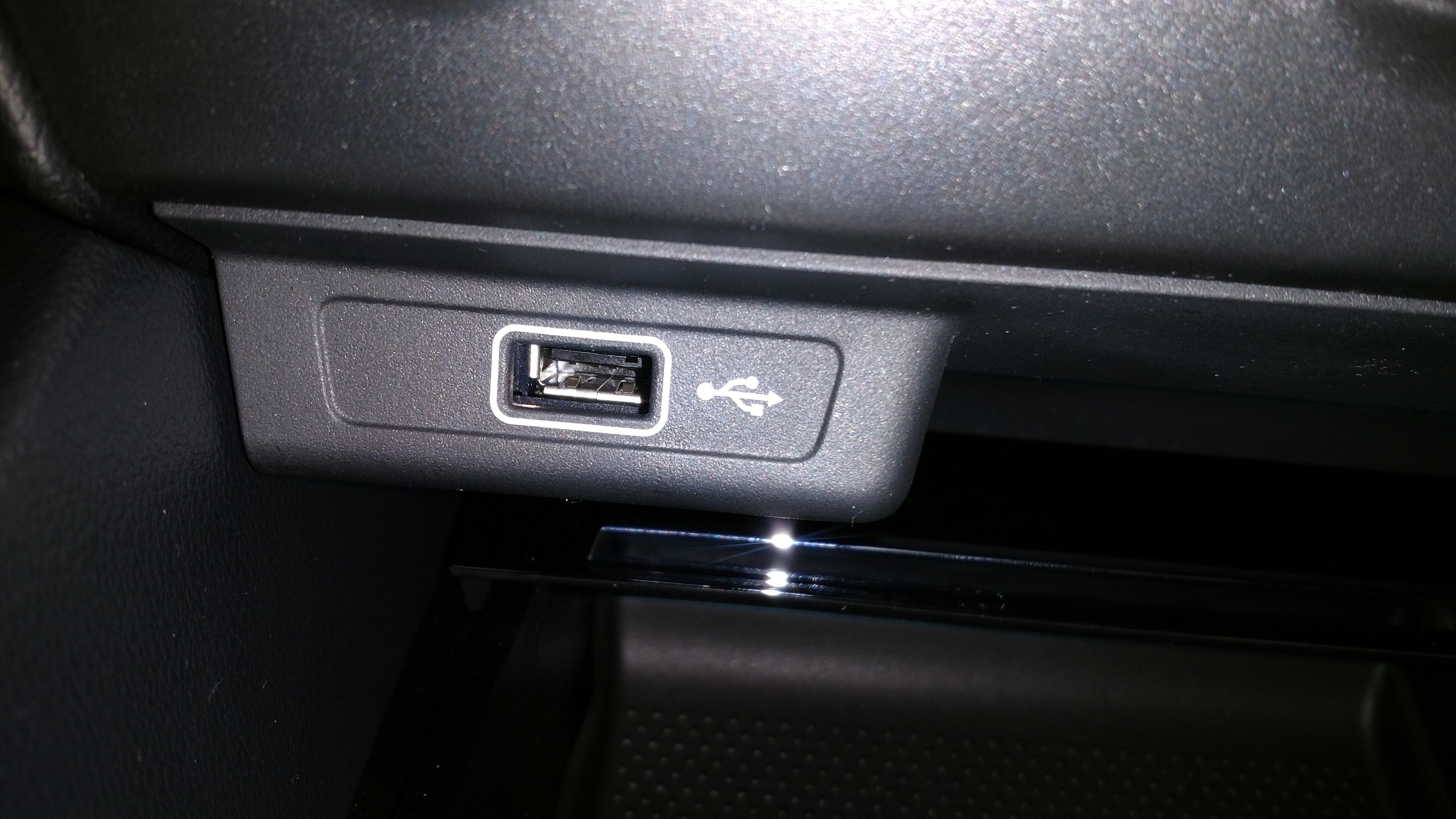

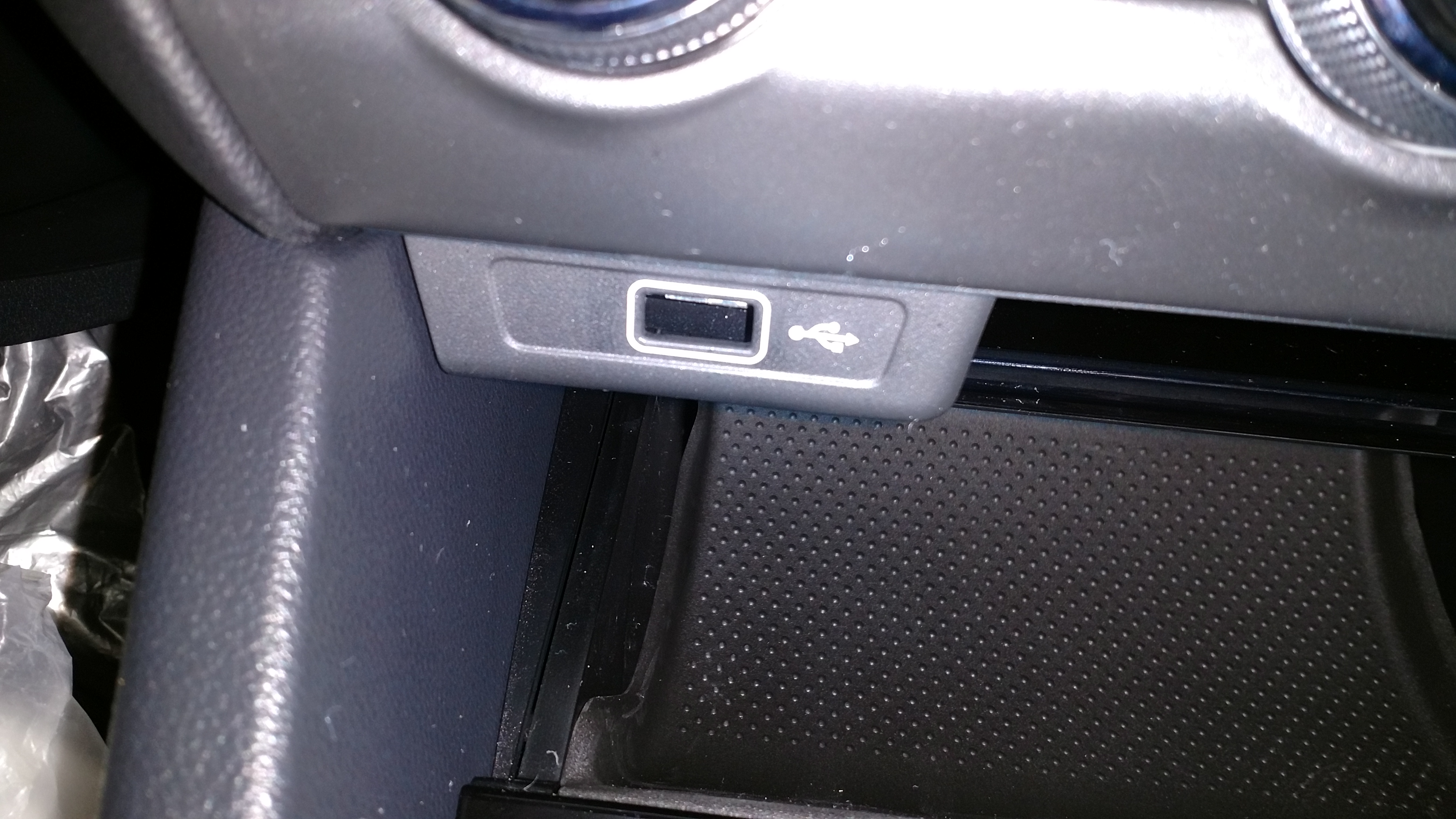

2018 Octavia. I'm trying to connect my phone to the USB port to use Android Auto. Should a normal USB cable fit in the port under the heater controls? I think the actual USB port insert is pushed too far back behind the housing...
Looks like this.
Doesn't look right, is there a better close up to see into the port?

Thought so. The port is pushed too far back in the housing isn't it?
Yes, definitely come unclipped. Take it to the dealer to get it put right.
As above, you have warranty so book it in for it to be sorted.
