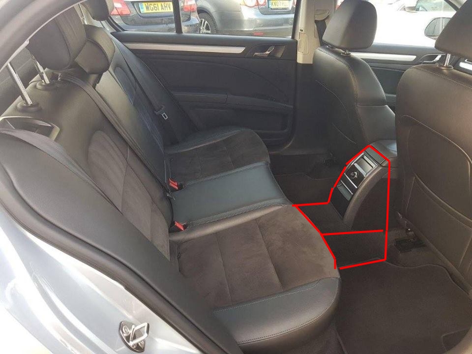

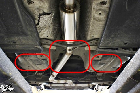

anyone had a look to see whats under the propshaft tunnel in a FWD Soopy?
The exhaust?

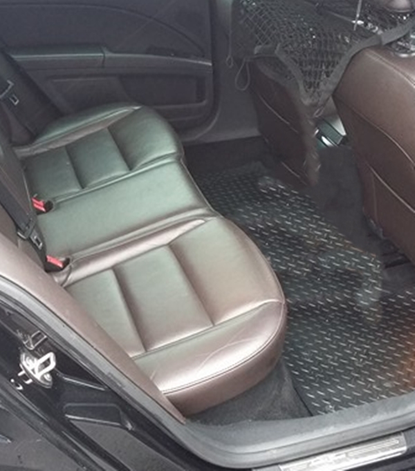

with no hump it would be like a limo in the back

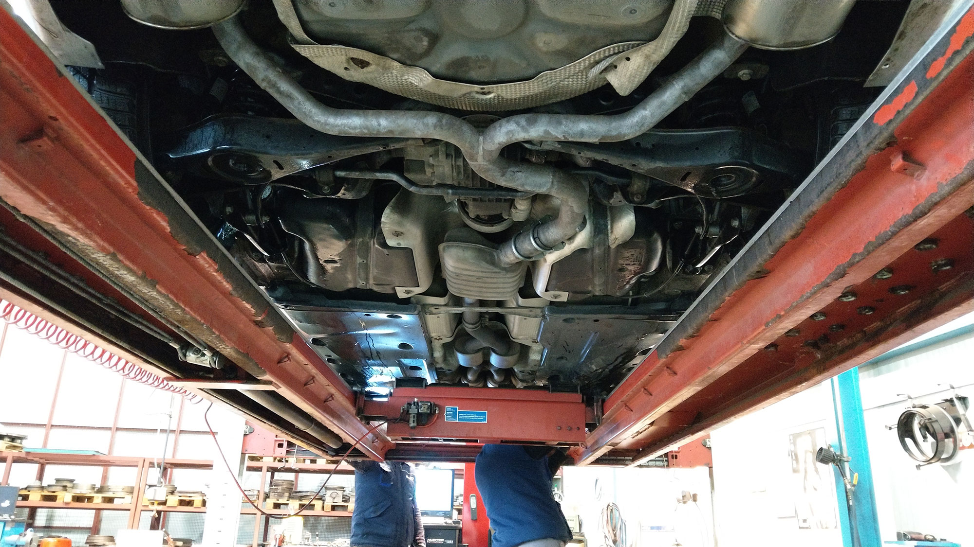

I had a look under mine during the MOT, couldn't believe how much space was unused under the FWD floor pan.
Isn't that space filled with the propshaft and haldex on 4x4?

Kind of, looks like this :D

and they only make 1 floorpan to suite FWD and 4WD versions

Yup - and they (VAG) used this floorplan across other marques in the VAG group as well.
I had an argument with an American buddy over this - he didn't believe his own Passat (!) or the Golf he rented here was FWD because that tunnel is there in the rear. "Whats the point of having FWD unless you get the flatter floor and legroom in the back?!" was his thinking....

not mine, just only soopy underside i could find

Apart from making room for bits that have to run the length of the car, that hump also contributes a lot to the car's structural strength. Taking it out could be quite problematic and something you would need a detailed engineering report on if you want to have any hope of insuring it afterwards.

Yes of course it is, I was just making the point that us poor 2WD folk lose a lot of otherwise useful space just to keep 4x4 folk happy.
In terms of the tunnel though I think this is at least partially deliberate to impart stiffness to,the floor
a 1/4" plate x-member would replace the hump, directly underneath the humps location from 1 side to the other of the car, probably ending up stronger than the original
The plate might make up for some of the loss of torsional rigidity but it's not going to do anything to stop the floorpan sagging in the middle over time.

Ive had no complaints but its bloody irritating its there

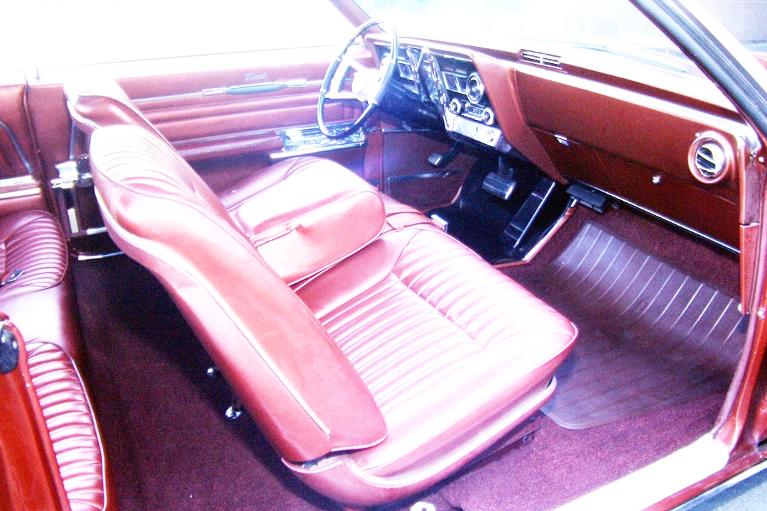

the Yanks built a FWD car (Toronado) --- V8 --- and didnt see the need for a transmission hump

Right, but they designed it from the start not to have one. Skoda haven't designed the Superb not to have one, so removing it will have serious implications for chassis stiffness.
I also suspect that the Tornado may not have been very stiff.
