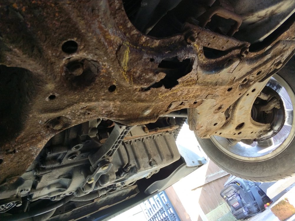

During some maintenance I was shocked to see it has a terrible problem with corrosion on the front subframe though, I'll attach a picture below. I bought it sold as seen and stupidly didn't give it as close a look over as I should have.

Yes they are the same.

Thanks for the reply. Thats good to know, should be plenty of good ones around.

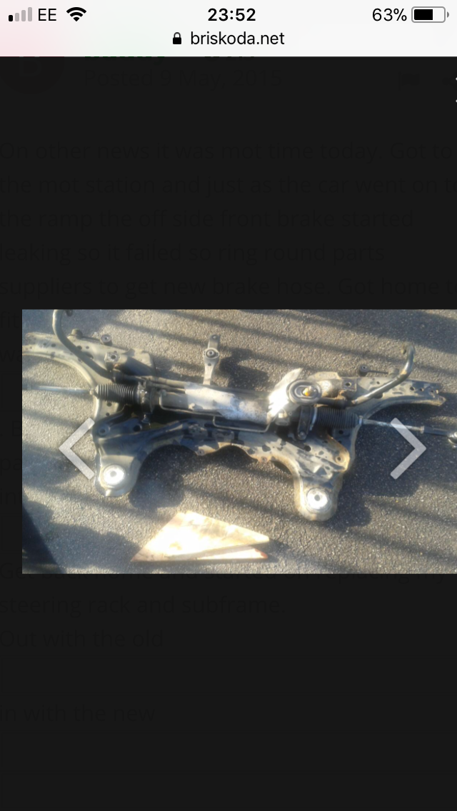

A pic from when I done mine
