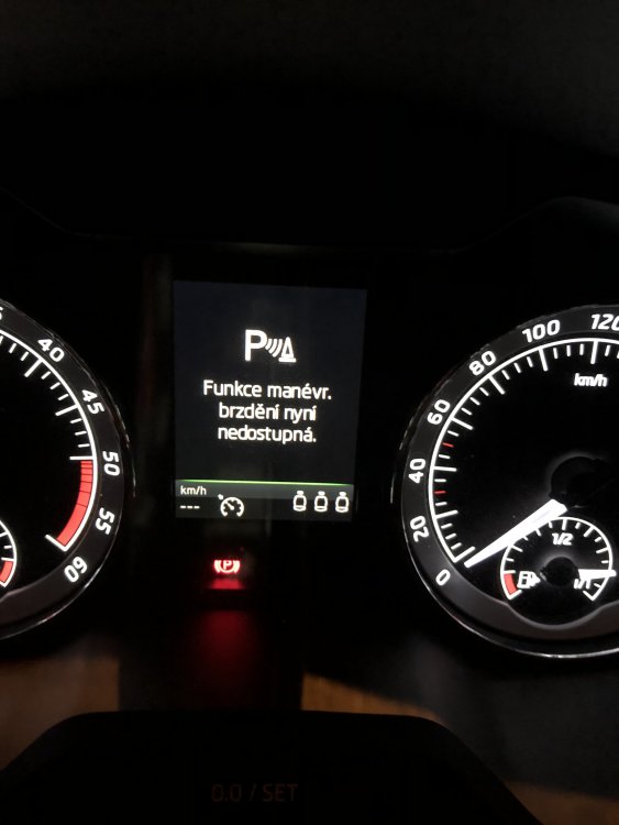

I am the owner of a new OIII after FL and every time I start, show report on my maxidot - the maneuvering braking function is now unavailable.
I've tried everything and VAG does not show any error.
Some advice or experiences?
Photo from my maxidot see below.
Thank you very much for your viewing and possible advice!

Helo. I have the same issue. Did you fix yours?
Yes. They gave me a new EFB accumulator.
You must turn off start/stop and intelligent recharging through VCP or VCDS. Or you can disconnect the connector at the minus pole of the battery.
