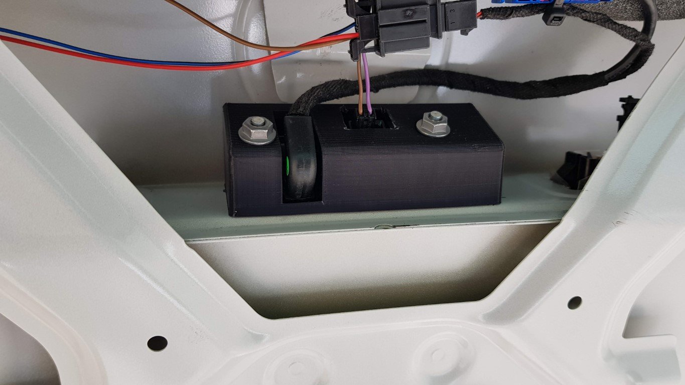

For anyone who wants to try this, I designed a 3D printed bracket to hold the camera/handle in place so it doesn't only rely on friction: Thingiverse link. Hope it can help someone!
