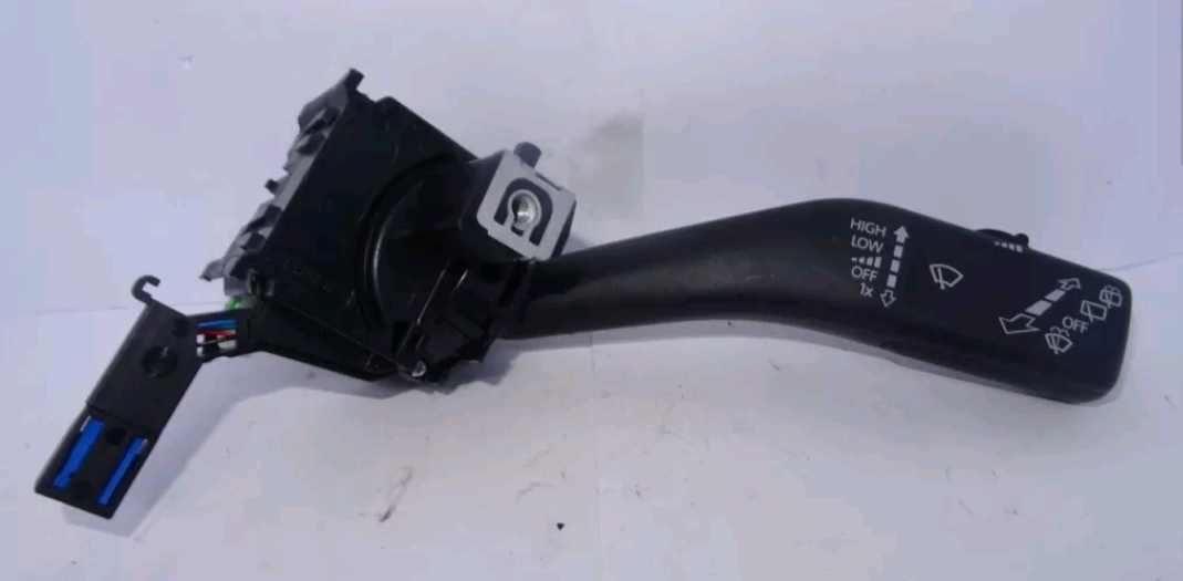

The right stalk can be exchanged for a flat one without trip buttons from a 'dumb' set. It's just three small screws and a little manual dexterity. Their switching and mechanical elements are the same.
Yeah but it depends on the type of steering setup you have...

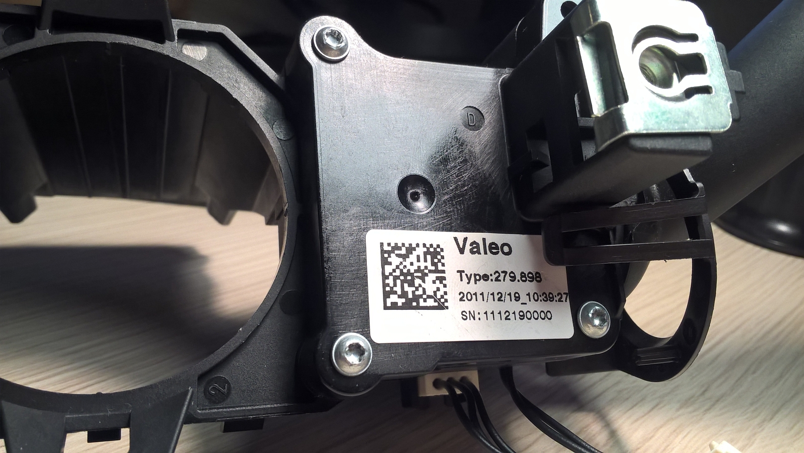

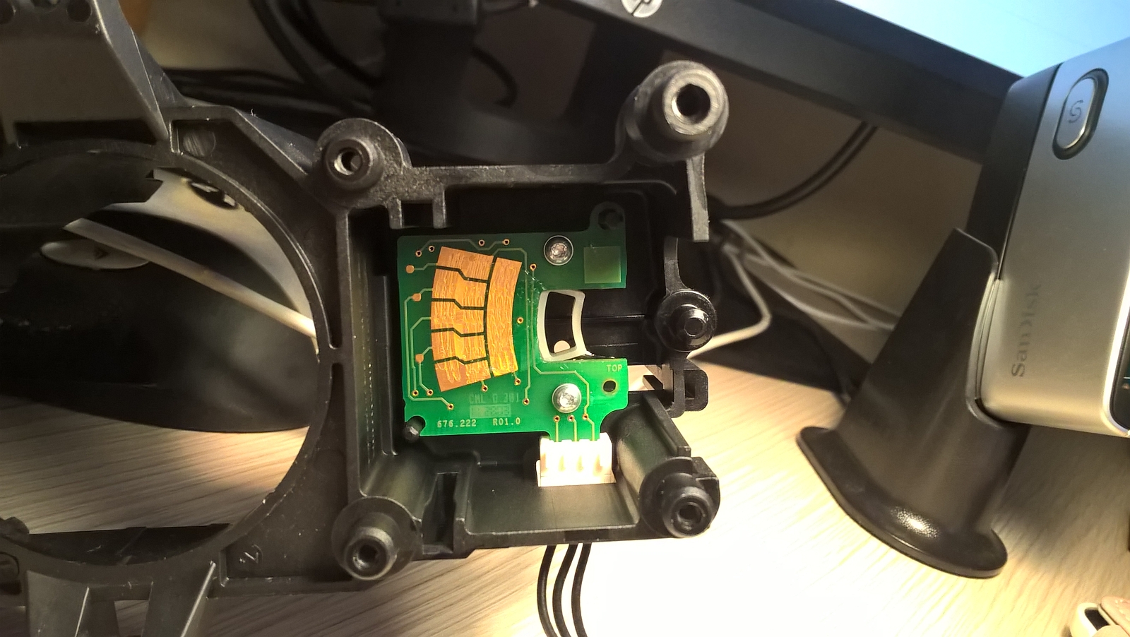

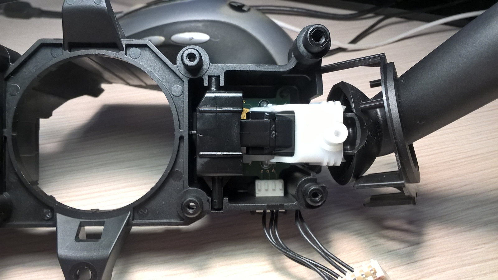

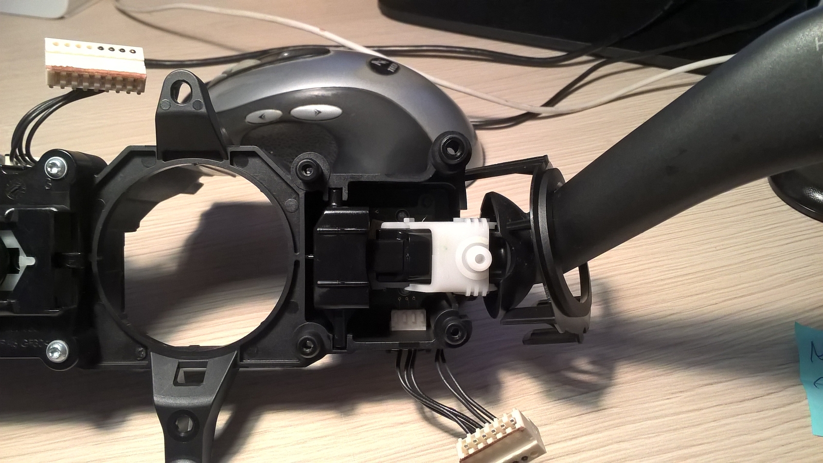

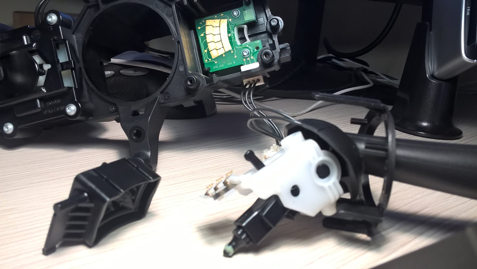

The new type unofficially also has a replaceable arm. Unclip the thin ring, remove cover (3 x Torx 9), pull out the arm with the black counter part, and disconnect and replace the black cable. And just assembly with the new arm and wiring. The middle part and PCB panel, etc.  are the same for each type/config.
This is my old set, I quickly disassembled :
WP_20180309_15_58_36_Pro.thumb.jpg.b595b24700fcf9b066cbc7ac7daf7208.jpgWP_20180309_15_55_56_Pro.thumb.jpg.6ac2eaead09ecd414dc8e0d2cbde6bb2.jpgWP_20180309_15_56_04_Pro.thumb.jpg.0310b17d56f7a28c8b7035cae15c02b5.jpgWP_20180309_15_55_13_Pro.thumb.jpg.58e53a181c73c1695d8581012b159969.jpgWP_20180309_15_55_02_Pro.thumb.jpg.24aa603aaf885ccadb685e4e2edad776.jpg
