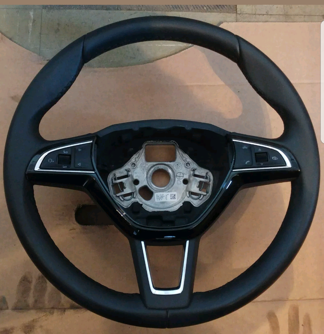

I have a MK2 octavia vrs with no mfsw and I feel like I am missing out.
I've read quite a few steering wheel threads but some of them are very old.
Can get a Skoda superb v3 steering wheel for £100 which seems like a bargain. Are all the airbags the same? Mk2 through to mk3?
Anybody got details of extra part numbers of connectors etc i will need? Why do some steering buttons work and not others?

MK3 style wheels
The MK3 Superb/Octavia buttons will not work with a FL MK2 Octavia. This is because the FL MK2 Octavia is based on the PQ35 and the MK3 Superb/Octavia is based on the newer MQB platform.
If you want a MK3 style wheel, you need to use buttons designed for a PQ35 based car, namely a FL MK2 Superb or FL Yeti.
The MK3 wheels use different airbags to either the pre-FL or FL MK2 Octavia, so you would need a new airbag too.

So I can get a MK2 FL yeti MK3 style steering wheel which I think is up to 2013 year.
Any wheel from 2014 onwards is a no go?
Or any mk3 wheel and swap the buttons over.

There is no MK2 Yeti ;) All Yeti's are PQ35 based so there is maximum year limitation on them - ignoring the illumination issue I mentioned.
As for the Superb wheel, as long as it's correctly listed and from a MK2 FL it should be fine. Production stopped in 2014/2015 so ideally ask the seller to confirm the part numbers before purchasing as MK2 FL and MK3 wheels look identical. The MFSW buttons come off pretty easily to check.
So the safest option is an early yeti wheel to get the green buttons that work with either controller. All very confusing. Do appreciate the support.

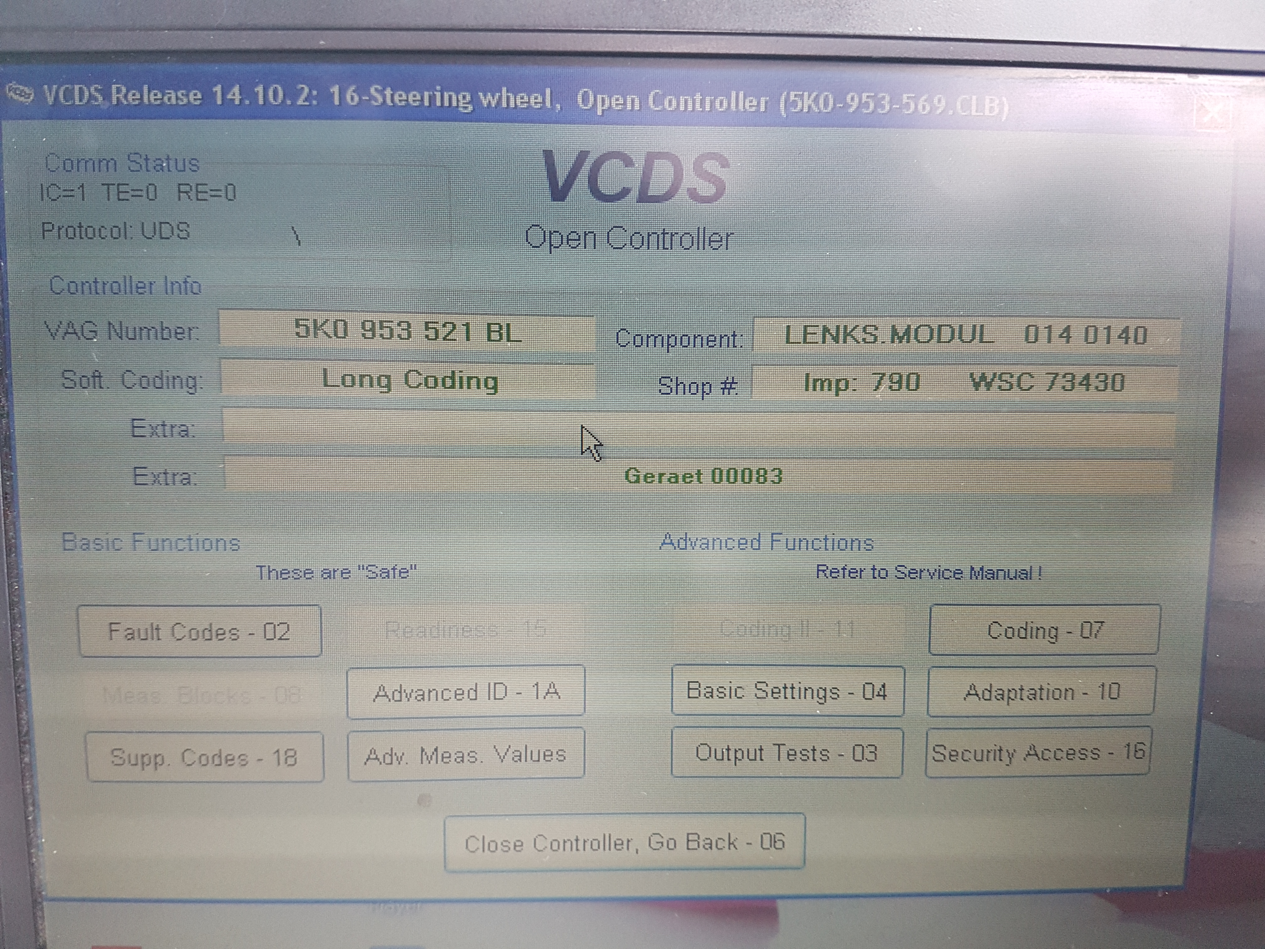

Now I'm trying to work out the steering controller. 1K0953549CH seems to be the one most people recommend.
But i dont known if it can replace what I currently have in the screenshot. 5K0953521BL or is that something else?

Yeah I perused the Ross tech site but my part number is not there.
Isn't your part number 5K0953569 as stated at the top of the screen? Do a scan in VCDS and it will give you the exact part number rather than going into the module itself.
Only me again. Did as you said dilksie and this is what i got. Guessing the module control code is 5K0 953 569 C which is a midline according to Ross Tech.
Therefore i think i am right in assuming i need 5K0 953 569 H
Edited by Jrhoop
Quoting Eddie-NL from the other post:
Quote
you have one ending 569 so as long as you buy one ending 569 it will be ok
Only thing is not to buy one from a passat as that doesn't have an ignition switch
569E
569H
569L
569AL
are ok for the Octavia 2 FL
So yes a H will work, so will an E, L or AL
