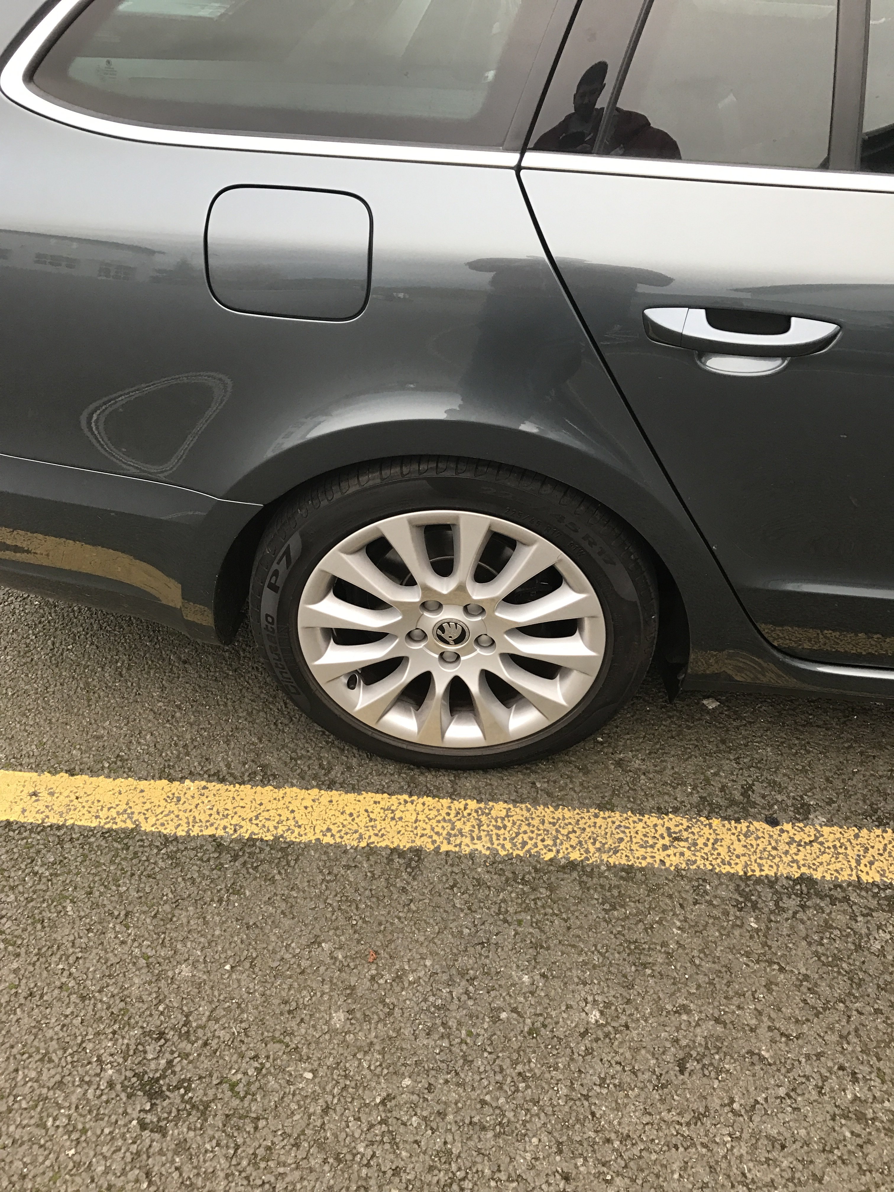

Any photos ?
8 hours ago, Sevlow8 said:
Any photos ?
This is the only photo I have, you might have to zoom in. Calipers have been painted black also
