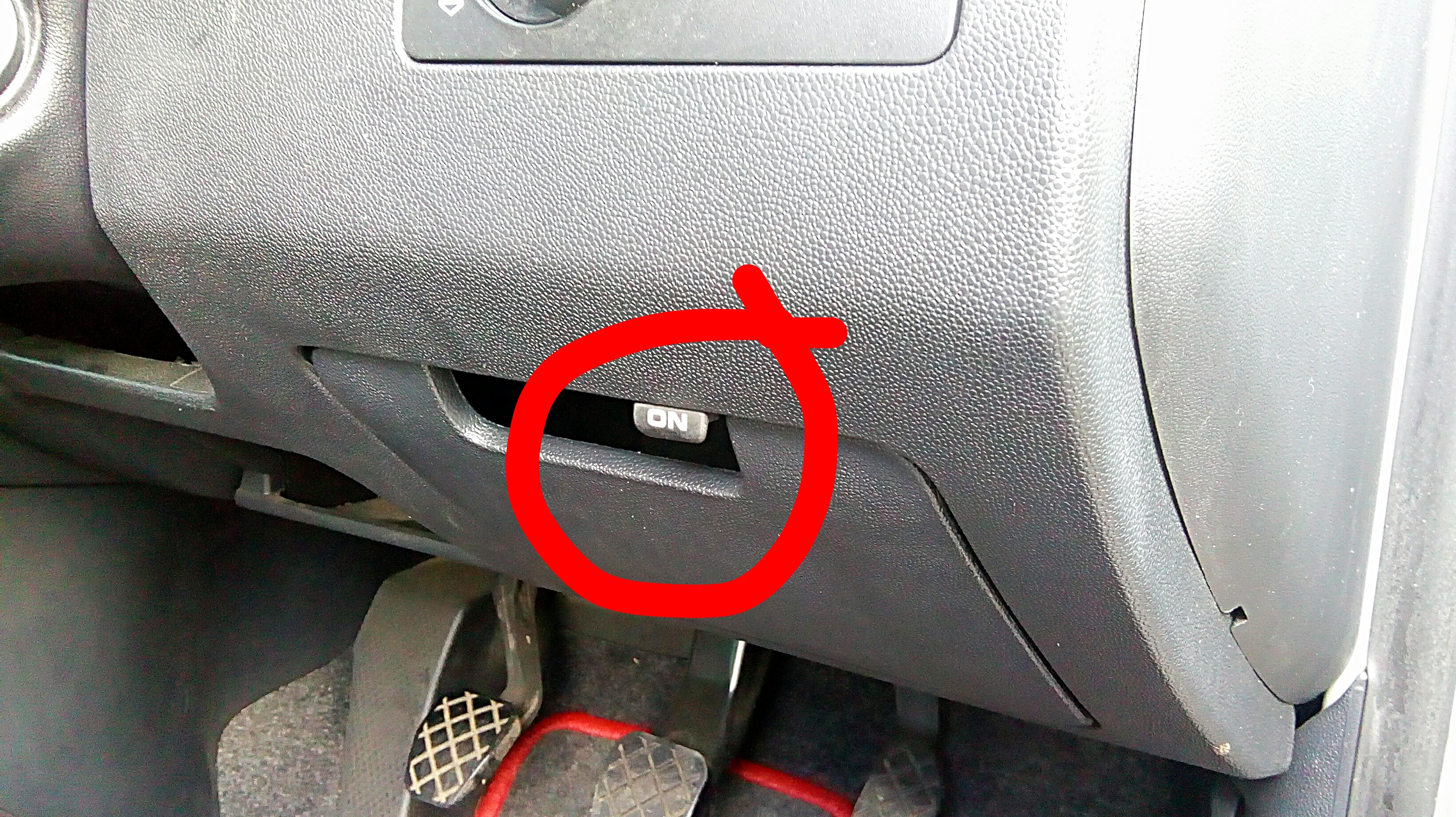

I just found this button, it's not in the owners manual. Is it an engine shut off switch? It was in the off position.
No, that's a chiller for your beer when the aircons running.
Seriously, check the fuses, they are in the owner's manual.
No, thats the choke lever
It was the ignition fuse. Up and running again now. Thanks for the assistance.

Fuse 52 then. Good news, thanks for letting us know the outcome.
